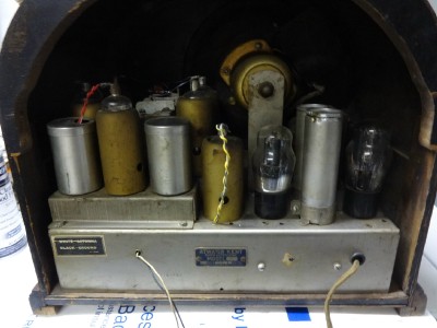

There was some sort of rubber sleeve that was on the tuning shaft, that transfered rotation to the tuning cap's gear, which dried and crumbled.
Will need to find a replacement, whether a makeshift solution, a rubber tube piece, or maybe the reproduction is made by someone.
Then the shadograph. Not sure if it is working or not, need to adjust light first. Maybe it does.
One thing about AK, after you dust it, it is like it has just come off the assemly line.
The speaker looks like new.

(12-07-2014, 11:33 AM)morzh Wrote:  ....There was some sort of rubber sleeve that was on the tuning shaft, that transfered rotation to the tuning cap's gear, which dried and crumbled.
Will need to find a replacement, whether a makeshift solution, a rubber tube piece, or maybe the reproduction is made by someone......
Adams Manufacturing has something listed under under their Specialty Products for A.K. tuner repairs:
http://www.adamsradio.com/
On an A.K. 92 cathedral that I have I found some thick fuel line hose I had that was the right size and used a piece of it.  If that is what you're looking for, then a trip to the local hardware or auto parts store ought to fix you up with a short piece of rubber hose with the right inside/outside diameter.
#49
John
Thanks, yes both are viable options.
I have dealt with Adams on more than one occasion, and I like them. Prices reasonable, shipping cheap or free, product as advertised, delivered fast. What else could one wish or.
PS. Just went there, yes the part #329 looks the same. Though 808 model is not listed, from the photo I think it should fit.
I will write him first.

Another piece of good news, the shadograph works. It does have a resistor in parallel inside it, but 1K kinda gave me hope the coil was intact.
I had to swap the lights places, the dial one was very bright whereas the shaograph was on the dim side, so after that the shadograph became really crisp, just had to adjust the lamp hoder position.
The sensitivity is so far so-so which might be due to antenna absense, or Avc Voltage not developed proprely, will look at it.
I also thought of magnet being weak but then in the beginning it forms very thin line, and then goes almost full width, after which it settles in the middle and does react to tuning but not as much as I'd like, this is why I think the magnet is fine.
My bet is on antenna as the 2nd detector (I have yet to see where it goes to the meter but has to be it) tube is very strong.

Your coming along well on that Mike. Looking good!
I bought a 708 last week that I believe has the same chassis. After reading your posts I think I know what I'm in for Icon_eh
The 708 is playing. It had been recapped and has replacement wiring but it only picks up a couple stations on the broadcast band. Hopefully just an alignment or tubes.

Thanks Mike. I had tested it with a 6' piece of wire. I attached a much longer antenna and the other bands get activity. AM is still weak though. I will have to do some rewiring as the guy who last worked on it used the wrong wire for some of the chassis, and for all the grid wires. Looks like he ran out of cloth wire about 3/4 the way through. Very odd. Wish he had replaced the grid wires in cloth and left his handy work under the chassis.
They really stuffed this chassis in the cabinet and it weighs quite a bit. AK sure makes a quality radio.
