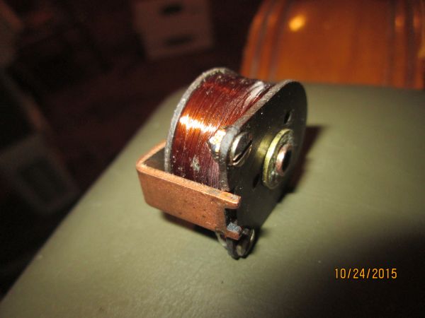

Hi Terry! You probably know this, but assuming your shadow meter is physically sound it is definitely possible to rewind shadow meter coils - I recently did that for a 660X. The #40 wire is a pain to work with but not impossible. The tricky bit is soldering that really fine wire to a large wire and securing it mechanically.

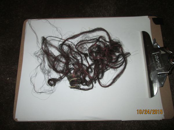

So you used 40ga wire, How many ohms did you end up with at the end?? Rewound it and my wrist is killing me!!!!!!! Surprisingly easy just takes a good pair of glasses and concentration.
#49
Now who woulda thought that this much wire wound fit on that little spool??

Mine came out to ~1000 ohms.
Wow - you wound it by hand?! Icon_eek
Now that's dedication!
I used a drill connected to a variac to keep the speed low. I mounted the bobbin on a bolt to attach it to the drill and then let it feed off of the spool of 40ga. I still had to guide the wire by hand to keep the winding even.
Yours came out nice - and has extra value since it is hand-made. Icon_smile

Mine ended up at 1562 ohms. Need to make a spacer to lift the coil up just a little hair so I can insulate the wire loop terminals.
Found a sm with a good coil but was low in resistance abt 900 ohms. Tried it and couldn't get much movement only about 1/8". Check current and swung from 10ma weak signal to 4.5ma strong signal. Maybe it has some shorted turns. Has the long skinny coil so I'm thinking it would be a little more tricky to wind, has a flat core/ bobbin.

I think the difference in resistance might be because I left a bit more space on the spool - my thinking was that the original had some space filled with tape layers.
I fastened the large wires in a similar fashion - and also had to insulate from the metal case of the shadowmeter.

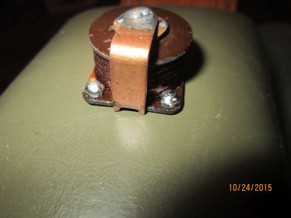

#53
After trying to reassemble it I found two things: vane was stiff (wasn't before) and my twisty wire terminals didn't work so well (coil wire from the inside broke). So had to do some rethinking. Found some 2-56 screw/nuts from an old Command transmitter. These fit very nicely in the holes in the sm, add a little solder and now I have stationary terminals.
Adjusted the pivot tension on the vane and it seems ok. Vane has some white corrosion on it but I don't think I can get in cleaned up w/out breaking it.

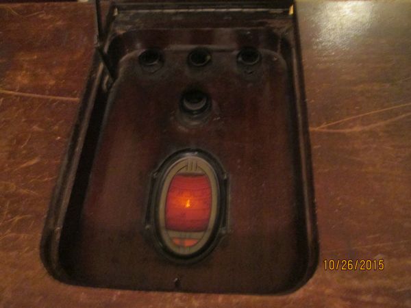

I guess I should quit being annoyance on the phorum and get back to the 660. Got the sm back together and working. Had to modify the coil coil cover a little to accommodate new terminals. After doing some minor repairs it was ready to go back into the cabinet.
SO unless your Atlas the cabinet has to be placed on the floor w/ the outside back facing the floor. Trying to lift and hold the chassis vertically while installing the long mounting screws in difficult. Got it in and bolted up and the same w/the spkr. Plays swell!!!! Sounds good.
Only one problem can't see the sm. You see there two sets of screw holes that would accommodate sm, guess which ones I picked  [Image: http://philcoradio.com/phorum/images/smi...edface.gif]   Not sure if I can get in there without removing the spkr and chassis, but I think I know the answer  [Image: http://philcoradio.com/phorum/images/smi...on_mad.gif]

I pull it back out to figure out why the sm was misaligned to find that the mounting bracket was bent in such a fashion that it was aimed way above in dial escutcheon. Also lubed the door hinge assembly. The door is slightly out of kilter which in to makes it difficult to open. The screws in the hinge are countersunk so I can't really manipulate the door position so I ended up sanding it just a little. Now the clearance is pretty good but I think the spring that flips it open over the yrs has lost a little tension. There is an adjustment for it but it in a tough place to get to.
