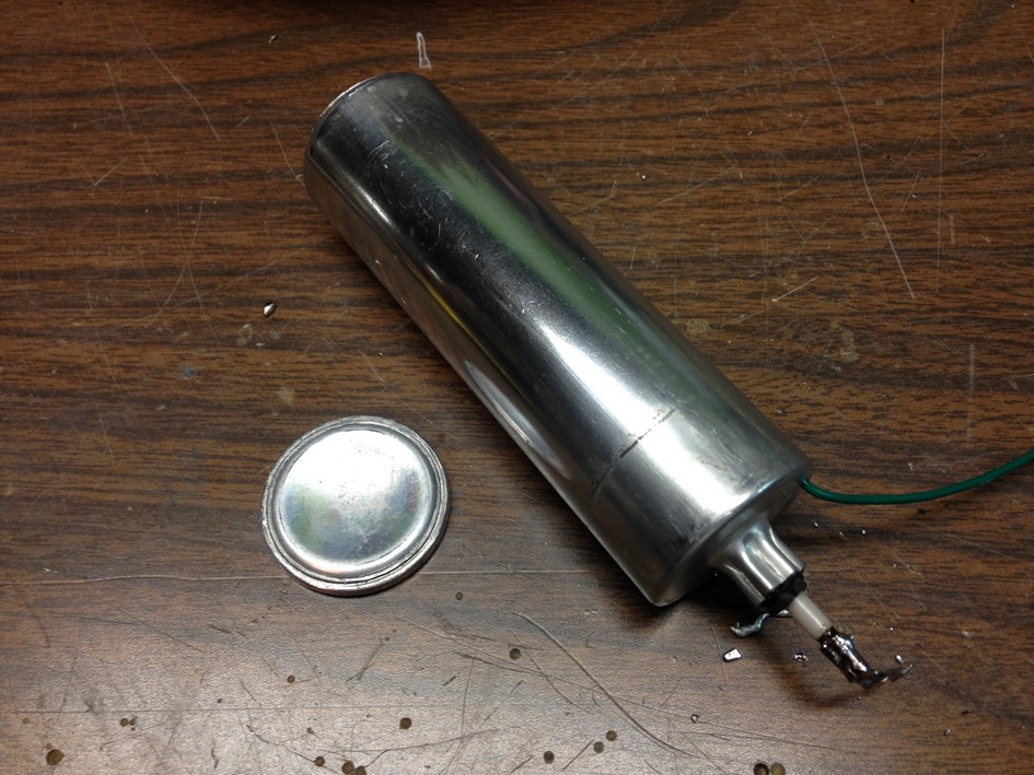

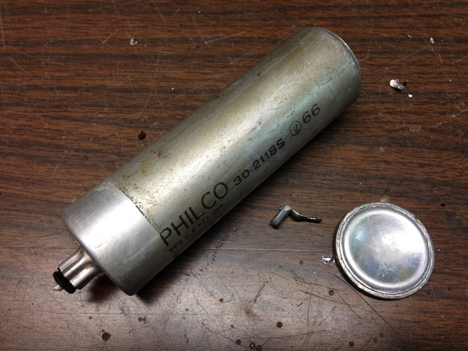

Now - for Mike, and anyone else interested - a more comprehensive look at restuffing an aluminum electrolytic can.
I had already decided that I would open this one up at the top, where the seam is.
Having the boric acid solution still in the can was going to complicate things.
I had read where some collectors have used a utility knife to open these cans up. Prior to tonight, I've always used a Dremel tool and cutting wheel.
Tonight, I decided to try the utility knife. Trying to keep the can vertical, I began to slowly cut with the knife using my right hand to hold the knife, while rotating the can in my left hand.
It only took three revolutions of the can before the top popped off and a little electrolyte spilled onto the floor.
I disposed of the remaining electrolyte, then rinsed the now-open can out several times with hot water.

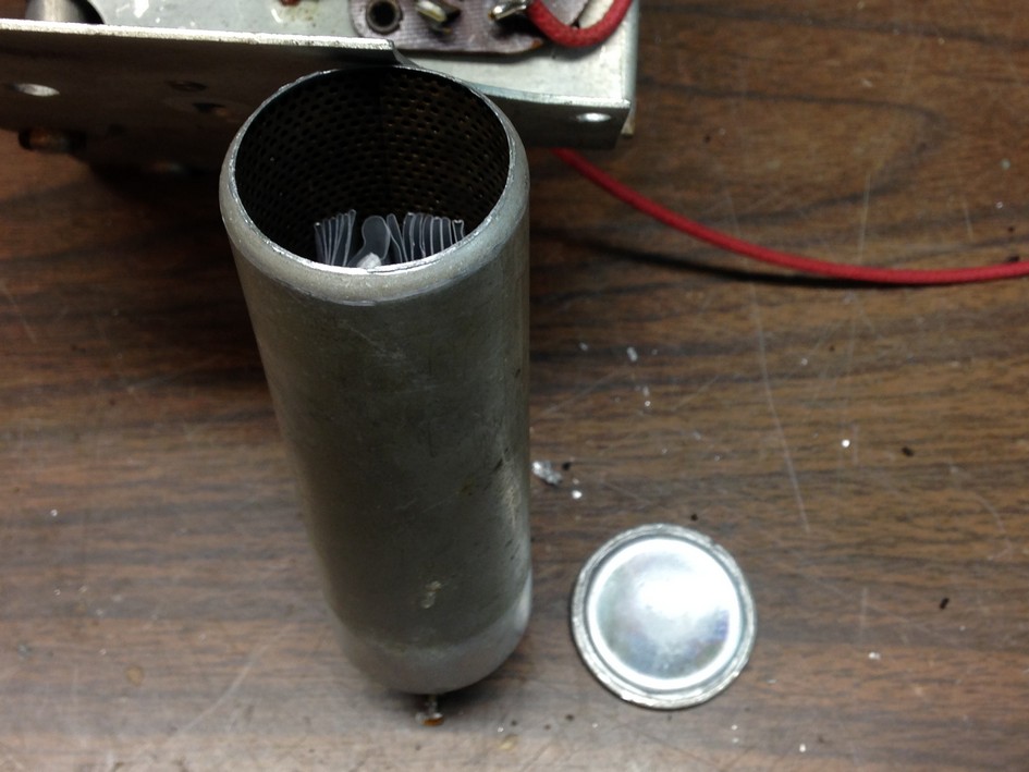

It then looked like this:

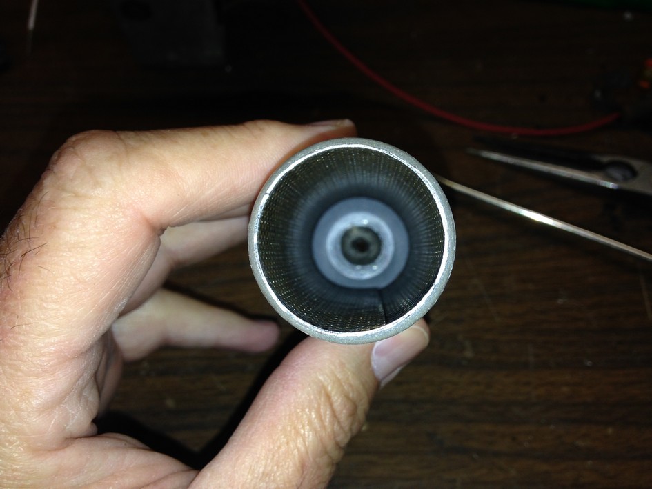

[Image: http://www.philcoradio.com/images/phorum/37640_052.jpg]
You can see the positive electrode inside the can.

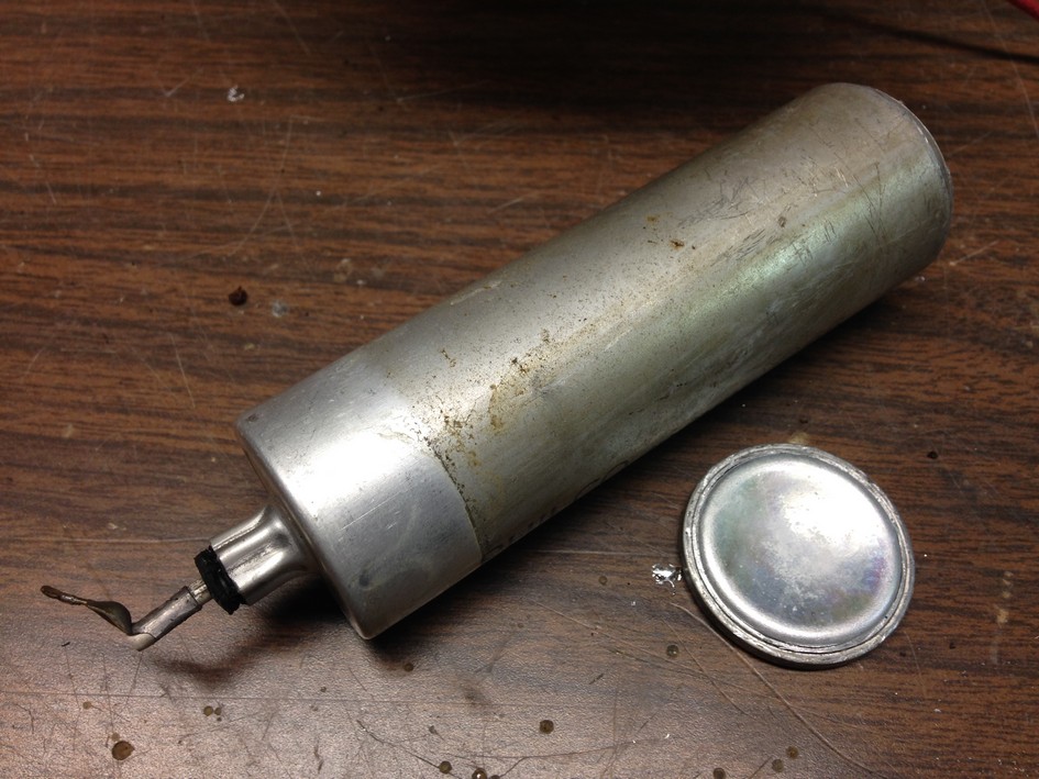

Let's look at the bottom of the can:
[Image: http://www.philcoradio.com/images/phorum/37640_053.jpg]

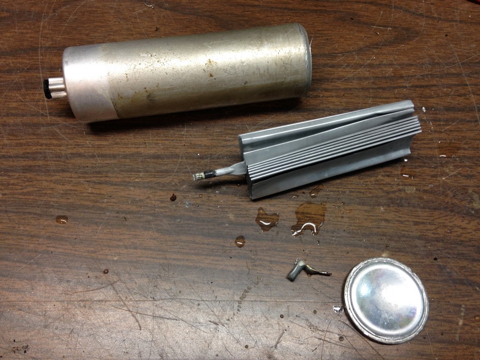

I will be cutting the aluminum rod just below the solder terminal, for two reasons: One, to preserve and reuse the terminal; and two, to make it easy to remove the positive electrode.
[Image: http://www.philcoradio.com/images/phorum/37640_054.jpg]
Above, you can see that I have cut off the solder terminal.
Now, using a pair of long needle-nose pliers, I reached into the can from the top, grabbed the positive electrode, and pulled it out.
[Image: http://www.philcoradio.com/images/phorum/37640_055.jpg]
I disposed of the positive electrode and, after sticking a paper towel inside and wiping it around with the aid of a long screwdriver to remove any remaining moisture, the inside of the can looked like this:
[Image: http://www.philcoradio.com/images/phorum/37640_056.jpg]

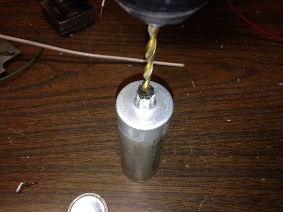

My next move was to slightly enlarge the hole in the rubber plug with a drill. (I also leave the rubber plug in place.)
[Image: http://www.philcoradio.com/images/phorum/37640_057.jpg]

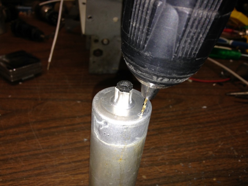

I also drill a smaller hole in the bottom of the can, near the edge, for the negative lead.
[Image: http://www.philcoradio.com/images/phorum/37640_058.jpg]

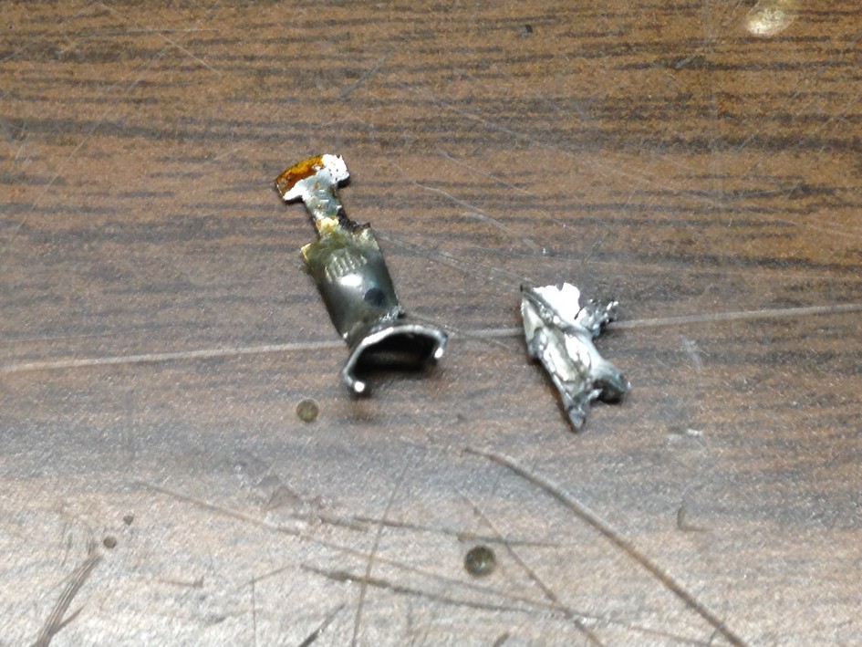

Now, before we forget, let's return to that solder terminal.
[Image: http://www.philcoradio.com/images/phorum/37640_060.jpg]

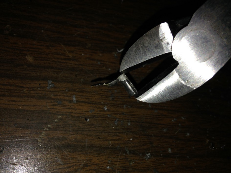

It's hard to describe in words, but I use a pair of diagonal cutter to carefully uncrimp the terminal from the remaining piece of aluminum rod. This has to be done very carefully, lest you ruin the solder terminal.
[Image: http://www.philcoradio.com/images/phorum/37640_061.jpg]
Now, the solder terminal is free from the old aluminum rod and may be reused with the new copper wire.

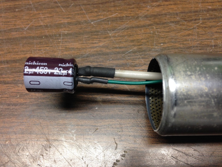

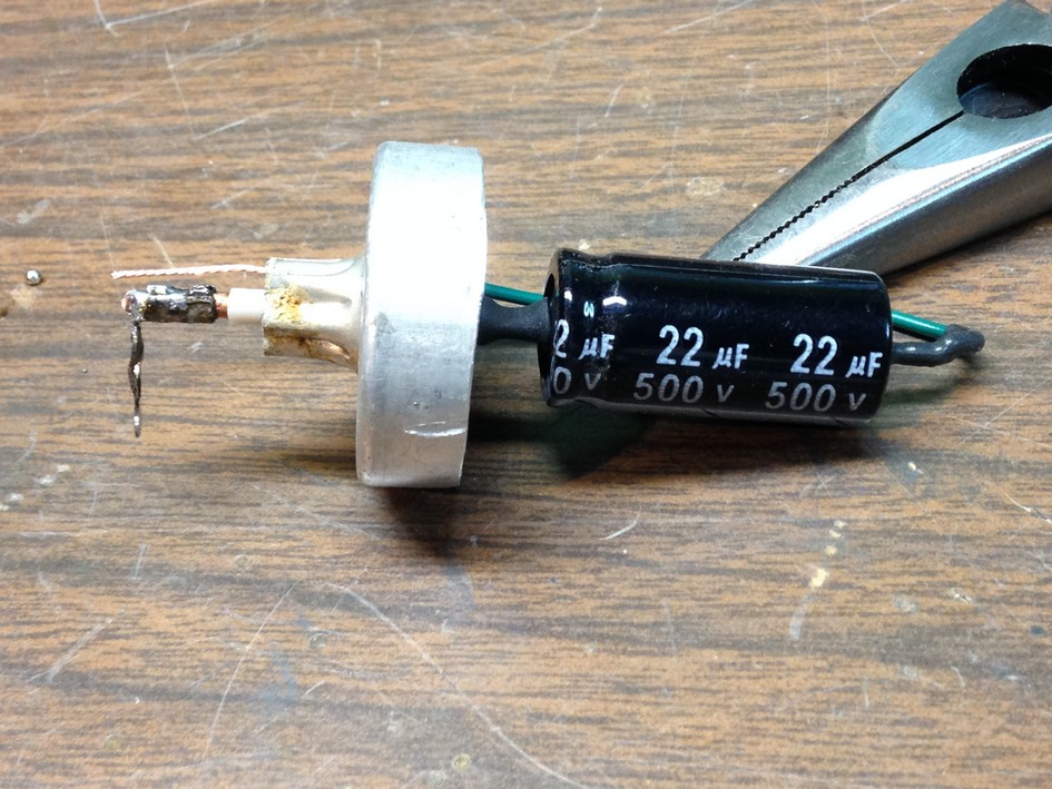

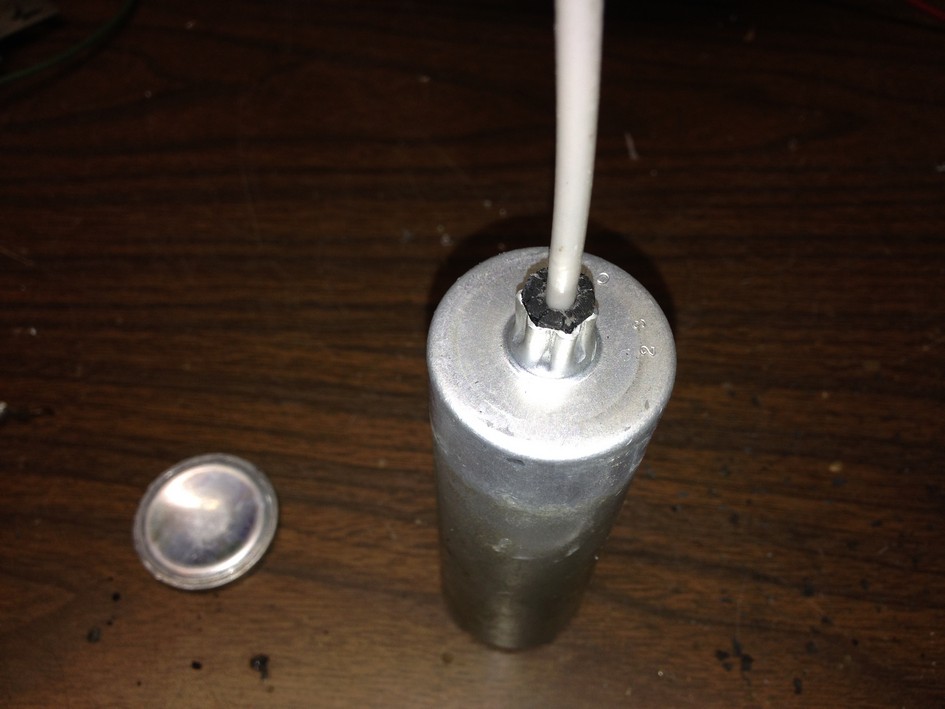

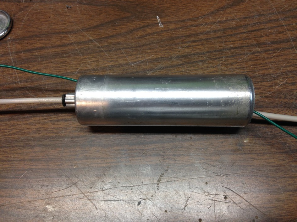

Here is the can, with new wires sticking out from both sides.
[Image: http://www.philcoradio.com/images/phorum/37640_062.jpg]
The small green wire is stripped and soldered to the negative lead of a new 22 uF, 450 volt Nichicon electrolytic. The positive lead of the new electrolytic is carefully wrapped around the stripped end of the 12 gauge wire, and soldered to it.
Notice that I use heat shrink tubing over the soldered connections. The heat shrink on the positive wire will help to keep the large wire from being able to be pulled into the rubber plug and possibly causing the new capacitor to short out.
[Image: http://www.philcoradio.com/images/phorum/37640_063.jpg]
Now, the new capacitor is in place inside the old can.
[Image: http://www.philcoradio.com/images/phorum/37640_064.jpg]
On the outside, I cut off the center wire at just the right length (about 1/2 inch), and strip about 1/4" of insulation from this large wire.
Next, I crimp the solder connector to the new copper wire, and solder it to the wire as well.

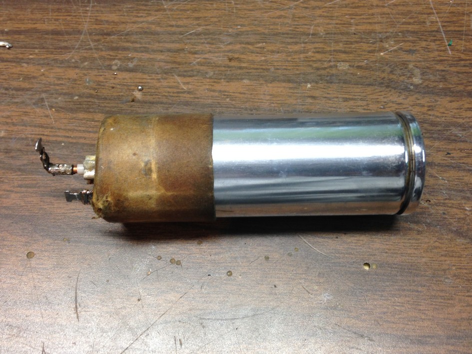

I cut off enough of the green (negative) wire to be able to connect it to a good ground point inside the RF unit. Yes, I could fasten it to the outside of the can, using the clamp to make a decent mechanical bond, but I would rather solder the wire to a ground point inside the RF unit. It won't be seen when the radio is finished, anyway.
[Image: http://www.philcoradio.com/images/phorum/37640_065.jpg]

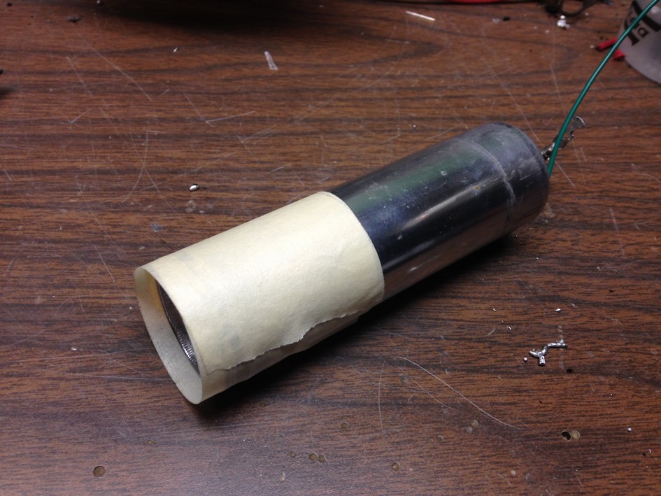

Finally, I glue the top back onto the body:
[Image: http://www.philcoradio.com/images/phorum/37640_066.jpg]
Once the glue dries, this can will be reinstalled in the RF unit. After that, I can begin to put the RF unit back together. Now is a good time to work on the electrolytic while the antenna and RF sections are out of the way and the underside of the electrolytic is easy to get to.

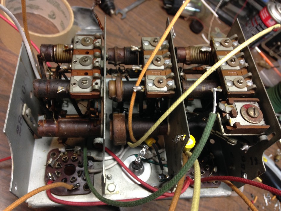

Time to continue with this project...

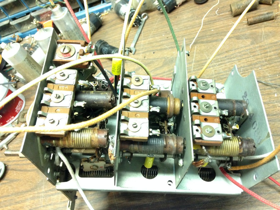

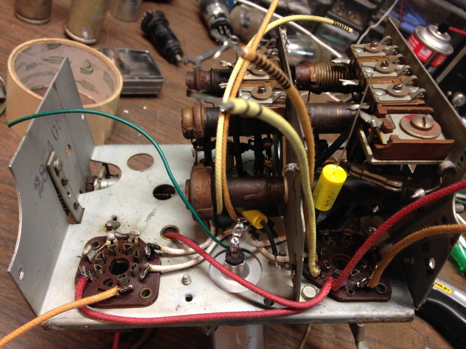

[Image: http://www.philcoradio.com/images/phorum/37640_067.jpg]

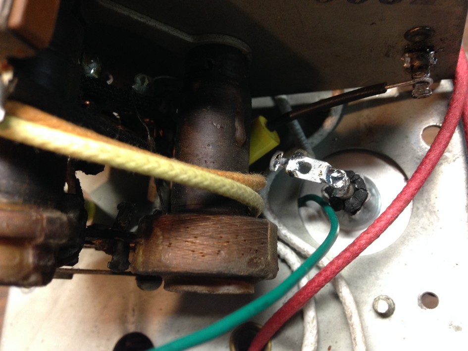

As you can see, the electrolytic can is back in place and I've reinstalled the RF section.
[Image: http://www.philcoradio.com/images/phorum/37640_068.jpg]
This shows the single wire is now soldered to the positive terminal of the electrolytic .
[Image: http://www.philcoradio.com/images/phorum/37640_069.jpg]
Now, the antenna section is back in place.
[Image: http://www.philcoradio.com/images/phorum/37640_070.jpg]
Another view of the underside of the rebuilt RF unit.
[Image: http://www.philcoradio.com/images/phorum/37640_071.jpg]
And a view of the topside of the RF unit.
Since I took this picture, I have also replaced the two grid wires which are soldered to the tuning condenser. I have also soldered the wires which come through from inside the RF unit back to the tuning condenser.
