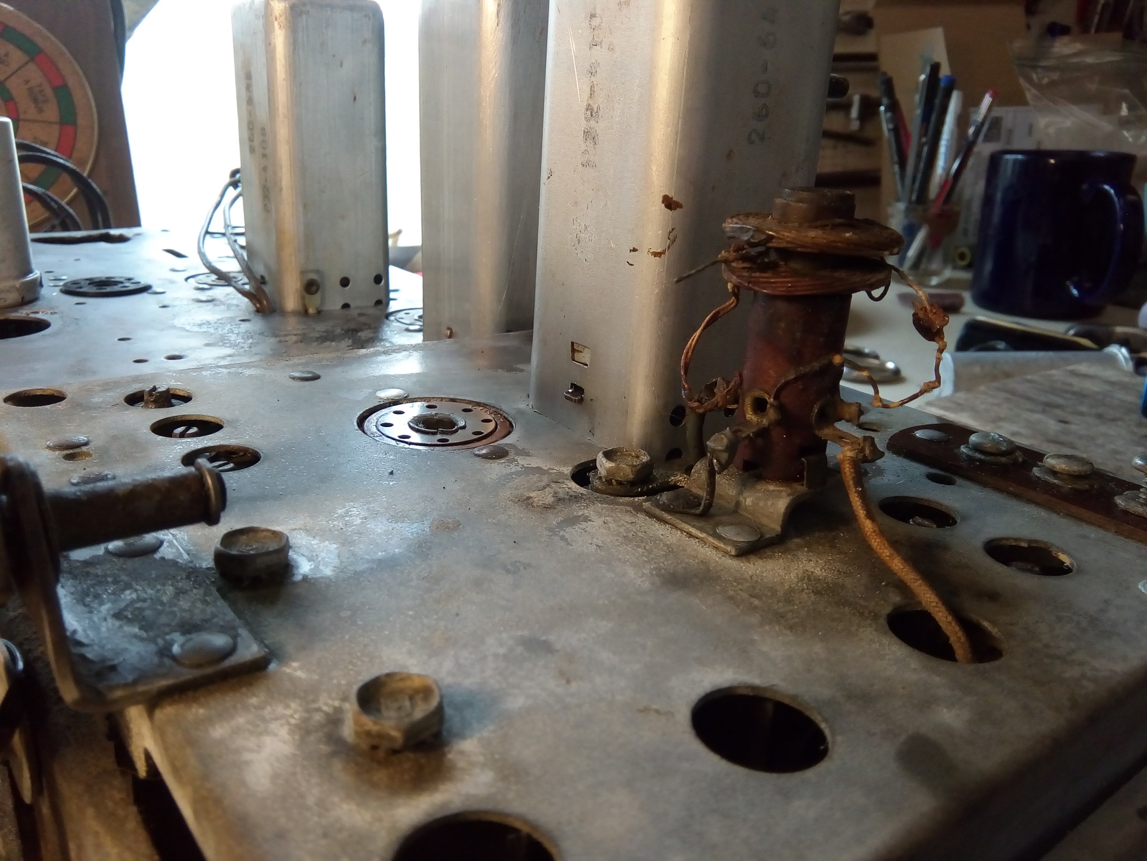

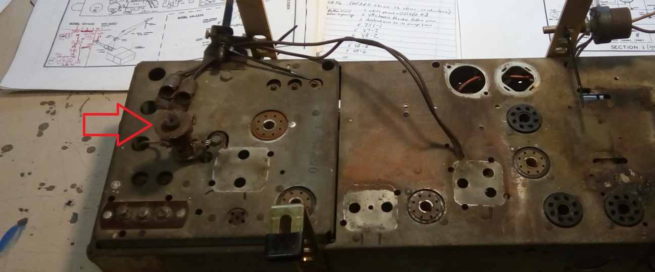

humm,, you dont have one of them on your chassis
#47
https://www.tubesandmore.com/products/an...ube-radios
#48

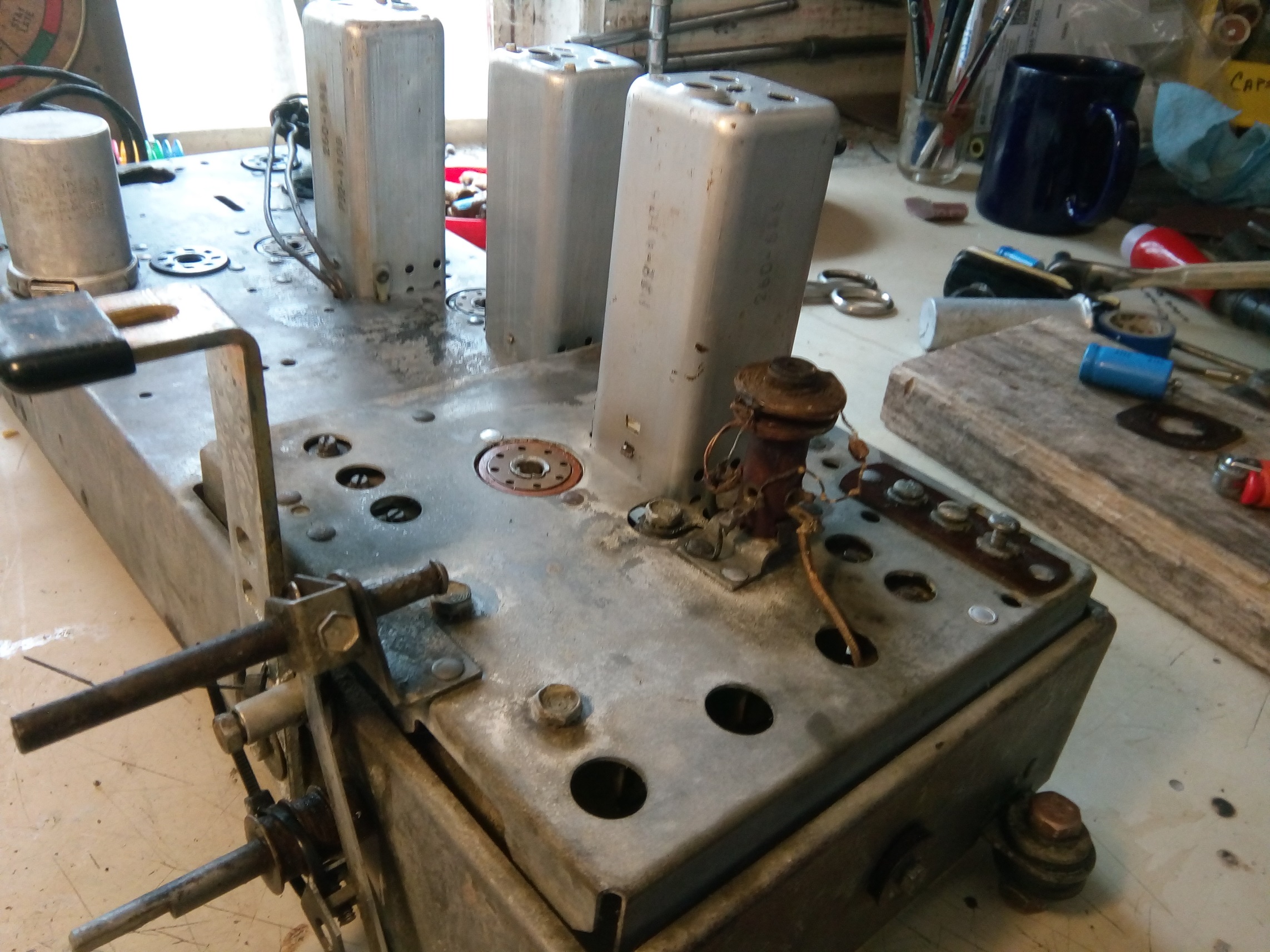

Ah...ok.  It looks like I have two of them on the underside.
Rich
#49
DO you KNOW,,,,IF they are open,,,best left alone
#50
ken
I have not measured it.
Rich
i do know that the end of the wire is tinned, and perhaps that means nothing.
when i found it , i had to assume it was terminated somewere.

In the picture I posted earlier I said I had 2 on the underside of my tuner chassis.  It turns out I have 3...there is a third one stacked under the one on the left in the photo I posted.  Your's looks similar to the one on the right in my photo.  I'll take a close look at it when I go downstairs to work on it later today and see if I can find a wire like that.

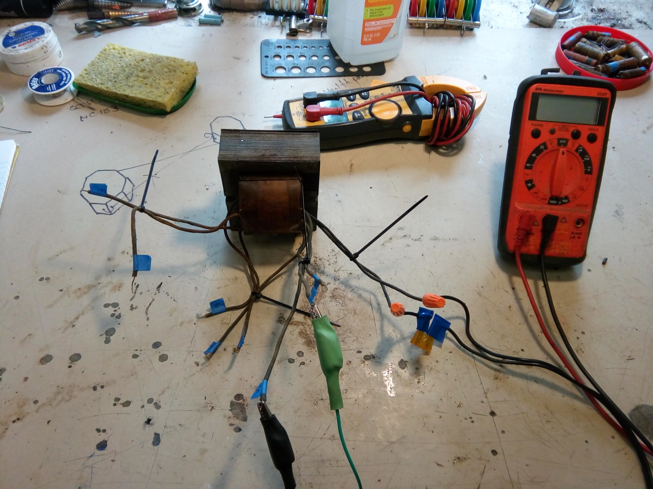

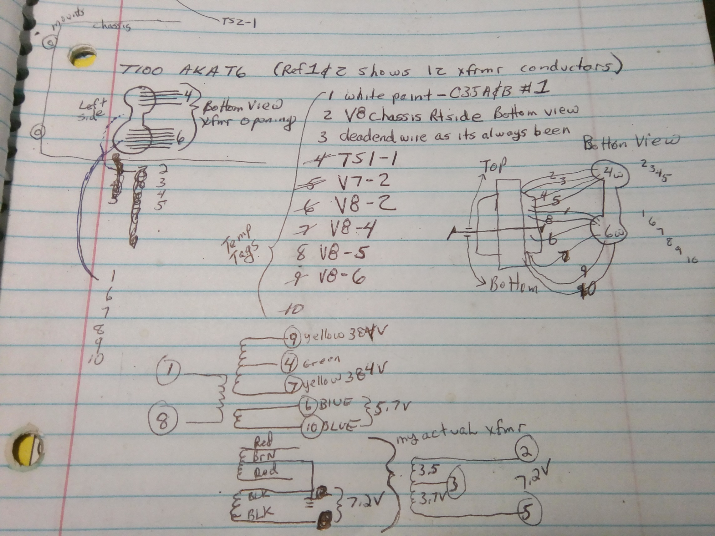

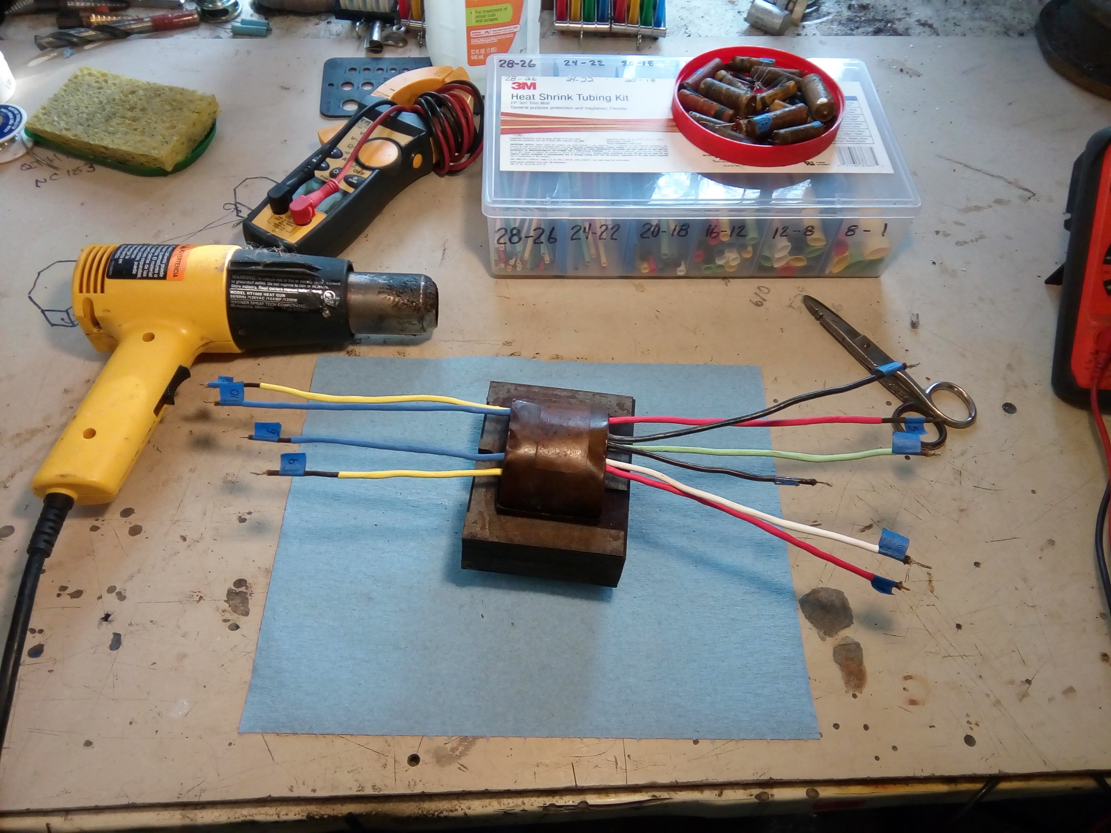

started picking on my transformer today, i was able to verify all the wiring.
I believe its confirmed i have a replacement xfrmr, no name plate data , no pn no sn , no Philco stamping ,, nothing.
my transformer secondary looks like this...
qty1) 800v secondary with center tap (400v/400v)
qty1) 5.7v secondary
qty1) 7.2v secondary with center tap (3.6v/3.6v)
I temp powered up and color coded my wiring.
My older complaint of having a transormer conductor spared back is correct, this would be the center tap on teh 7.2v section and its not going to be needed, i actually painted that wire insulation brown then put on clear heat shrink.  I didnt have any brown heat shrink.
the transformer seems to be wroking just fine.
#57

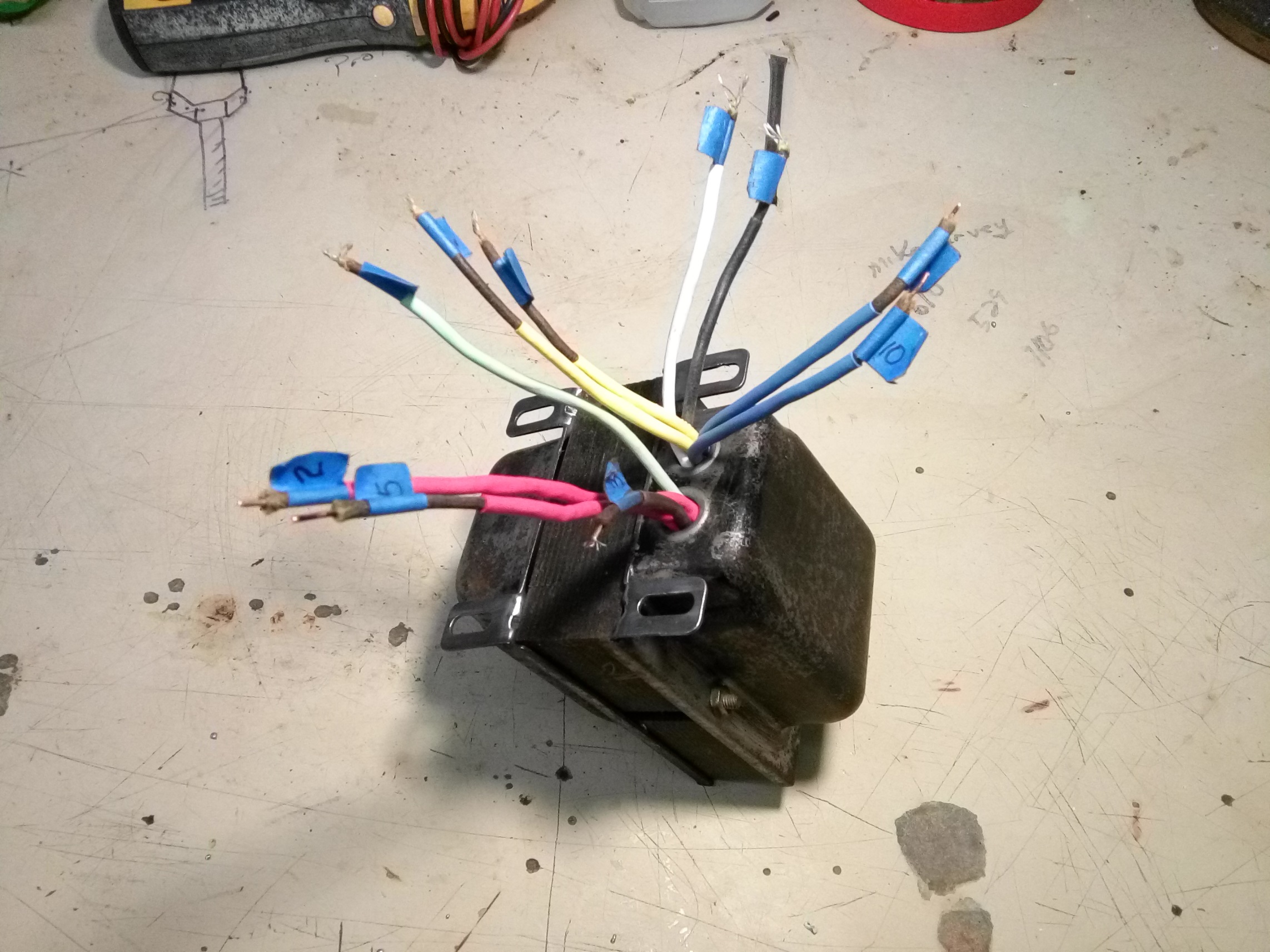

here are the progress pics.
now mounting the xfmr with clean surfaces.
ive noticed i have zero continuity from any wire to the chassis of the xfrmr.
i expected to at least have one lead have coninuity to the case... oh well.
there is a thin brass 1/4'' wide flap that dongles off the windings and sandwiches between the xfrmr covers,, i cleaned that off and added a layer of solder to it.  it was gooy with greenish looking deposits.
color coding to match my prints complete.
this part gives me hope that the radio has a chance of living longer.

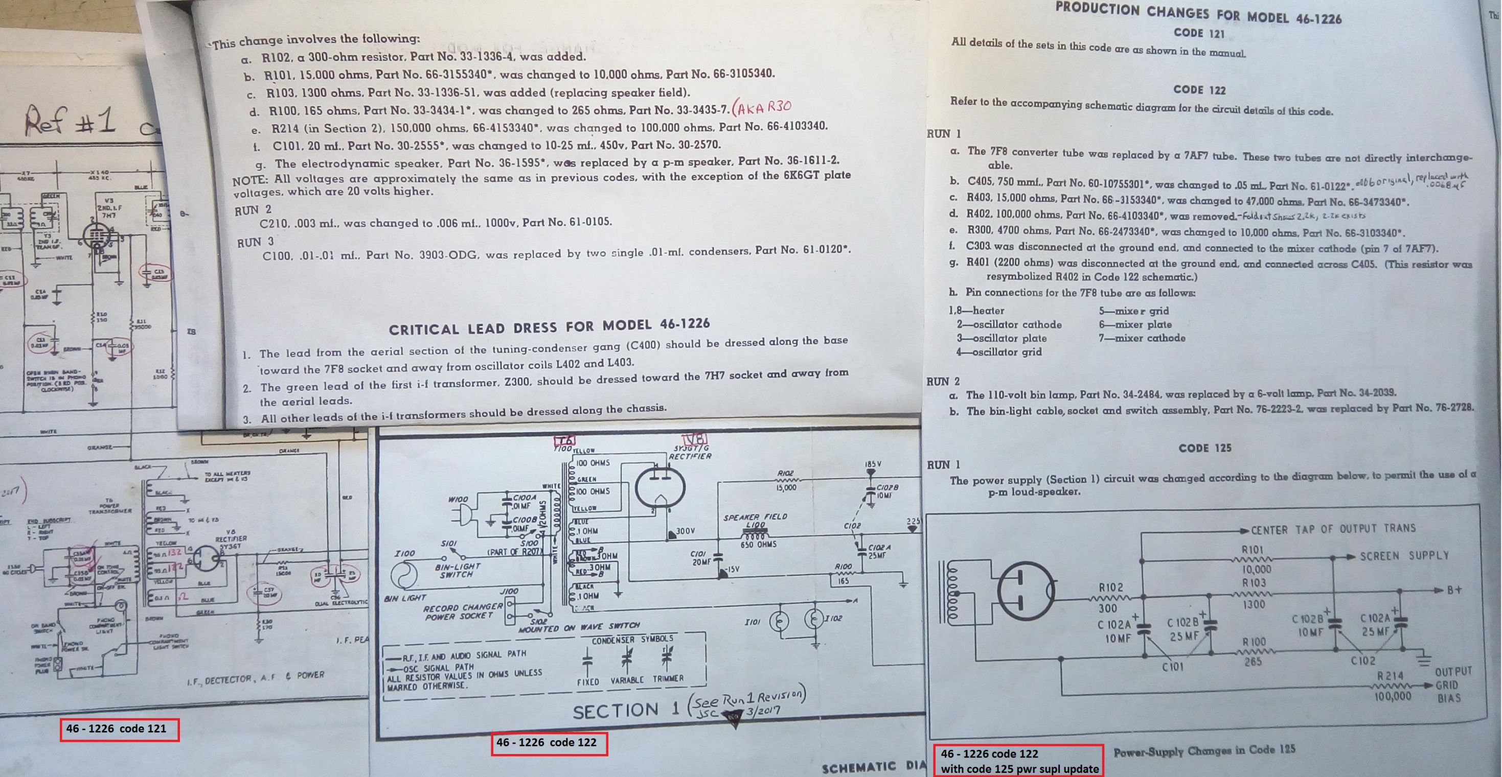

#58
i want to confirm something.
on the far right hand side,, there is a power supply UPDATE.
THere is a resistor named R102.
Is Philco trying to say to connect R102 to pin8 of my rectifier tube?
The update does not lable the tube pins
pins 4 and 6 are my high voltage 384/384v (measured) (yellow)
pins 2 & 8 are tied to my transformer single winding 5.7v (measured) (blue)
#59
What rectifier tube is it? Doesn't seem to be 5Y3.
They add the 300 Ohm between whatever the pin is that is the output of the rect tube and the first cap's positive, allowing to reduce the cap's capacitance (and size).
#60
the 300ohm Reisistor is an update to use a PM speaker.
yes the rectifier tube is a 5y3
