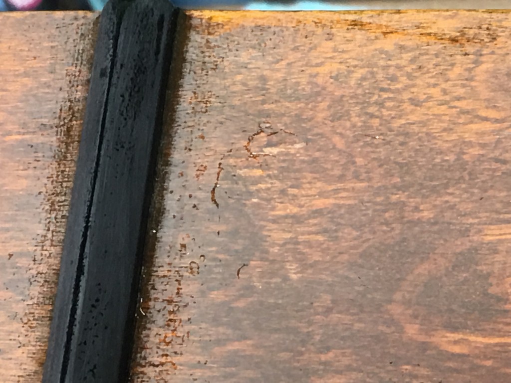

[Image: http://www.philcoradio.com/images/phorum...18_032.jpg]
I wet sanded the blemished area with a scrap piece of 1000 grit paper; I think I made the best possible choice of paper to do this blemish repair.
Then I sprayed some Mohawk Medium Walnut into the lid of the can and, using a small brush, went over the bare spots a couple times. I think I have the color matched up pretty well.

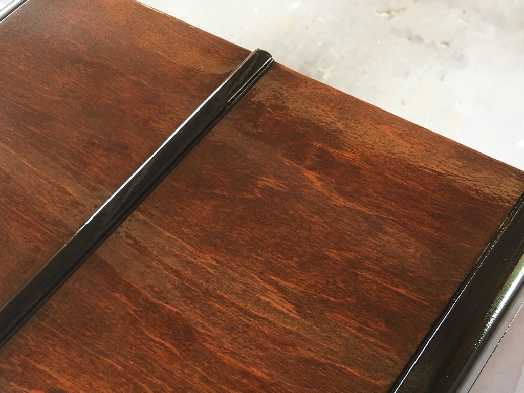

I think it is working...
[Image: http://www.philcoradio.com/images/phorum...18_035.jpg]
There is some bumpiness here now, but no depressions. I'm hopeful that another session of careful wet sanding will all but take care of the problem area.

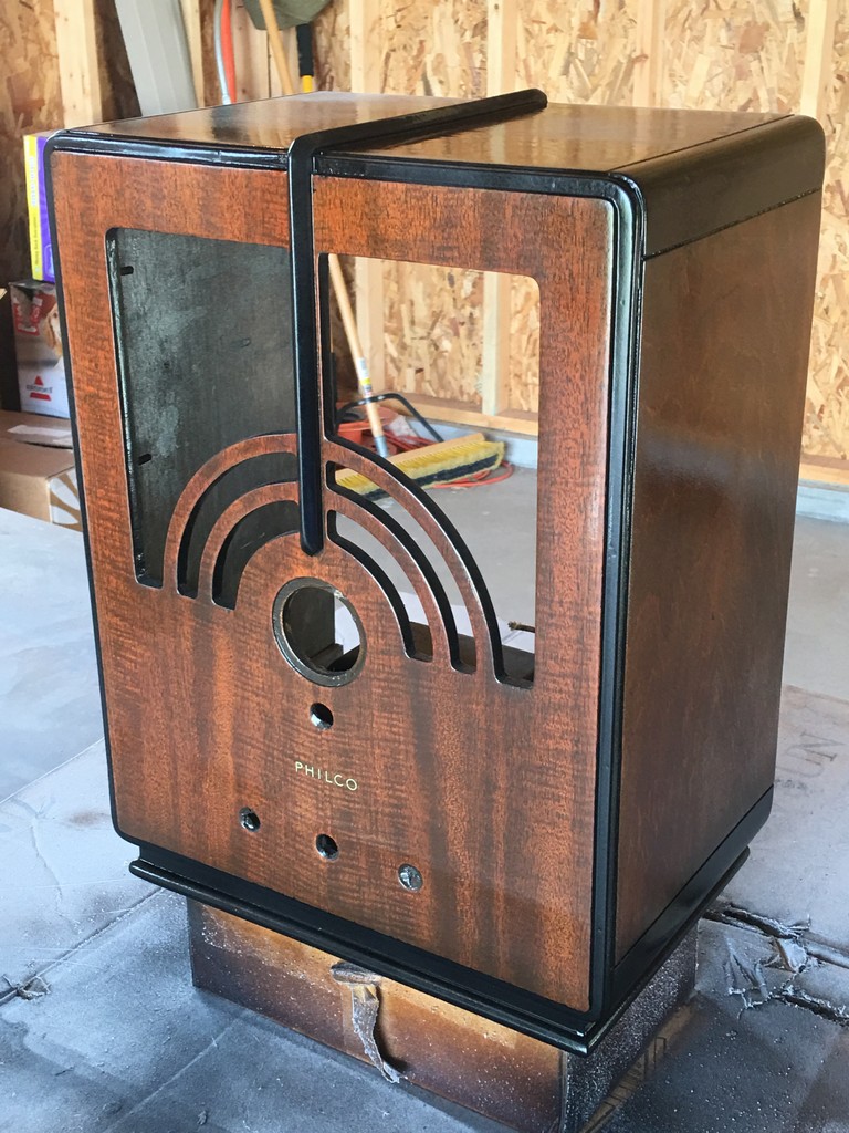

Next weekend is supposed to be much cooler with highs in the 70s...much better for spraying lacquer. I hope to wrap this cabinet up next weekend.

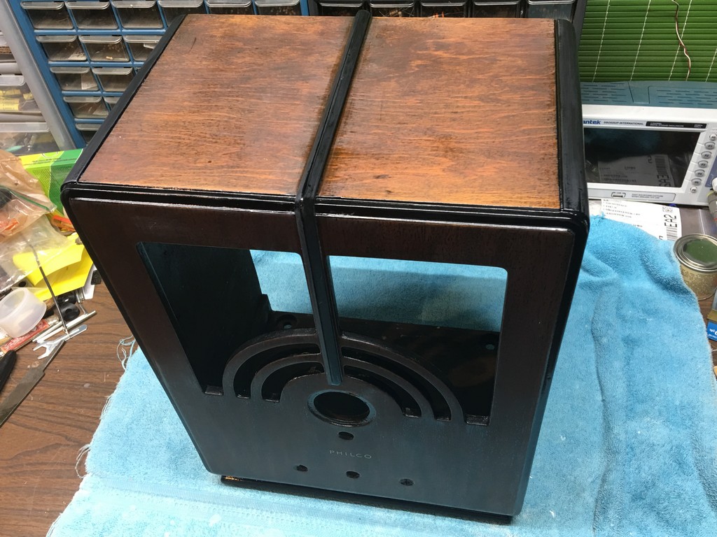

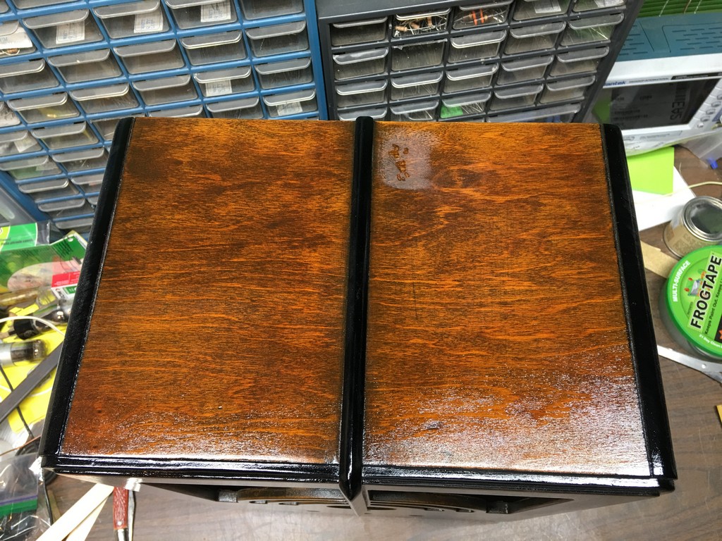

I did wet sand the Philco 66B cabinet this evening:
[Image: http://www.philcoradio.com/images/phorum...18_036.jpg]

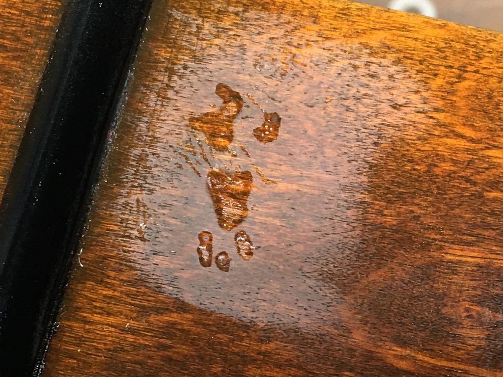

Now, a closer look at the damaged spot on top:
[Image: http://www.philcoradio.com/images/phorum...18_037.jpg]
Almost gone. Icon_thumbup
I am hoping that the next two coats of lacquer will all but hide the little bit of a flaw that remains.

Score so far on my 2018 cabinet restorations:
RCA 6T2 - DONE except for final rubout
Philco 66B - Needs final coats of clear lacquer
Philco 16B - Scratched due to polyurethane, better luck in 2019
Philco 41-KR - As yet untouched, maybe I'll have time to strip it one evening this week?
RCA T7-5 - Almost ready for sanding sealer
Philco 91B - Have new top/sides (wraparound) and new front panel, have not had time to work on it yet. It may not get refinished this year, but perhaps I can get the new parts installed, even over the winter.
