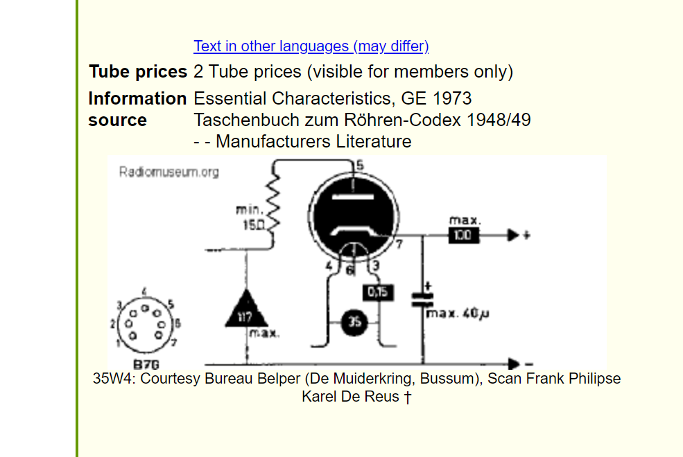

I think it's necessary to keep in mind that most (with a few exceptions) tube data sheets show "typical" operating values, not maximums. When I look at other schematics and most spec charts, I see "typical" of 40uF in the specs, but many schematics with more than 40uF, and I have seen and replaced some of these myself, usually with 47uF caps. Keeping in mind that these sets have operated for several decades like this, it is my opinion that this 40 vs 50 is a tempest in a teapot and unworthy of much debate. I believe the schematics are correct as drawn and are not errors, and I personally will continue to NOT second guess the engineers who designed the radios in the first place.
For yourselves ..... ??? ..... do as you wish.

About Typ/Max.
See below.

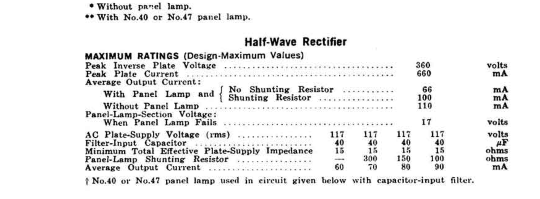

I am not a life-long tube designer and so I do not keep the tubes' datasheets the way I keep semiconductor ones, and so I have to go by what what I find, and so fat what I find has the words "maximum" and "40 uF" next to each other.
I saw one sheet showing 40uF undet "typical" but then it did not show maimums.
So, if you produce a datasheet that says explicitly "maximum 50uF" I will agree with what you say.
Meantime, here's another one for the same tube I found.
And....speaking of "several decades of operating like this", we do not know how many time this tube was replaced.
PS. I am not saying the tube will immediately go up in smoke because of 50uF. Or even 100uF. It might last for years and, given today's "once in a blue moon" operation, might live forever. But to me this is a wrong way to do things. Even if it works.
