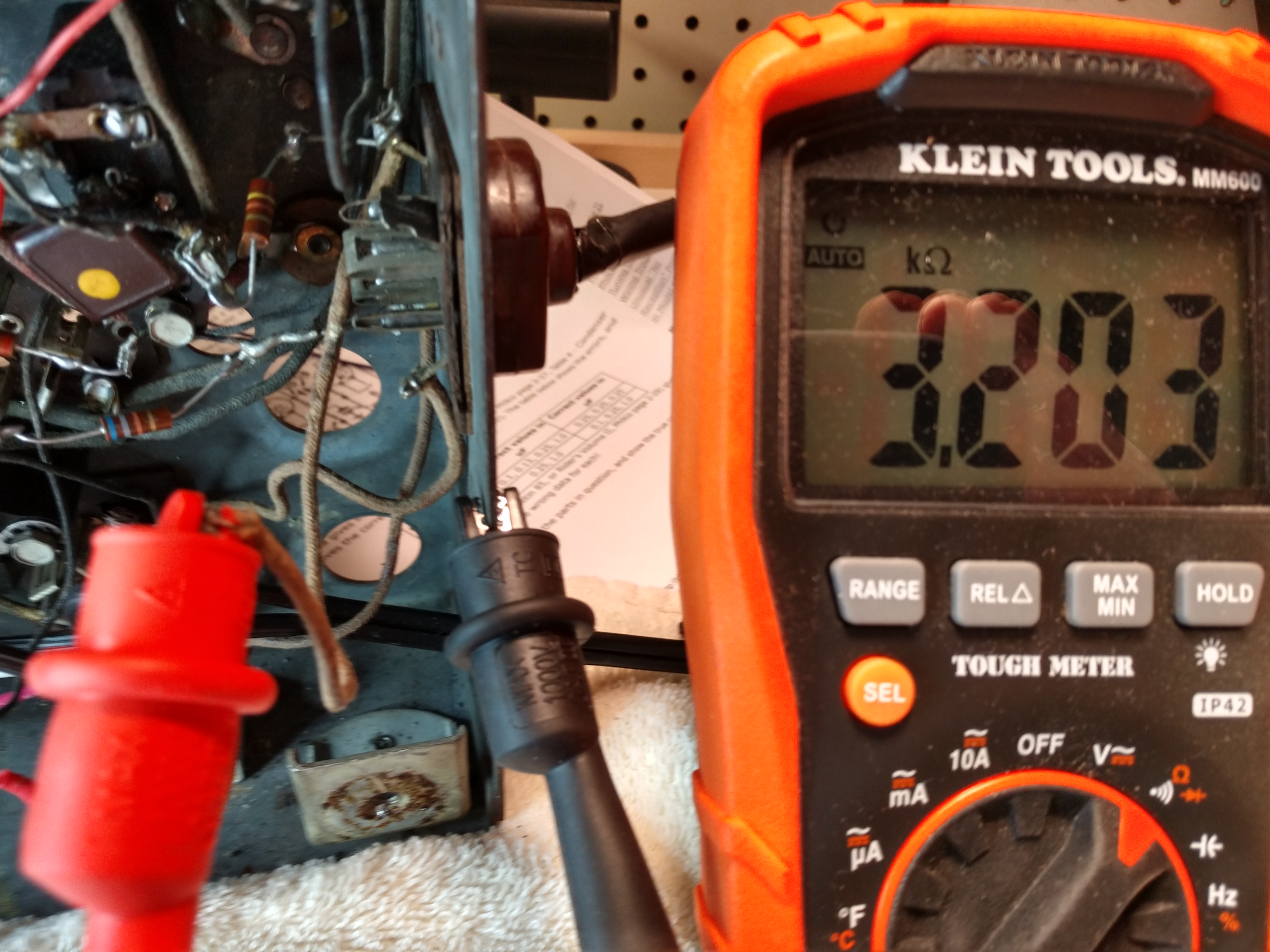

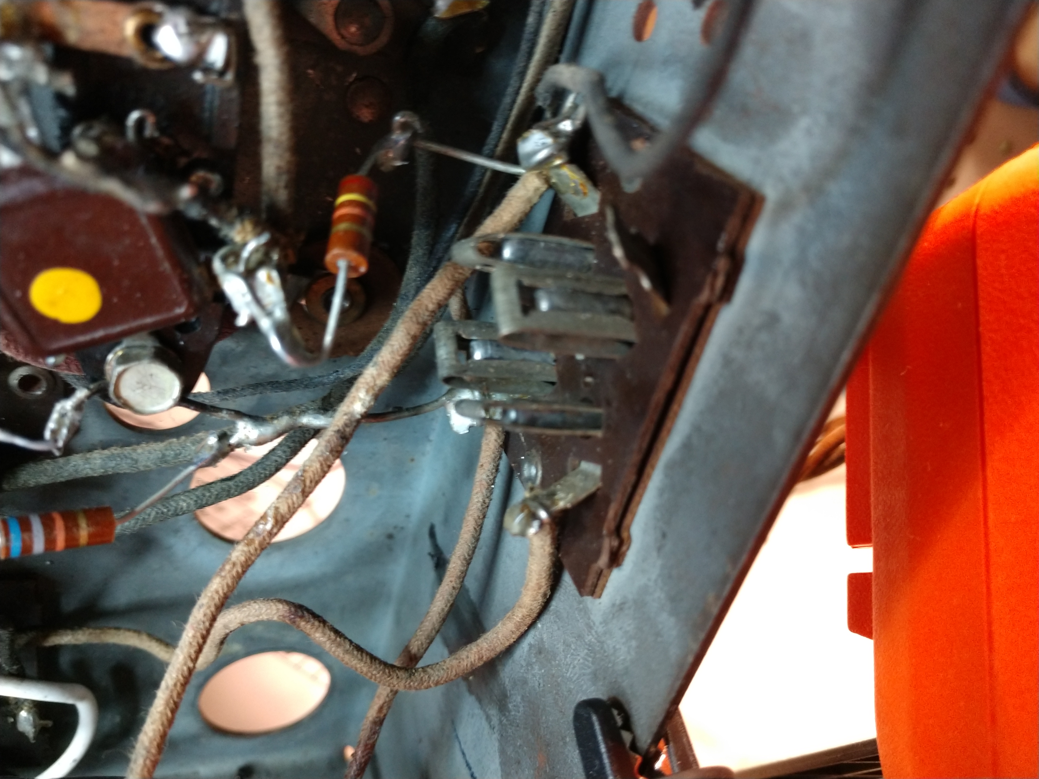

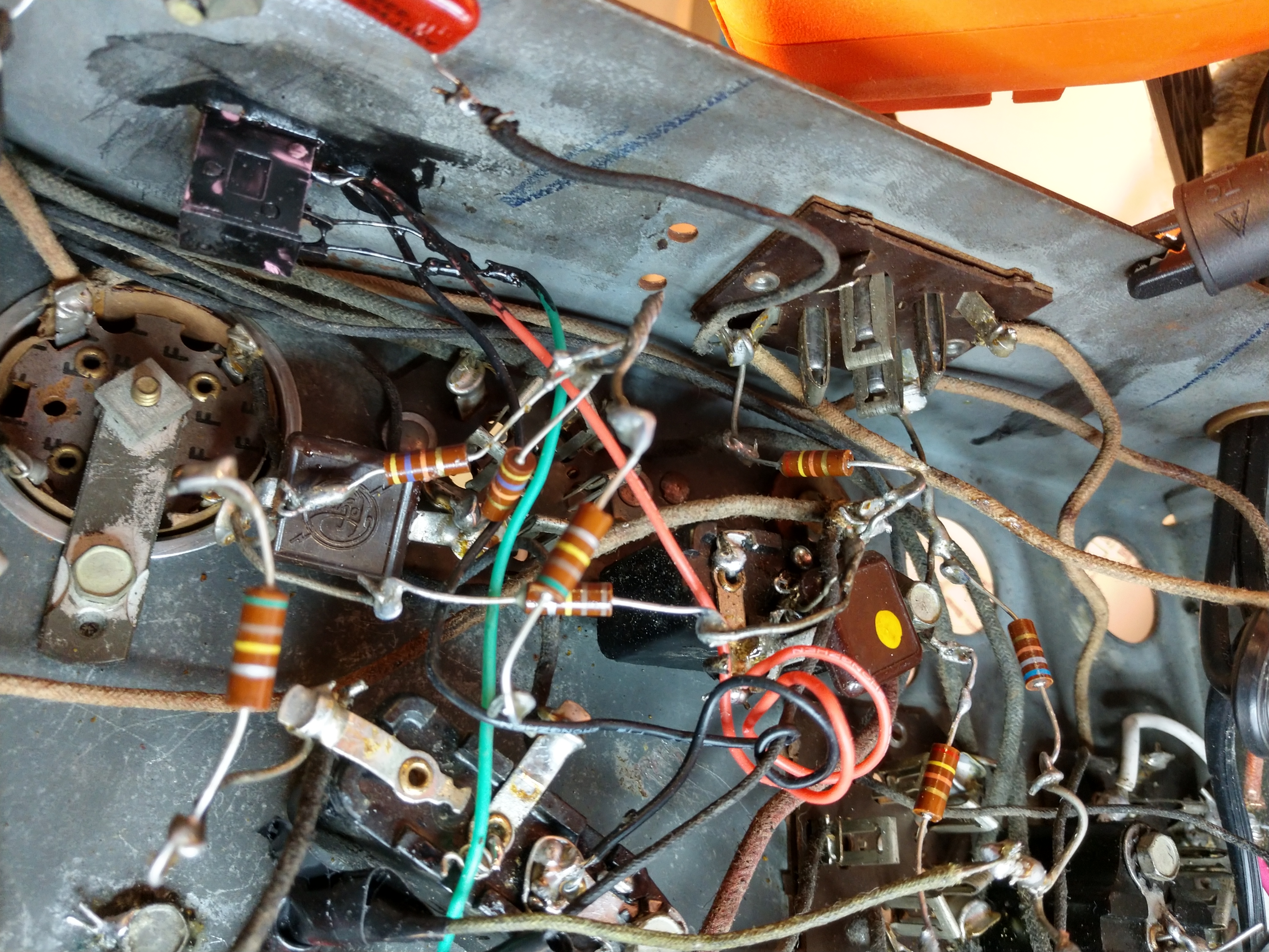

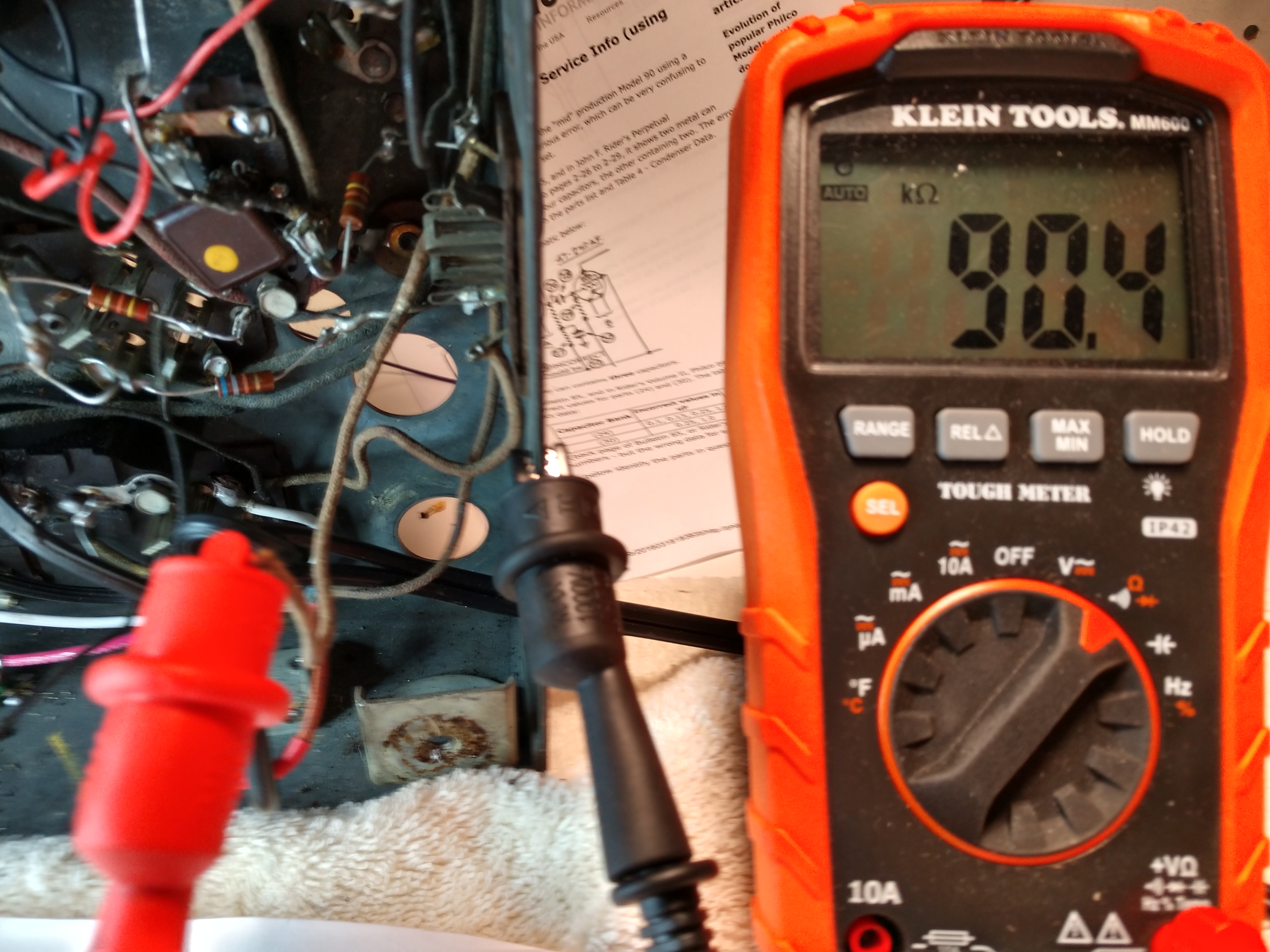

OK I was doing something stupid.  The wire from terminal 3 is fine...it reads infinite resistance to ground.  The wire from BC resistor terminal 4 is the same readings as before...90.4k ohms with the speaker unplugged...3200 ohms with the speaker plugged in.
Pics show these 2 readings, the speaker socket and the general area around the speaker socket.  All tubes are out.  In the last pic, that small black box attachment is for a 1/4" jack input for Bluetooth and similar input.  Pretty sure it's not an issue.  Radio and it worked fine before.

OK starting on speaker socket that is connected to BC terminal 4 and going clockwise.
Speaker plugged in:
1. 3200 ohms
2. Infinity
3. 98k ohms
4. 20 ohms
Speaker unplugged:
1. 90.6k ohms
2. Infinity
3. Infinity
4. 22 ohms
#58
The B+ line (speaker socket terminal 4) is shorted. You will need to trace that line all the way through.
