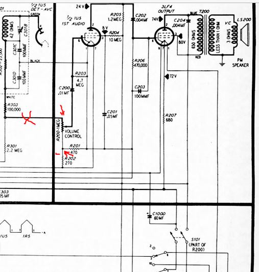

Attached below is a section of the diagram.  Cut at the "X" and inject at the arrows, with the "hot"(tip) of the output on the pot side of the X and the ground (shield) of the MP3 to the junction of the pot, R201 and R202.  Use an MP3 with an all plastic case or set the MP3 before powering up the radio.

Is the X where I disconnect from the volume control and check marks where the output of the Mp3 goes? Is one the ground wire?

After looking at the schematic closer I understand where to inject the signal. Is it ok to use something other than an MP3 player?
