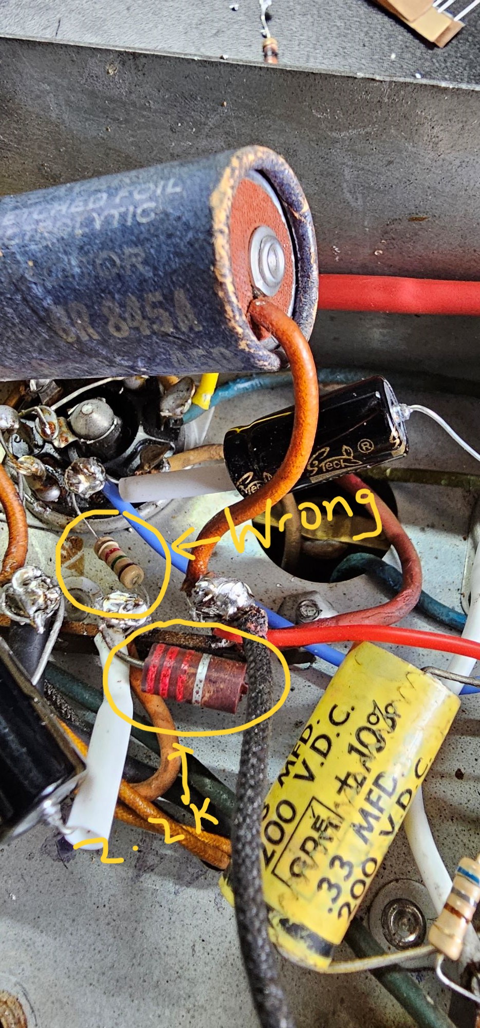

I am back tracking on my resistors as the one that burned based on the old one's resistance was correct but another resistor that connects to the tube wasn't correct. I swapped them initially based on the schematic and a resistor chart. I am double checking with my pictures; there's only 14 so I'd rather be safe than sorry.

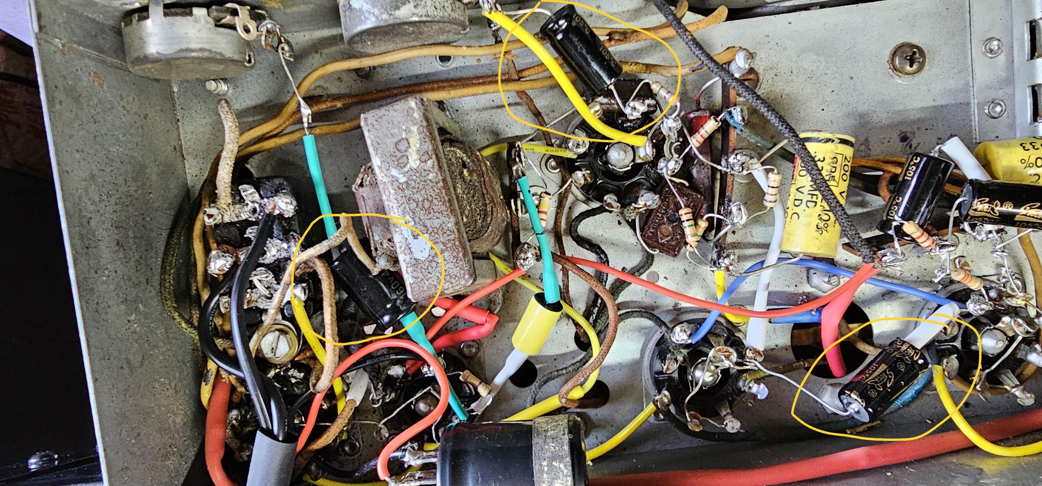

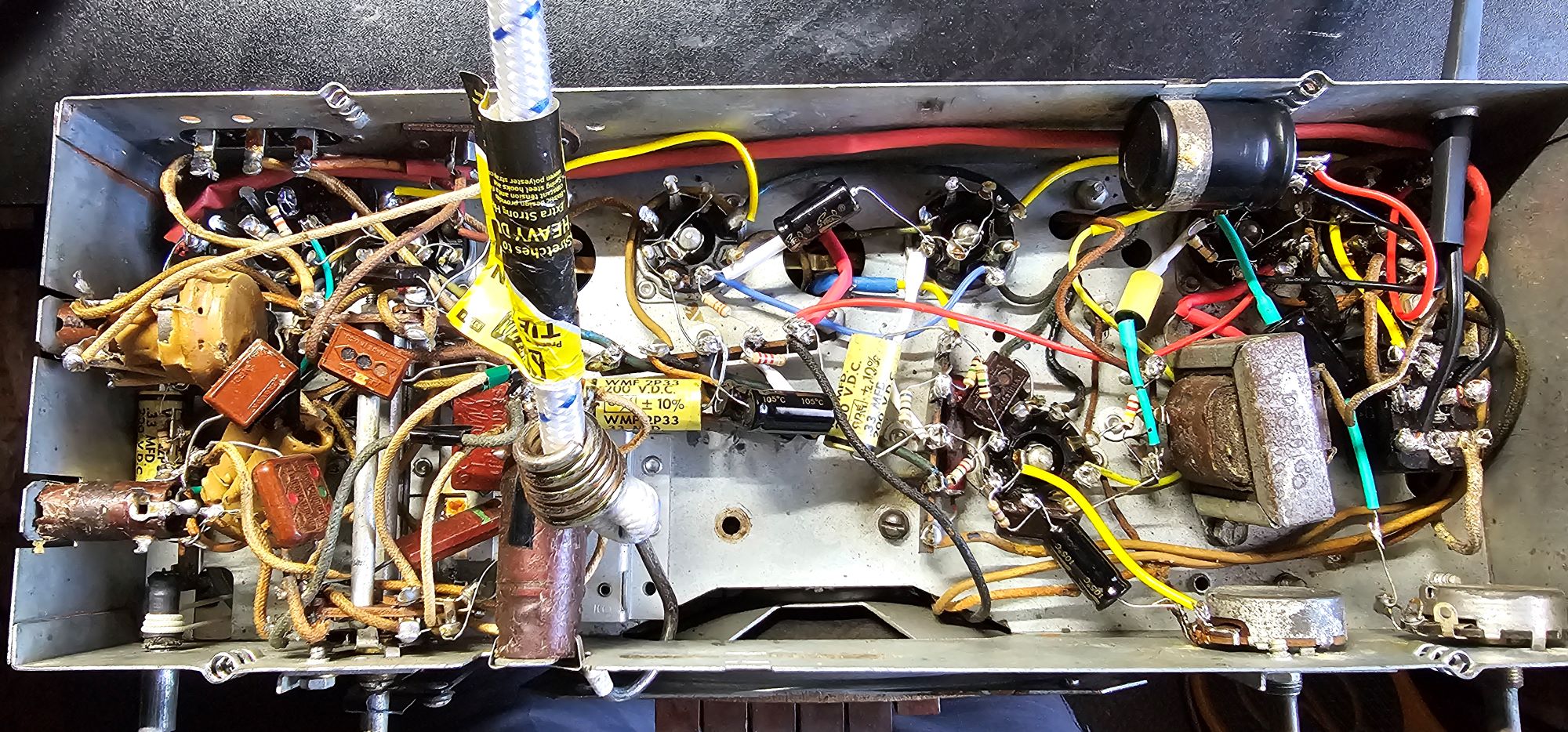

I believe I'm making progress, resistors have been rechecked and corrected, removed that ugly blue capacitor and more wiring. Powered it up, pilot lights are working, and the humming sound is still there but very faint compared to when I started. Now to the speaker and the Antenna.

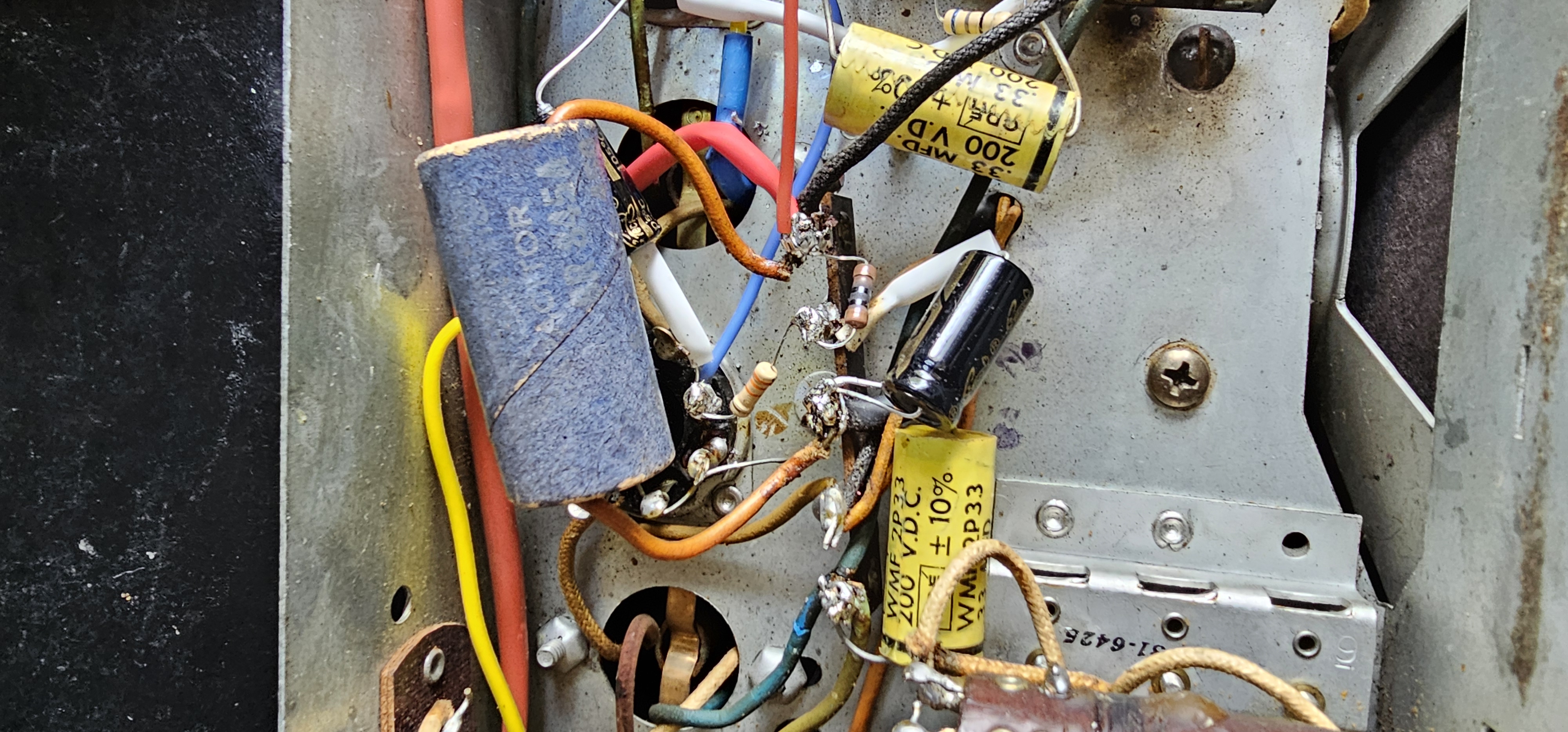

Well guys I am stuck, frustrated and about ready to give up. For starters all I'm getting from the speaker is a humming sound no stations coming in.
Issues encountering now is resistor 42 has burned again but only after I reinstalled the blue capacitor removed yesterday. I reinstalled the blue capacitor because a new one installed in it's place popped today.

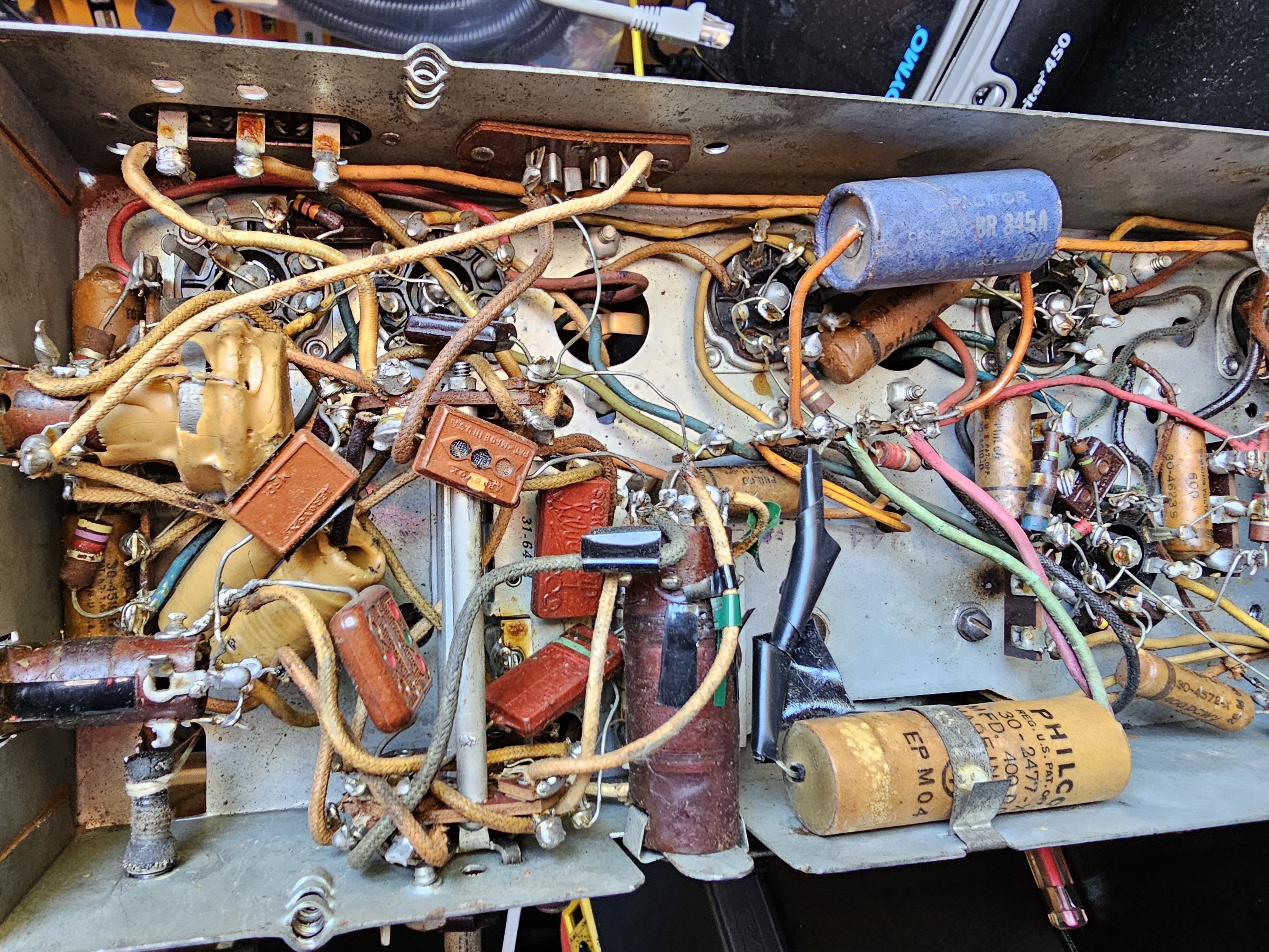

My problems seem to be around area 40 and 41 on the schematic. Capacitor 40 looks like a double 400volt, unless I'm missing itI don't see the blue capacitor on the schematic. My original picture shows #40 cap, blue cap and #41 resistor connected.

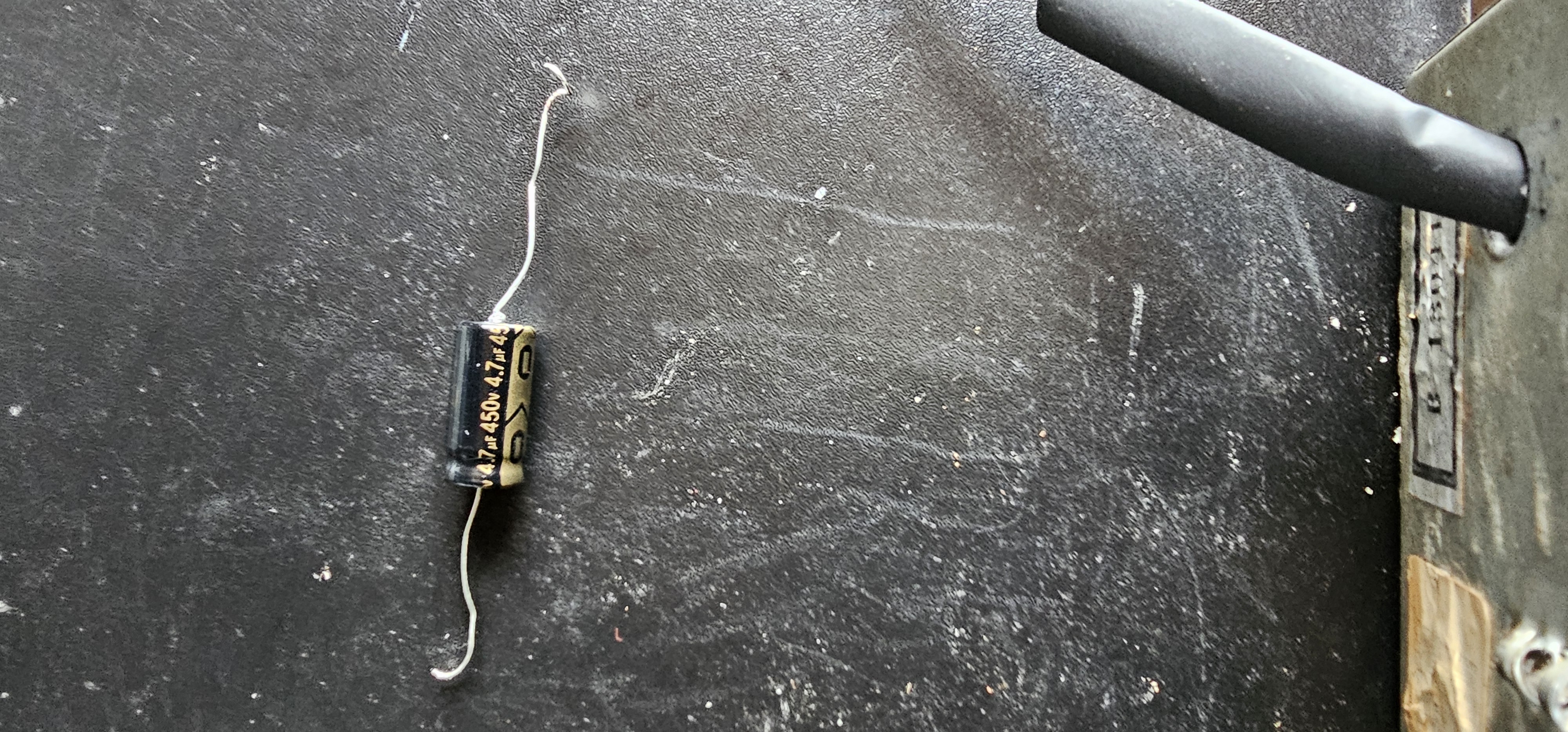

Earlier it was mentioned that cap 40 could be rebuilt. Can it not just be replaced with 2 450 caps? Today while testing the 2nd 450 cap which connects to resistor 42 and the speaker wire it eventually popped.
I've attached a before photo showing the #40 cap and the blue cap. Can someone let me know if the blue cap is seen on the schematic.
Thank you.

Correction
My original picture shows #40 cap, blue cap and #42 resistor connected.
#52
From what I see is the blue cap was added by someone after the radio was sold presumably to replace cap 40A. I can't tell if the original 40A had been removed from the circuit. In any case, you should remove original 40A and the blue cap and connect a 4.7mfd cap with the negative lead to ground.
I am assuming the black electrolytic cap in the last Pic is cap 40 and the center terminal of the strip is ground. Therefore, it appears cap 40 is connected backwards with it's positive lead connected to ground. When you do this you get the result you experienced, pop!! The 2.2k resistor should be connected between the positive leads of caps 40A and 40 as the schematic shows.
Whenever a new cap is connected across a defective one the result is a bigger defective cap.
Take your time and carefully remove the old caps from the circuit then connect the new caps in the correct polarity. Test the 2.2k resistor, it may be okay. If the resistor gets hot then there's a problem with one of the circuits that is connected to cap 40.

If you check my post #49 it shows the completed chassis with 2 new caps for #40 and hopefully #40A. Blue cap removed, I had it on a few yesterday and the day before. I am definitely starting with the polarity checks.

  • It was common for people to " bridge" old electrolytic caps with new ones.  This is why that blue cap exists.  It was bridging one section of that paper electrolytic 2 section capacitor.  Take them all out and replace with originals.
  • Electrolytic caps can either open or short as they get old.  The "dry" type tends to open.  The wet ones often short.  When installed backwards or working voltage is exceeded electrolytics overheat, short and explode.  C40 being installed backwards could have taken out the resistor.

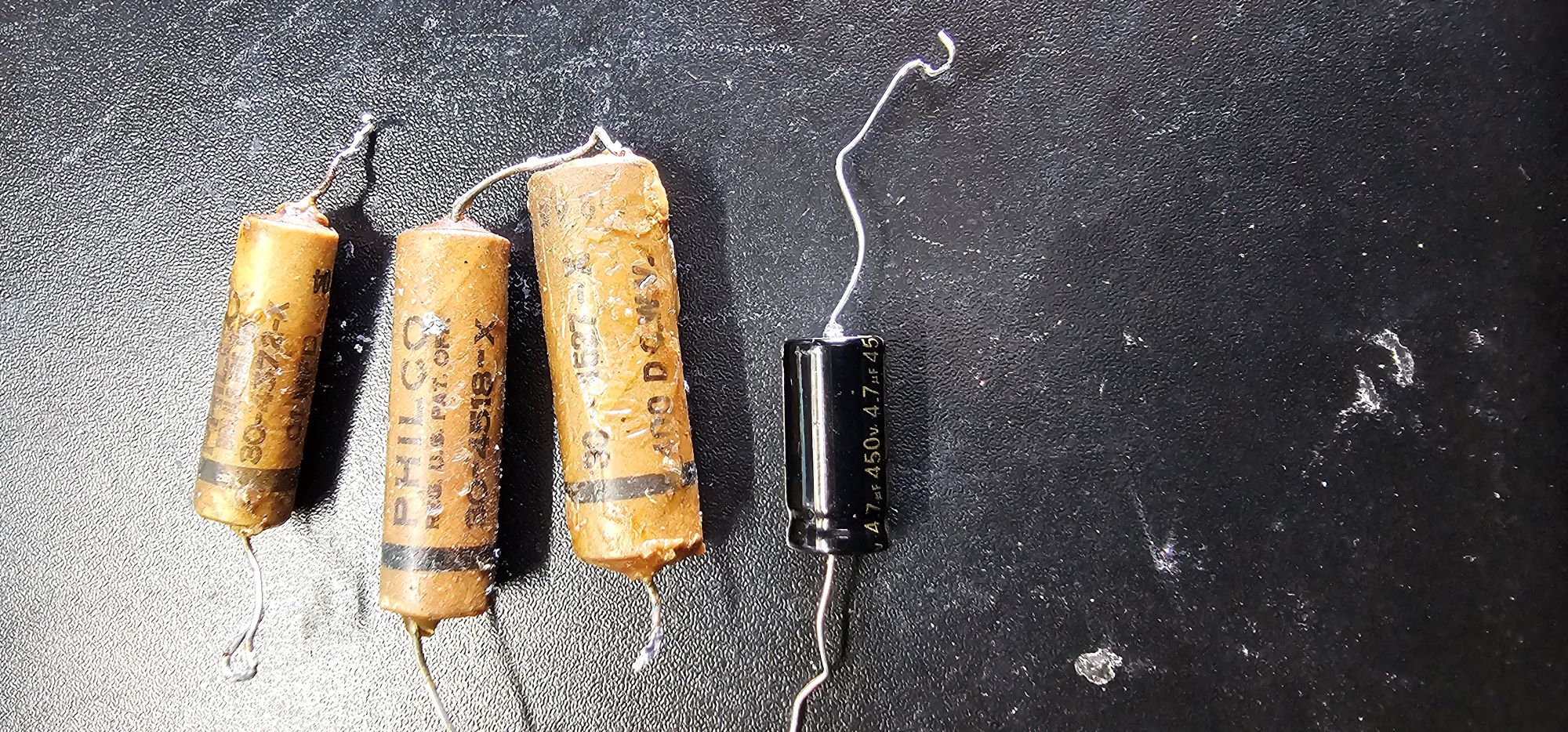

Ok guys I've corrected the polarity of the area that popped the capacitor and resistor. I do have a question in regard to the old wax caps, is it true that they are non-polarized and can only be replaced with film capacitors? I am looking at the schematic and trying to figure out polarity with no luck and not sure from looking at the old capacitors. The 3 in question are I believe 26, 44 and 49. I'm including a picture of the replacements circled in yellow and of the old caps, google is saying they need to be film but wanted to check here to be sure.
#58
If you look closely at the paper wax capacitors they probably have something like "outside foil" near the black band. This designates the lead connected to the metal foil that ends up being on the outside when the capacitor is rolled up. When that lead is connected to the lowest impedance side of the circuit it acts as a shield to external interference. Modern capacitors are not marked as such so you would have to determine electronically which lead is the outside foil. This is the only "polarization" of paper caps and doesn't have a considerable affect on the operation of the radio.
Paper capacitors are usually replaced with film capacitors. Other types may be used but they are generally much more expensive and won't make a big difference in performance. But I have some bumble-bee caps you can have for ten bucks each, a real bargain!

Rod thank you for helping to understand the paper caps and offering the bumblebee caps. I have already ordered film caps to replace the 3 axial that I installed. I will not try powering this radio up again until the replacements are installed.

In some cases the old paper caps can be replaced with ceramic caps, with values such as .001 uf, .005 uf, .01 uf, and maybe .02 uf, you don't usually find ones larger then that. Some claim that they are not good for audio circuits, but many radios of the 1950s and 60s used them, and I don't think you would notice much difference in the typical set from those days with a 4-6'' speaker. One place they do not work is in the vertical circuits of TV sets, which this Philco obviously is not.
