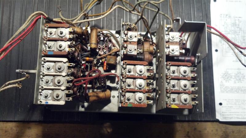

Sombody's going to tell me where all these wires go - - - right?!!Icon_lol

Our house is large too, but most of our radios are displayed in our 2000 sq ft shop. THIS ONE goes in the living room because both my wife and I like it. In our opinion it is very nice looking and classic, one of Philco's best, both visually and electronically (pre-WW II). And, no, it is not all that hard to work on.
And it weighs too much to "rotate" vey often.
About 17 wires counting the ground.

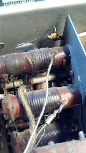

Here is a picture of one of the caps that is "not really difficult" to replace - once you have pulled the sub chassis and all 17 wires. This one has been restuffed (of course) and remounted already. There are 2 in similar positions. Remember, this is also with the sides of the sub chassis removed. You can see the .05(mf).

I tended to find the RF deck leaning more towards the difficult, but I am not what I would call a "skilled technician."
