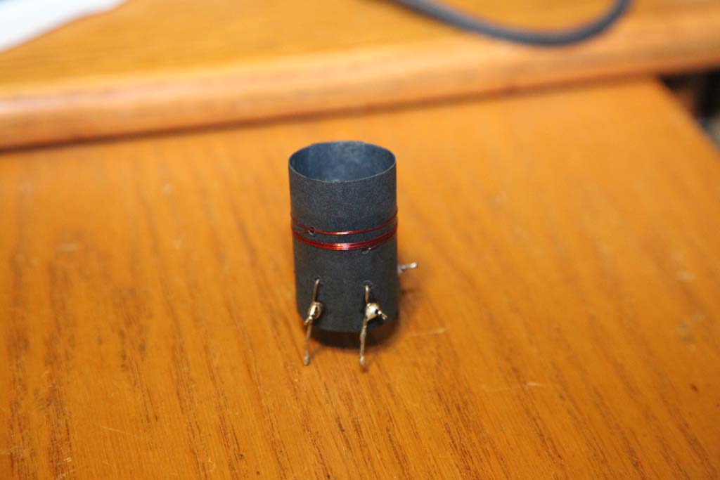

I think it is 1" and that's what I built.
Now that it is built I only need lugs and eyelets.

Beautiful job
See, you didn't need no stinkin' eyelets or lugs
Yep. That just complicates it. I saw some radios, forgot which, could be Century or Halson, where the coils were done exactly this way. Plus the AK I just did has that where they use drums with resistors and caps mounted on them (that's how they mount components, instead of the flat phenolic board) in the same way too.
So I thought to myself, if it is good for them, why not for me....I mean, for Kirk

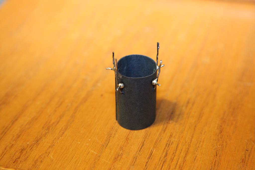

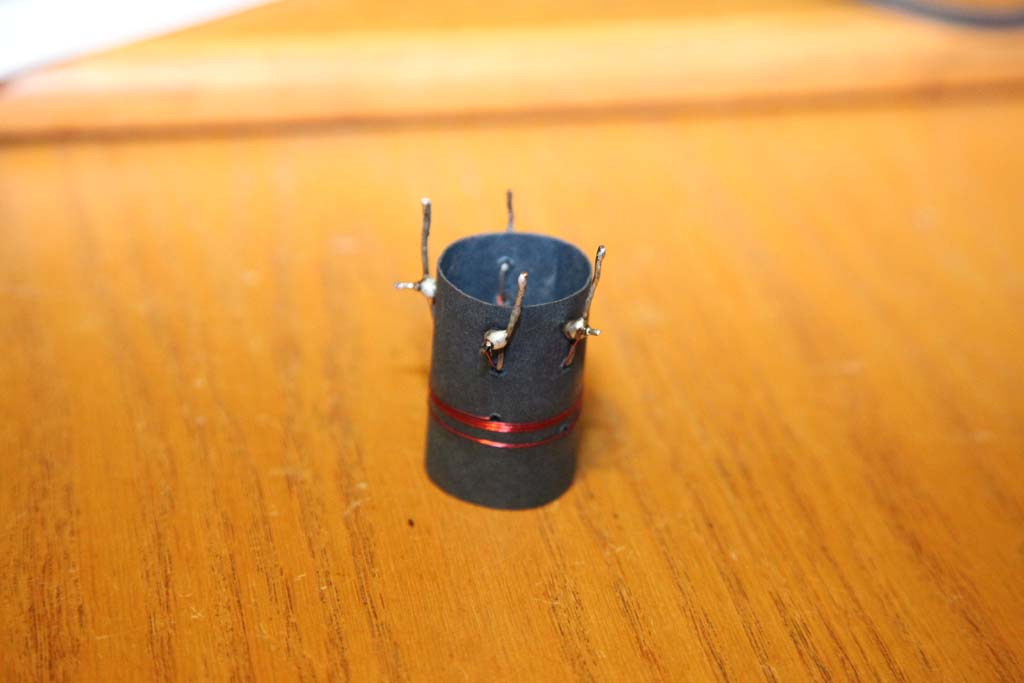

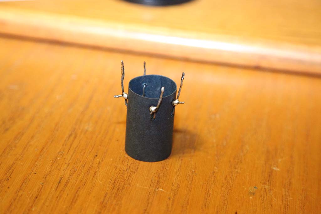

Above I have already gave the pic of the coil, I did without lugs. No need.
The fish paper I have is rigid as it is (as a product it is designed to be rigid and resist mechanical stress, it even has some mica in it just for that) but then I did two-ply glued together, which I then rolled and glued, and then when it dried, put it on a cylinder (somehow it fitted exactly to an aluminum cap I had which was 1"), heated it up a bit with a heat gun and left to cool, then took it off - it is a practically ideal cylinder now. Very rigid. In fact way more rigid than the original coil. Plus I think non-palatable to rodents  as it has mica. (I think the wax is the substance the rodents were after, they love eating candles).
