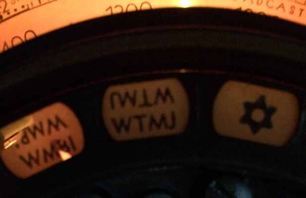

I printed them out, let the ink try, and cut them up  I inserted them in to the dial, and powered u the radio.  Flipped the mag tuning to get the floodlights on, and was both happy and disappointed at the same time.  I was happy as they do look very close to the originals in style and color.  But sad as they block more light than the originals do.  Here you can see my two new tabs next to a broken original one.  They are clearly darker than the original.  Still usable, I just wish they let a little more light through.
I guess the only other thing I could try is finding a spray paint that would stick to the clear, non-inkjet matte finish that would match well, and hopefully let more light through.  Then I could print up water slide decals (which I also ran across at Hobby Lobby).  So, not sure what I'll do.  I've already got 6 sheets of the inkjet paper.  So I'll probably make myself a set of tabs from that.
I also have the 6 clear sheets (which I can't take back, as I experimented on one of them).  So maybe I'll keep my eye open for some kind of paint.  Not sure what kind you have to use.  I imagine whatever it is, I would have to spray it to get nice uniform coat without brush marks.
