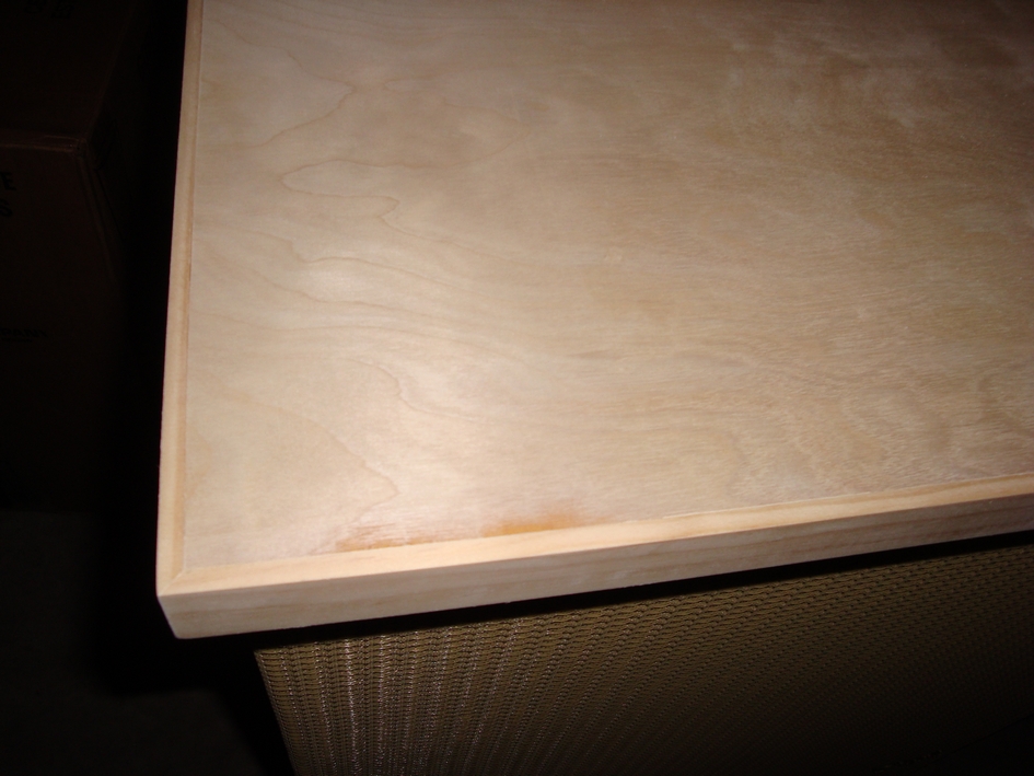

KCMike wanted photos  so, while I was in the basement photographing my August Finds, I took one photo of one of the tops which shows where I burned through the paper-thin top veneer layer in the process of feathering out the edge to match the trim.
[Image: http://www.philcoradio.com/images/phorum/bozak_025.jpg]
I still think (hope) that the stain will hide this error.

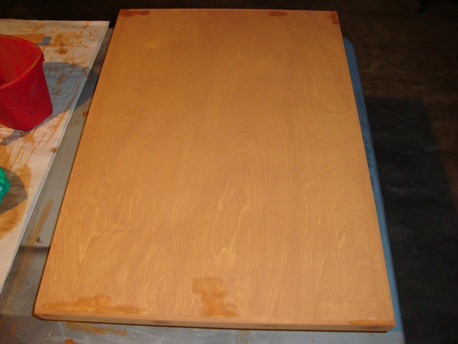

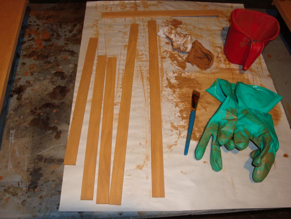

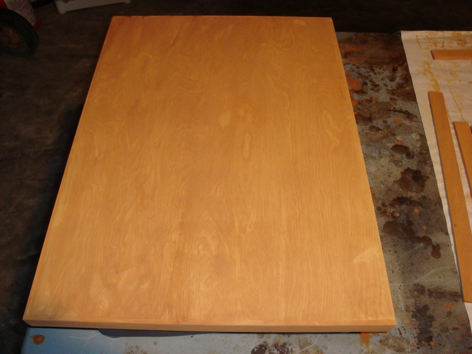

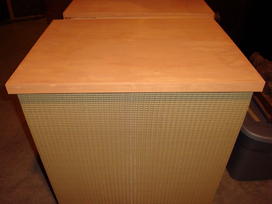

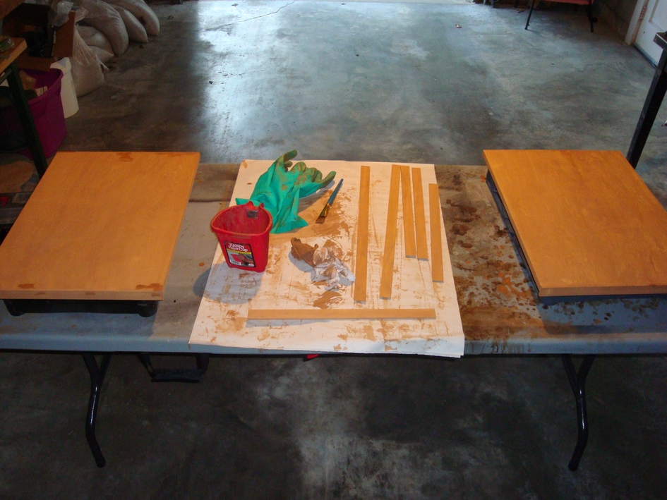

...finish sanding and then staining...
[Image: http://www.philcoradio.com/images/phorum/bozak_026.jpg]
[Image: http://www.philcoradio.com/images/phorum/bozak_027.jpg]
[Image: http://www.philcoradio.com/images/phorum/bozak_028.jpg]
[Image: http://www.philcoradio.com/images/phorum/bozak_029.jpg]
[Image: http://www.philcoradio.com/images/phorum/bozak_030.jpg]
I applied two coats of stain. It's water based so it dried very quickly.
I am very disappointed in the color. I knew it would be more of a challenge since the wood is new, but this is not matching our dining room set at all. Not that that really matters...but that was the color I was after.
And you can really tell where wood putty was applied in an attempt to hide a few bad places in addition to the nail holes.
On the bright side...you cannot tell where I burned through the paper-thin top layer of veneer on one of the tops - the stain did hide that very well indeed.
I am strongly considering spraying all of the parts with Medium Walnut toner and just going with that - I believe, at this point, that that would be closer to the original factory color than this is. Plus, the toner would be better at covering up the splotches where wood putty was applied.
