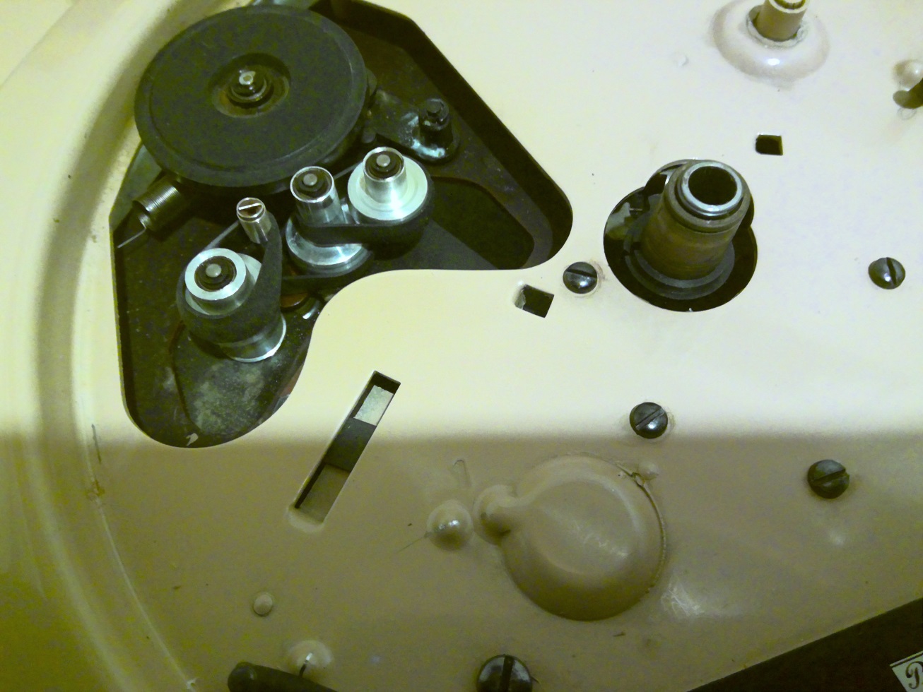

When I took the triangular plate off, I noticed one pin was not held by e-clip, and the grommet did not have the washer on top.. Then I realized it was threaded. No nut.
Then another pin had two washers.
So:
1. Is the threaded pin supposed to have the nut and the washer?
2. What size nut is it. The pins diameters are 3.5mm. Is it M3 or something else?
3. One E retaining clip broke. What size clips are those?

The belt in the photo tries to walk up.
I know there is a thumbnut that can regulate something, which is one of the three posts going through the grommets in the triangular plate holding the motor.
Is this the one that regulates the motor axis angle?
Anything else that could be off?

The nut on the motor holding pins did the job - the belt stopped walking up.
The platter seems to change speeds like it should but there is a loud knocking - it is synced with the visible excentricity of the idler. Like I should be surprised.

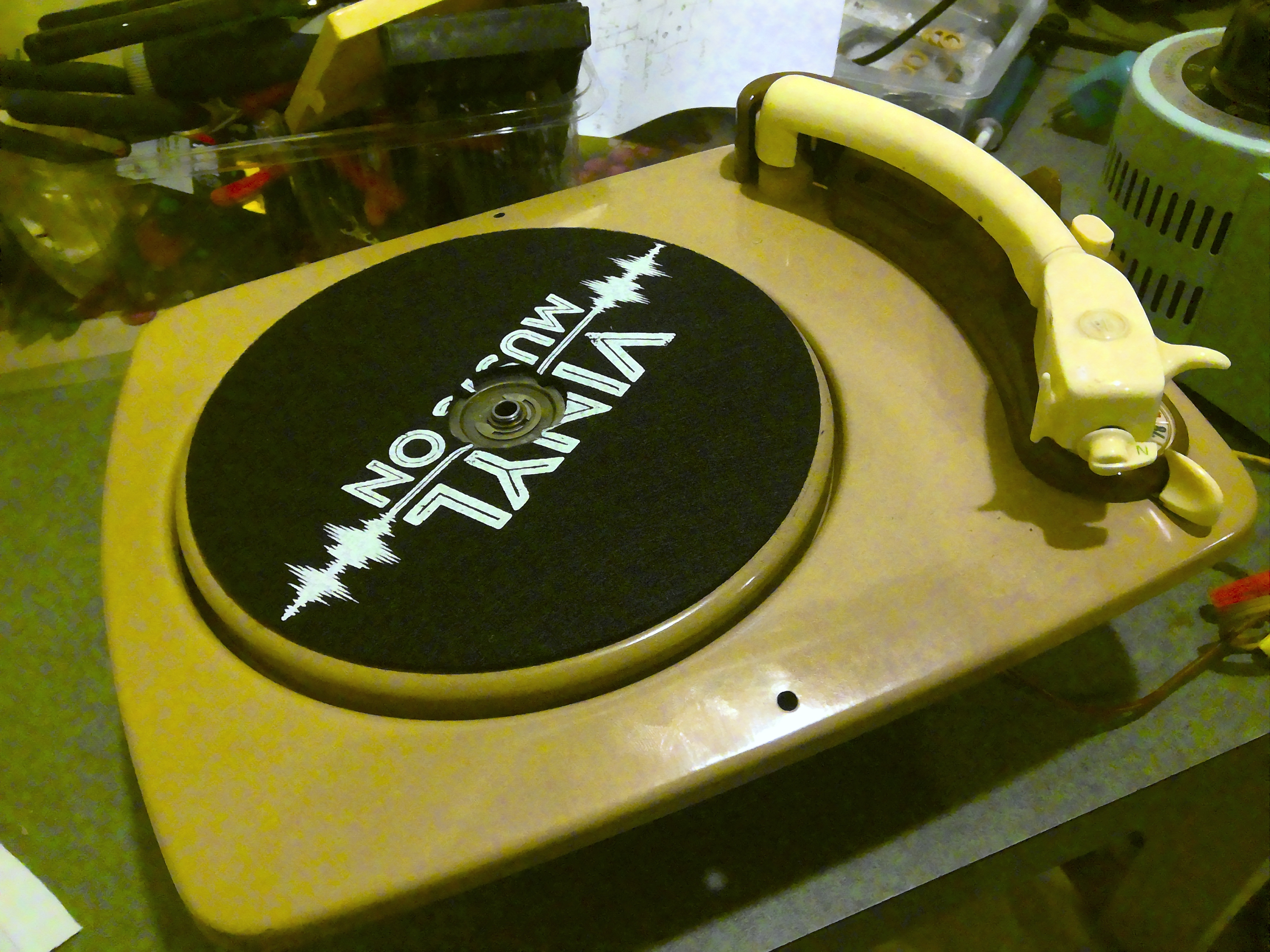

I need to replace that mat. I think I will acquire a second felt mat, cut it to accept the center ring and be done with it.
Then the needles will go in and I will try it.

Here it is:
I cut the bottom for the lower part of the centerpiece and cut the upper with wider circle and the tabs for the upper part.
Not ideal but it worked.
Then I installed 33-1/3 rpm Pfanstiehl stylus, put the changer in the setr, put a record of 1930 dance music on, and turned it on.
It played VERY well.
I still have some mechanical issues of the tonearm not automatically coming to the start of the record, so it goes back but does not turn off by itself and at this point I can manually position the tonearm to the record.
Well, I have the SAMS so I will try to align it. Anyone with experience - some advice is welcome.
I have a video that shows the record and the radio playing, but as I no longer am on the Youtube, I am not sure how to show it here.
BTW, the BC plays marvelously with this radio. I am sure the local "Jersey Shore" station uses the HiFi wide band, but I never got this sound out anything including 38-690. Maybe the equalizer is the reason.
So, I decided to stop, at least for now.
I realized I had to insert the spindle as a bayonet, 'till it clicks, and this made the changer work with the exception of the disk pack holding - I need to glue rubber on that spindle, but if I go for that, it does no longer require for me to take the turntable out - I just have to unlock and pull the spindle which is one twist move.
I thought I had some old square belt but it seems I discarded the ones I had replace. That according to Gary from VOM might work.
Otherwise it drops the record, plays it, raised the tonearm and moves it back and such.
Nice sound. Loui Armstrong sounds real nice.
So....I think for now this concludes this adventure.
