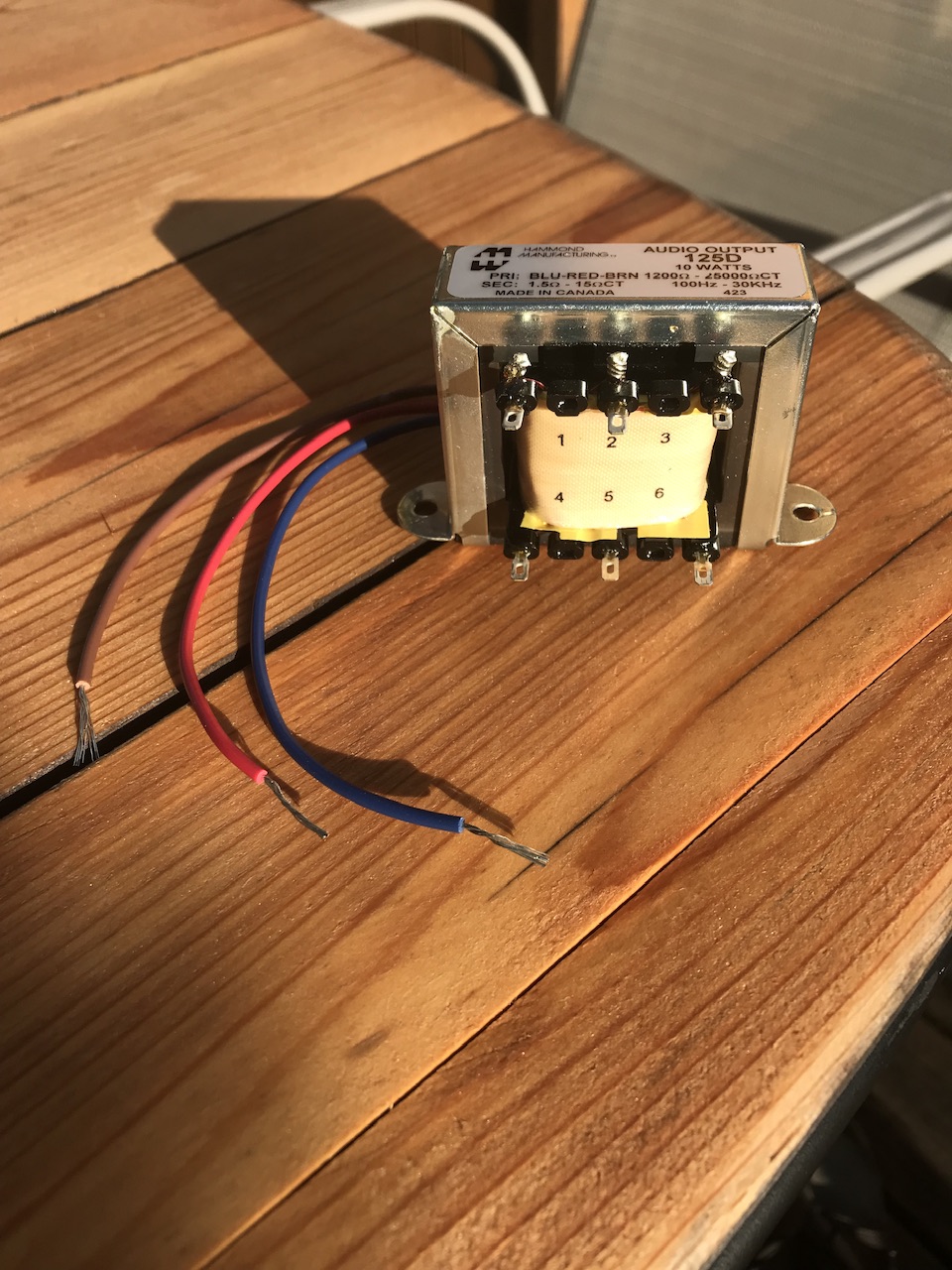

I got the Hammond 125D last night. Just as a point of interest I ordered it from Digikey, a Hammond distributor, in Montreal on June 9th, shipped out of Grand Forks North Dakota the morning of the 10th, thru Memphis and delivered by Fedex last night. Impressive service!
With that being said I need advice as to how to properly wire it up. If you could use the my Pin numbers from previous posts as a guide it would really help. I will be able to attach it to the existing speaker housing no problem but I really don’t want to mess the connections up. Thanks again.

Looks like you'll want to use terminals 1 and 3.

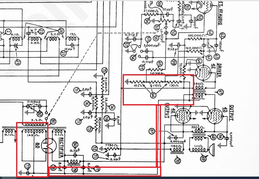

MrFixr55 Wrote:It seems to me that in the 650, the tubes are" cathode biased".
I don't see any cathode bias resistors..

Thanks Radioroslyn but my schematic abilities are severely limited at this time and this is the first time I’ve replaced one. I have read the pdf file but that doesn’t help me. I would need a more detailed picture of what needs to be done.
I would need almost a “hold your hand” approach …connect the red here, the brown here, the blue here etc.
I hope one of the learned members doesn’t mind taking the time to lead me thru this. Once I’ve done it, I will learn the process and be able to trace it thru the schematic but in the interim I will require more specific advice.
#71
Ok the red wire connects to your #2. It's the center tap of the primary. On the Philco transformer it also connects to it to field coil (yellow wire). The brown and blue wires connect to #'s 3 and 4. They go to the plates or the 42 tubes. The two connections at the bottom are for the voice coil. They go to terminals 1 & 3 on the top of the new transformer. Your terminal 1 is a tie point to connect the field coil.

Though the cathodes are grounded, there is something more negative than ground.  Resistor # 66 in the drawing goes from chassis ground to the center tap of the B Supply secondary, making the B supply center tap the most negative point in the radio. Note also that the driver and 1st audio stage get their grid bias off the same tapped resistor. Note how the 2 main filter cap negative terminals do not go to ground but to the B supply secondary center tap.  Although it looks like fixed bias, variation in current draw will vary that voltage.  This is why I am calling it cathode bias.  Newer radios usually have chassis ground as the most negative point and resistors from that point to the cathodes of those tubes that require bias. It may be less complicated and cause less hum that way.
See the annotated pic below:

MrFixr55 Wrote:Newer radios usually have chassis ground as the most negative point and resistors from that point to the cathodes of those tubes that require bias.
Yes, and that is called self-bias or cathode bias. What the 650 has is fixed bias, derived from a point in the power supply which is negative with respect to the grounded cathodes.
Some variation in the fixed bias voltage always occurs in the ways in which it is normally implemented in consumer equipment such as the 650. That is why commercial equipment using fixed bias (such as the broadcast equipment and instrumentation) that I have worked on for more than 50 years generally uses a separate bias supply.
Self-bias (aka cathode bias) has its own drawbacks where varying plate current causes varying bias.
I do not expect rock-steady bias in any consumer equipment - providing it costs too much.
