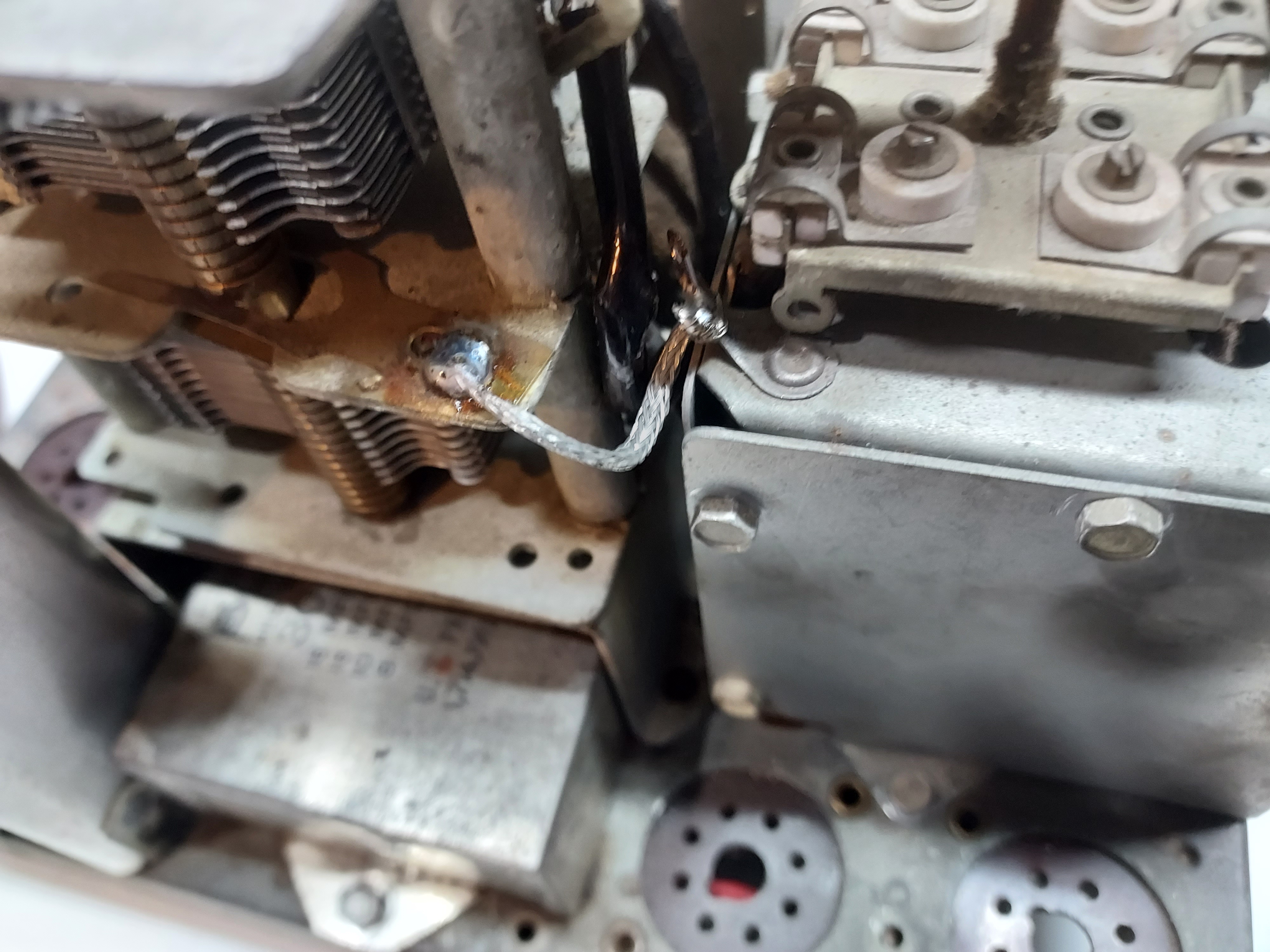

Now I think it is ready.
I had some braided wire, so I used the braid instead of the broken one, connecting the tuning cap to the chassis.
All assembled:

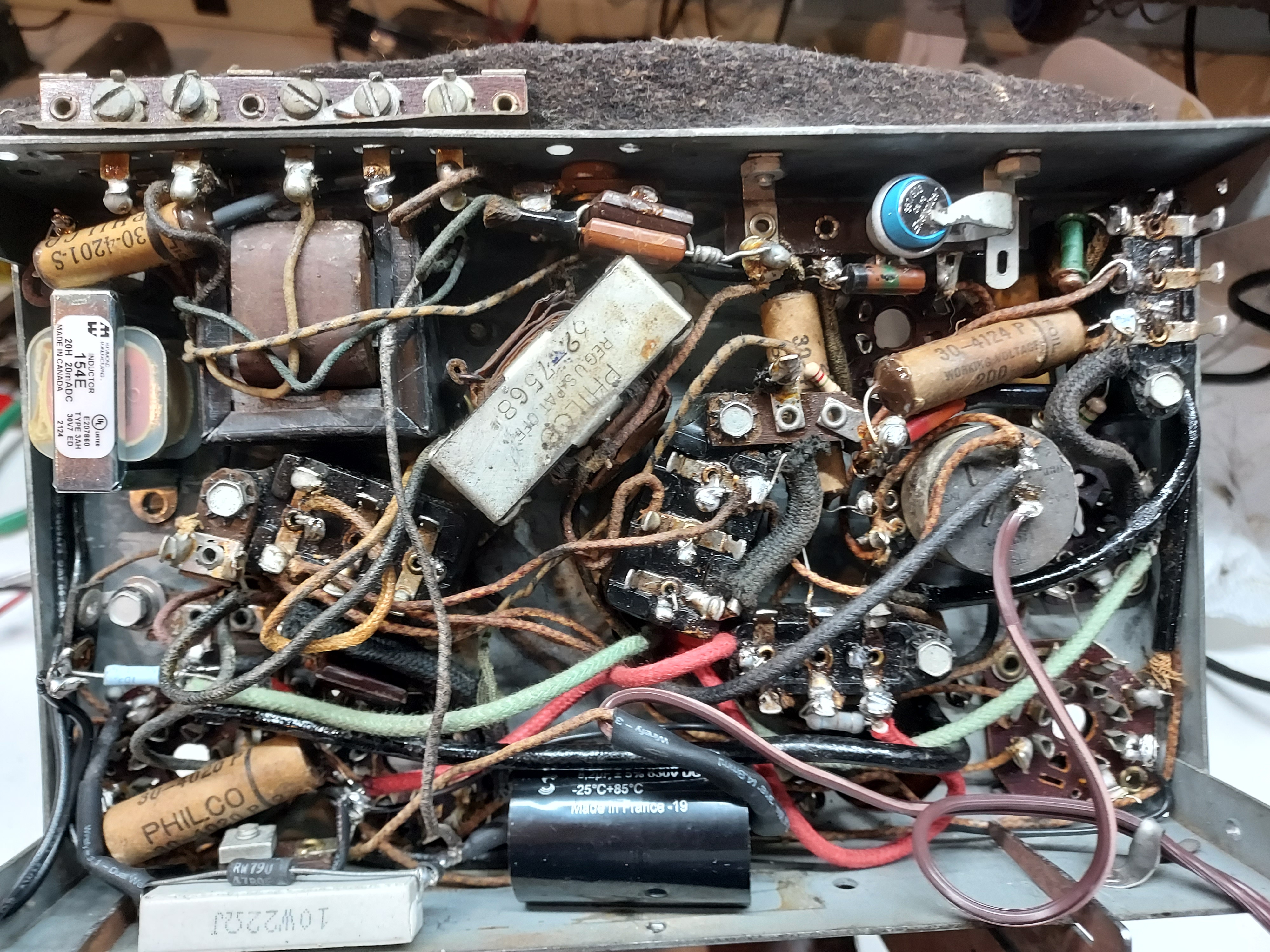

I also forgot I still ahd the cap from the volume pot wiper not installed. At the same time I remembered I did not check the AVC resistor, which turned out to be over 6M vs 2M required; it also got replaced.
All done now.
Possibly will try power-up tonight.

So, I put the wires back to the power switch, plugged it in, slowly increasing the Variac output...nothing. No DC, not even AC.
Eventually, after 5 minutes, I remembered that some plugs, if fully inserted into my Variac (bought new, but, well...Chinese) do not make contact, so I pulled it back a little bit.
Briefly saw the AC, then checked the DC voltages on the caps, then I pretty much rotated the tuning cap and pulled in the local station.
Here's the video.
https://www.youtube.com/shorts/PcZLxpJqnr4
It's a start.

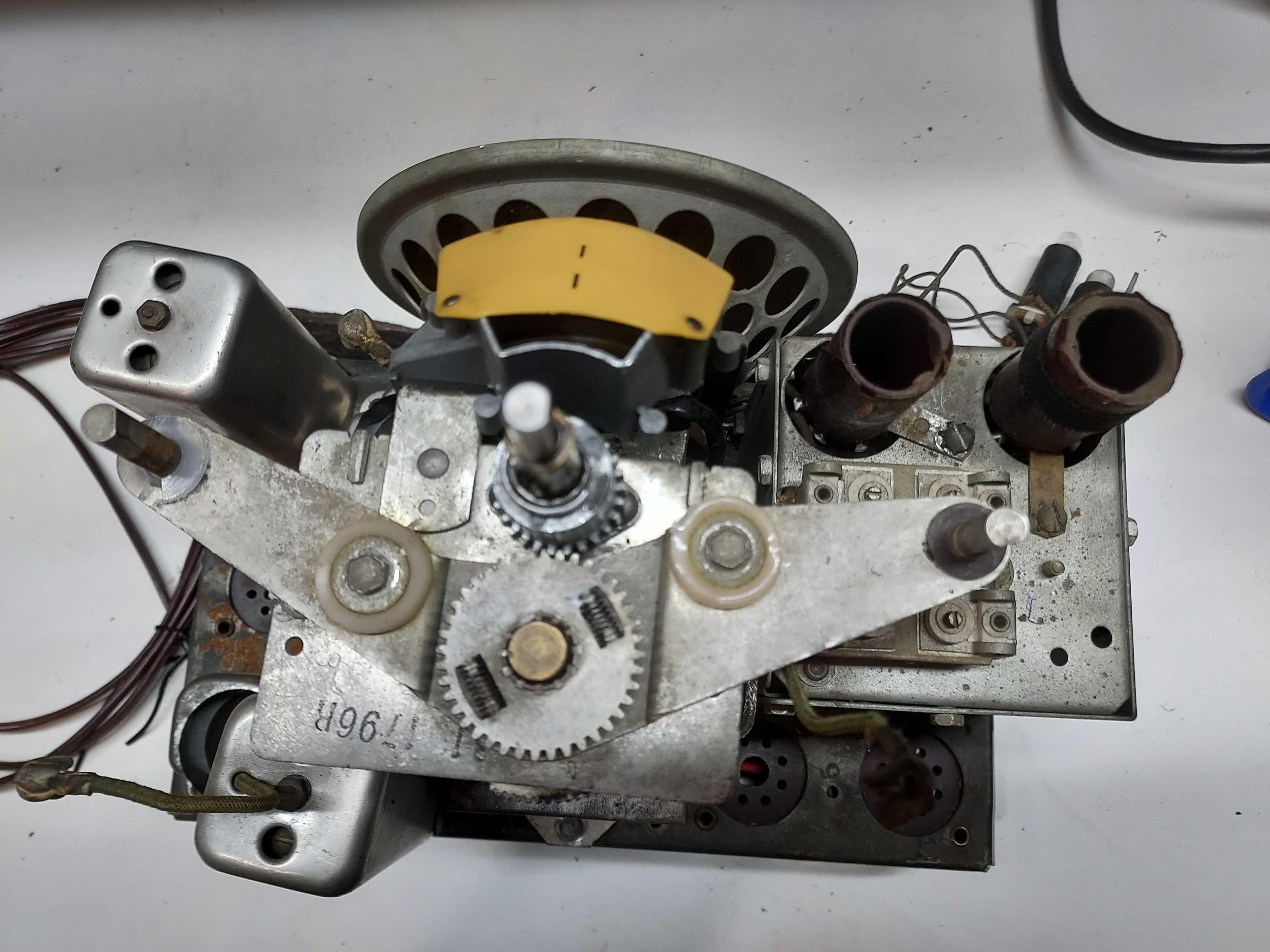

Well, now it is the pilot lights.
The two bulb sockets, of course, have disintegrated inside.
It would be not too bad to fix the wire/spring assembly, but both sockets were riveted, or, rather, used an eyelet to hold to the bracket that held them to the dial assembly, and those came apart also.
They were flared really thin, so when I was taking the bulbs out, the flared part easily separated.
Now I have a dilemma: either to look for eyelets (will go to Michael's tomorrow) or try to fit all new sockets.
