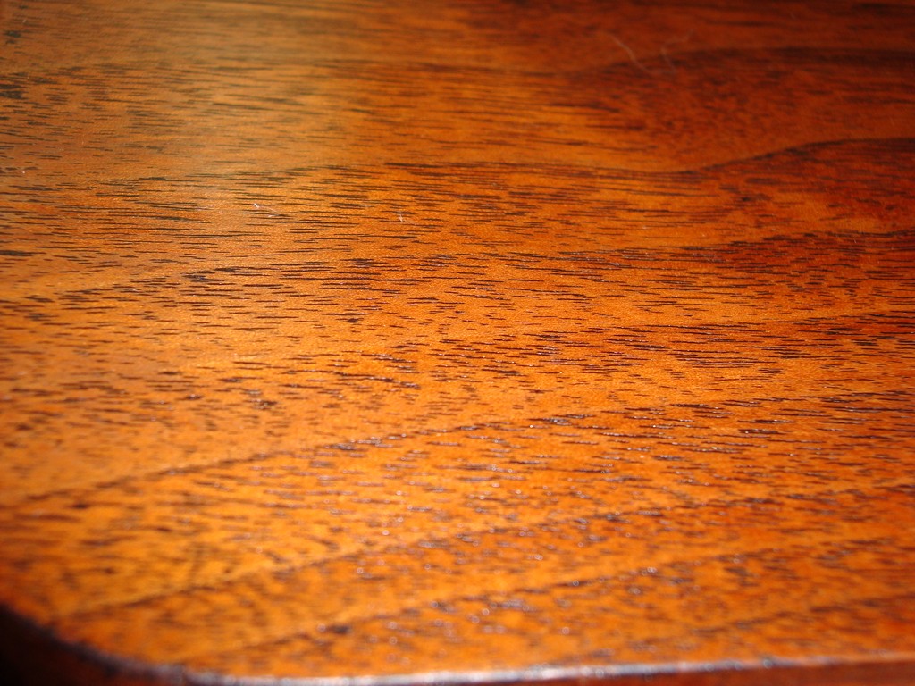

Ron's Cabinet Work for the 2012 Season
And here's the proof:
[Image: http://www.philcoradio.com/images/phorum..._00001.jpg]
Ignore the whitish-looking, out-of-focus pores in the foreground, those are artifacts from the camera's flash. All of the pores on the top of the cabinet are now dark, as you see in the middle of the photo above.

Yes, much better.
M R Radios C M Tubes
Posts: 5,650
The grain fill on that Tropic looks correct now Ron, the grain fill on the still original parts of my 42-327 is the same colour and it's from the same era. By the way, have the patches disappeared between the sanding sealer and grain filler?
