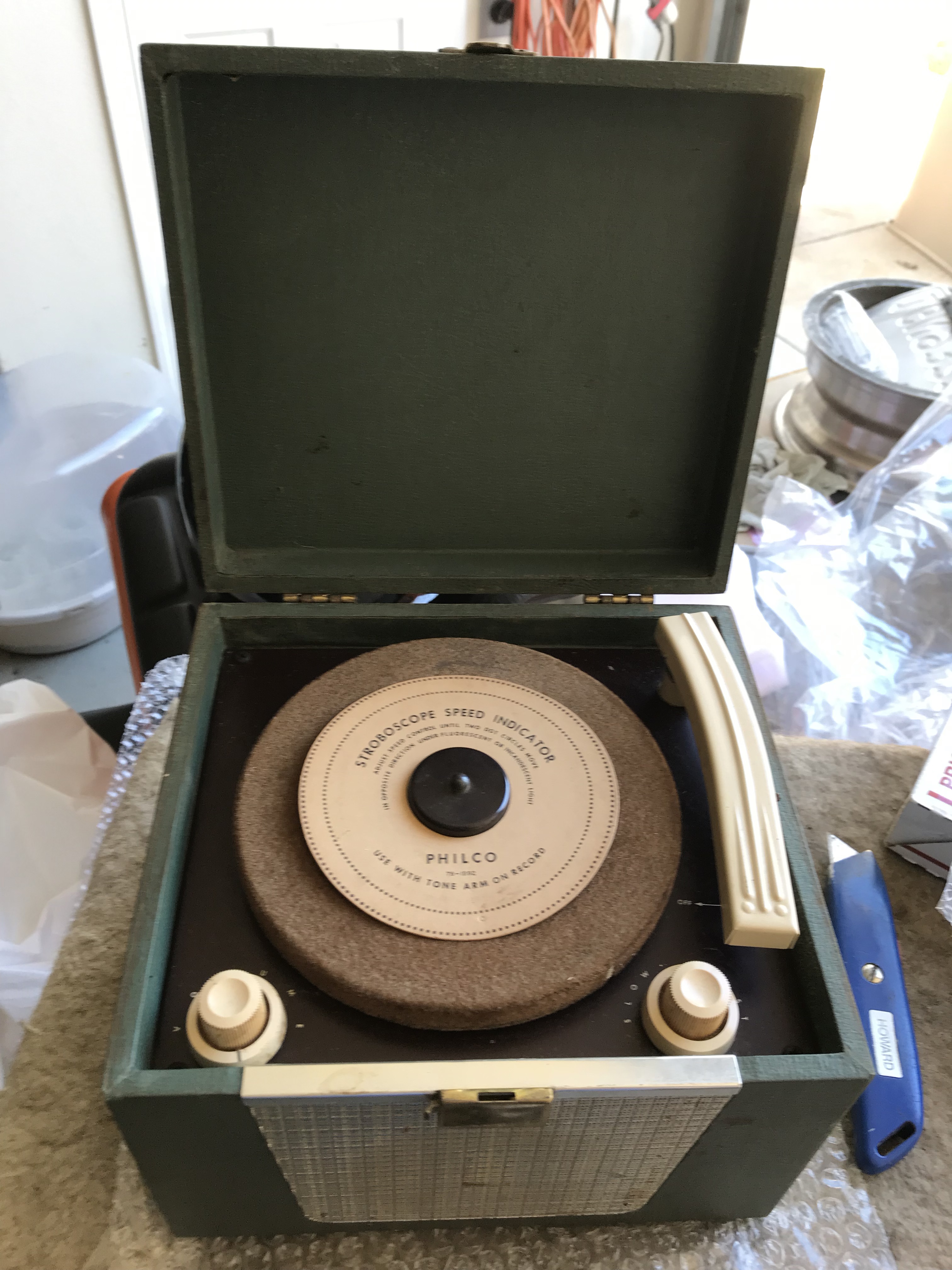

Hi, I just received my eBay TPA-1 score.
It seems to power the amp up, makes a nice click anyhow but the turntable spins free and I couldn't detect any motor sound- so wondering if the platter comes off from the top, or what? If someone else has one that could post a picture of your battery cover I would appreciate it, but seems to be a simple part to make picture is out of focus, need to clean it up and reshoot!
Battery terminals look fine [Image: https://antiqueradios.com/forums/images/..._smile.gif] 65+ years of dirt and grime but except for a couple minor corner scuffs should clean up nice!

It was 5 or 6 yeas ago so I don't remember.
Best access is from inside.
This thing is rare so the only two cases I know of are on ARF forum.
I doubt anyone here has it.

the plastic cap just pulls off and the usual snap ring, but not sure why the motor isn't getting power or isn't turning if it is getting power, I cross posted as well but need to finish the wayward marantz 15 before I use the bench space to open it further. Also need to replicate the battery cover, shouldn't be real hard, maybe clear plexi :-)
Test the motor. DC resistance etc. If no power simply trace wires.
Its all very simple there.
Also check the potentiometer that regulates speed, maybe its bad.

I just started making a battery cover for mine, it looks like they used some wood screws or something to hold the cover on thasty are stripped out or drilled out on one side- I think some kind of "T Nuts or something would go good there- also what's with the selenium rectifier, was it ok to keep using on the one you worked on or maybe a 1N00X? Time to check the pot for my motor failure issue.
Thx,
-Bob
What rectifier? TPA1 is strictly battery portable unit.

it's for spike suppression, in series with a 10 ohm resistor across the motor, found the schematic of the whole unit, probably more effective with a silicon diode or even a germanium maybe with lower forward voltage drop- not sure what Vf is with a selenium?
It's been long time since I looked in the sch.
If this is how it's conencted then yes, probably for start/stop spike suppression.
Vf of selenium rectifier is about 1V/section so if you have say 4-section one you will see about 4V drop.

This one has worse problems, I can see variable voltage on the motor leads but no turnny :-( If I take the motor apart not sure where that will get me without trying, and then I'll want to pull the amp out and make it a display model- I mainly wanted the amp anyhow but it would have been nice to see it work. Dad gave me an amp like this back in '56 with some other stuff to make some sort of an experimenter kit when I was 6. I wasn't nice to it :-( I loved the potted transformers and those little plug in transistors!
