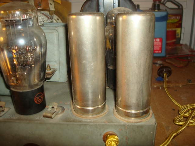

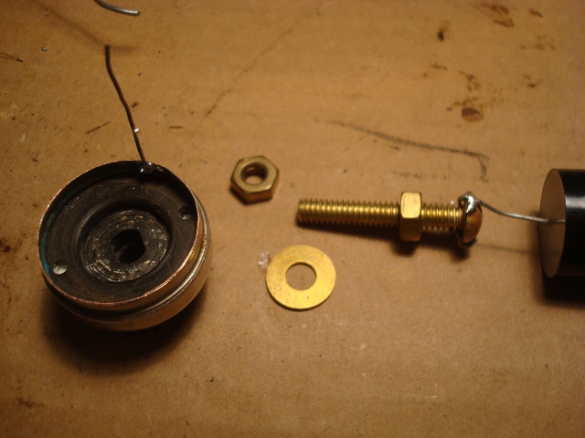

Here are the pics of my electrolytic cap rebuild. I put some thought and time into this one, took some ideas that were mentioned, and this is what I came up with.
I showed the disassembly in an earlier post. I used a propane torch to heat the bolt. It came out after some gentle rocking and pulling. It did not damage the threaded area. I cleaned up the rubber gasket, then used a brass screw, soldered to it, then put together.
The outer can slipped over the base, and I used 3 little dabs of JB quick to attach. So far, I havent broken them off. I think I can heat and remove if I need to replace the cap sometime. I did have to make sure I had the metal cans lined up with the ground strap. I cleaned both and checked for continuity. It looks factory from over and under. I didnt have to change any wiring. Here is the finished product.

Tim,
Excellent. Neat idea with trhe bolt also.
Just watch when you tighten it so the whole thing does not twist.
BTW what cap is it that you used here to stuff it? I mean, type, year and mfr.
#64
So far, things seem solid. The cap I used is a Solen Fast metalized polyprop 6.8mf, 630v. non polarized. It is made in France. Cost $4.50 from AES. PART # C-FS6D8-630. I did this on the reccomentation of another member (Greg I think). It is working fine.
