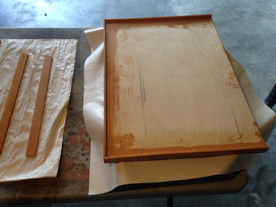

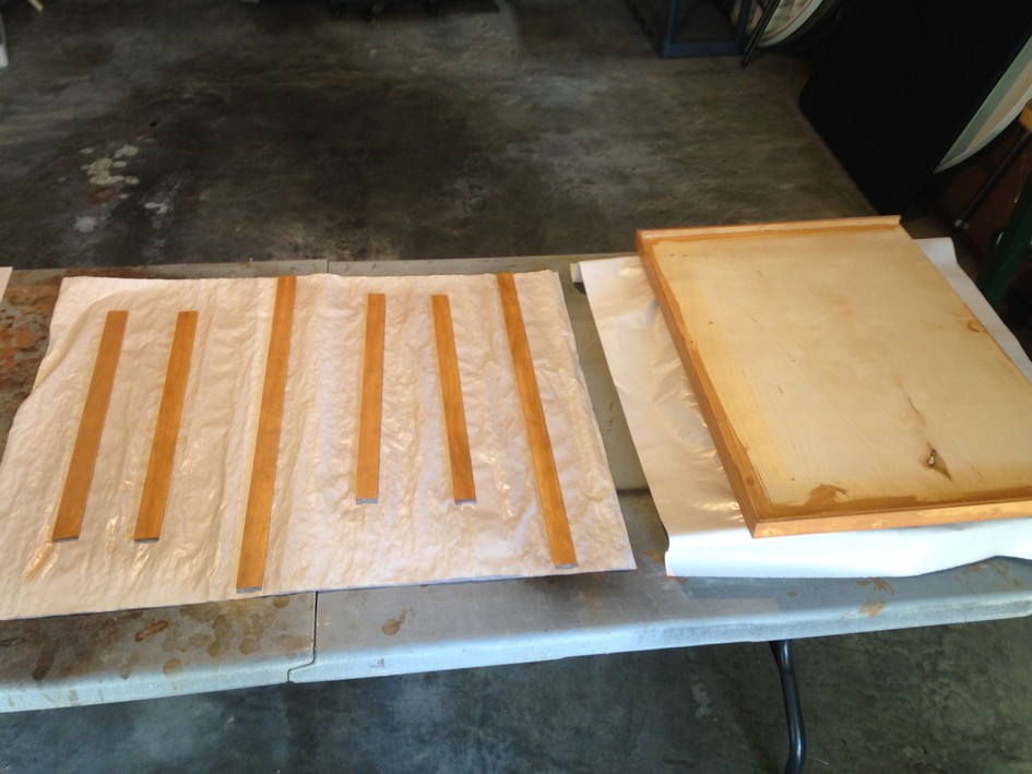

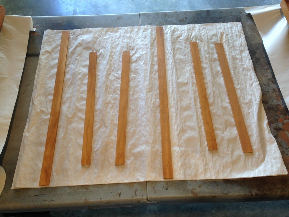

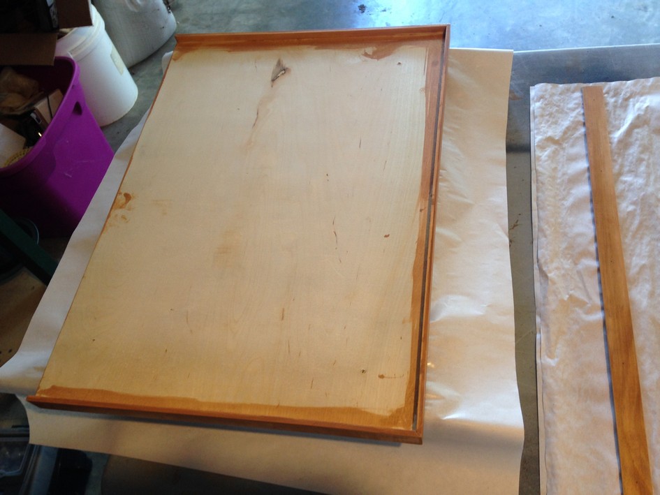

This is how things looked after the trim pieces and the underside of the top trim received two coats of clear sanding sealer, and before I wet sanded the pieces with 800 grit wet/dry sandpaper, leaving a very smooth surface on everything.
Since then, I have sprayed two thin coats of toner on all of the bottom trim as well as the undersides of the top trim attached to the tops. It's going much better this time, and I'm trying to be more careful.
I will apply one or two more coats of toner, depending upon how things look after the third coat, let dry for awhile, then flip the tops over and repeat the sanding sealer/toner procedure on the tops and the outer edges of the top trim.
Okay!
Three coats of toner were enough for the trim. I am very pleased with the color now. And this time, spraying carefully, the toner did not run down the edges as it did before.

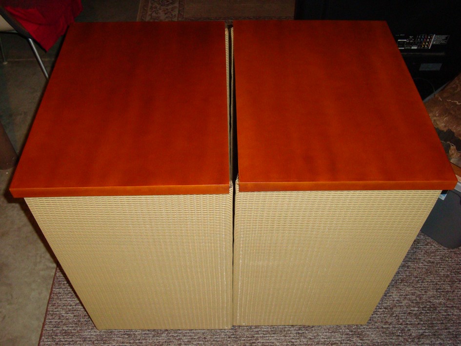

Once the tops were dry to the touch, I took them inside and set each one on top of its respective cabinet.

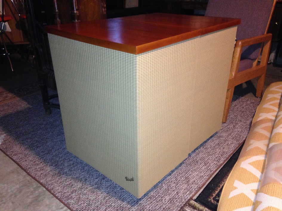

Here's a photo, with the cabinets sitting back to back:
[Image: http://www.philcoradio.com/images/phorum/bozak_037.jpg]
They aren't 100% perfect, but I think they are turning out very well indeed.

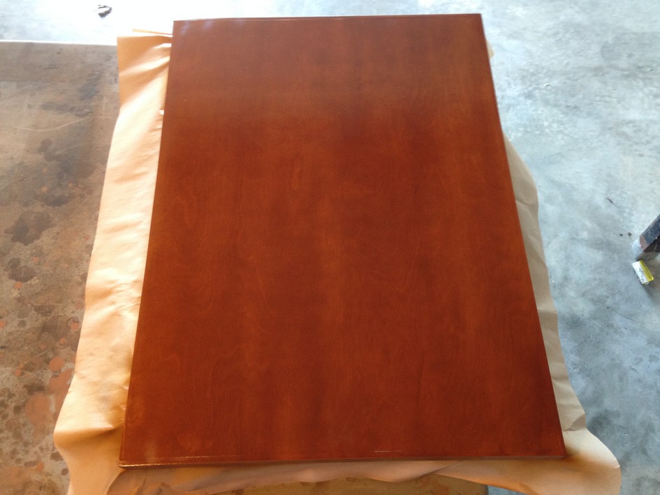

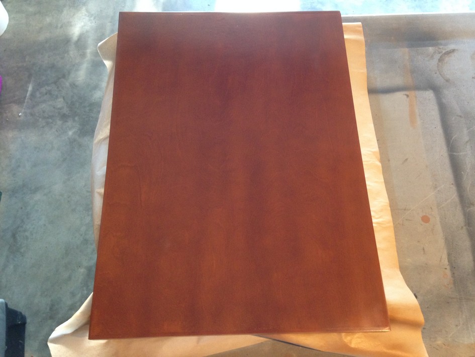

When I went back to the garage to bring everything back into the basement, the blushing was all but gone from the tops!
A little later, the tops do not show any blushing at all...
[Image: http://www.philcoradio.com/images/phorum/bozak_038.jpg]
[Image: http://www.philcoradio.com/images/phorum/bozak_039.jpg]
Whew! That's a relief!
