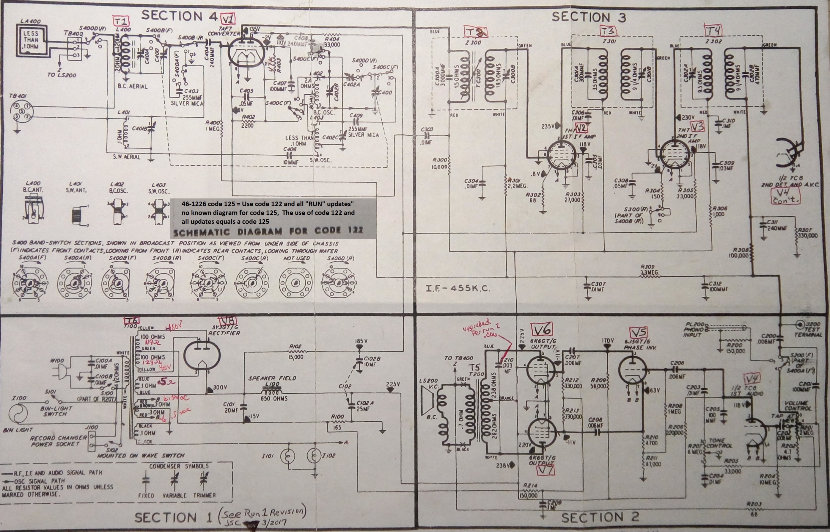

now that i have pri /sec sorted,, lol, my secondary seems to be shorted,, less than an ohm.
#77
Secondary should read less than an ohm.
It is shown on the schematic as 0.1 ohm, but depending on the resistance of your test leads may read a few tenths higher.

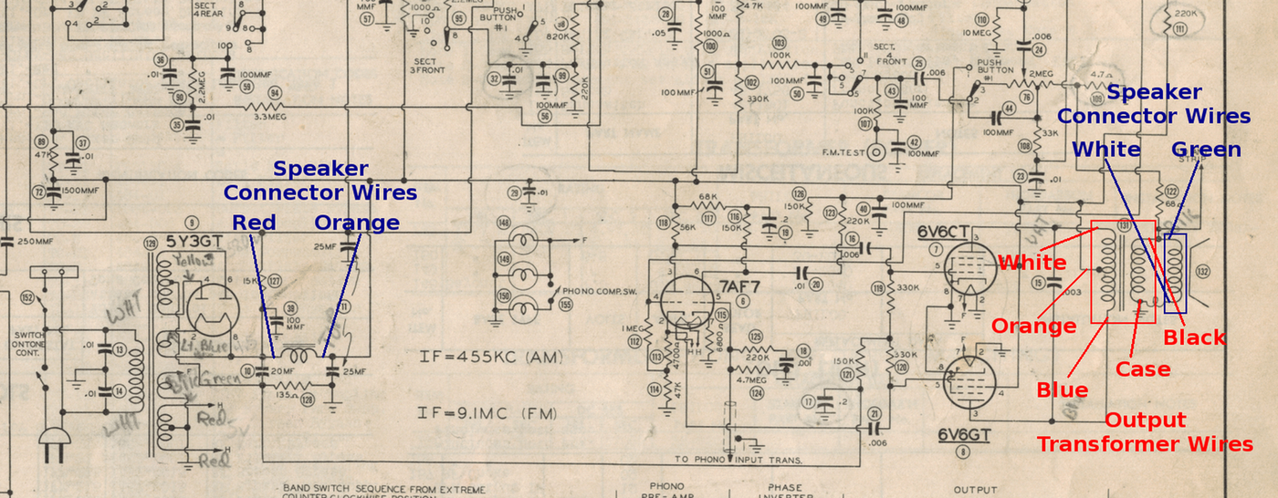

It sounds like you may have things figured out, but in case it helps...the wiring looks very much like my output transformer.  Here's how I marked up my schematic.
Rich

my schematic i posted says the secondary needs to be 7 ohms.... i measured less than one ohm
#81
Riders sez .4 ohm. Moot point anyway as the primary is bad.
#82
No it says .7 ohms.
#83
i thought it was point 7 as well, i compared the other "dots" used as a period in other areas of the prints and each dot is dark and a larger size.
with that i mind, i concluded it was a straggler ink smudge from either the photo copier or whatever. its font size isnt the same as other dots,, but,,, now i will call it .7ohms,,

gutted out my secondary winding of my audio output transformer to get access to the primary blue wire terminal. , found the main wire to the thin hair broke and some corrosion.  Was glad to see that and made a repair.
No change in resistivity from org to blue so theres another break somewhere.  My meter isnt showing a steady reading,, its slowly increasing like before.  as said,, bad primary.
up on post 72, there is a pic of my audio output transformer
the pn is 32-8274
primary with center tap
blue to org supposed to be 238 ohms at 225v
white to org supposed to be 262 ohms at 238v
secondary , one bonded to xfrmer chasiss and one which is called out to be green is to be .7ohms.

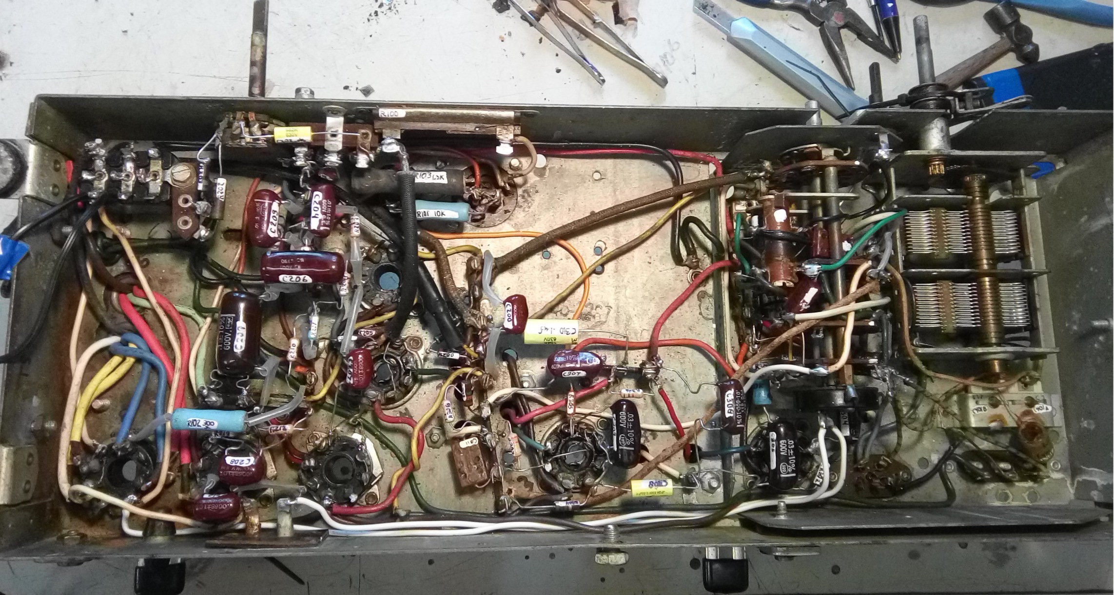

couple progress pics
Man was that tuner knob section about as fun as watching paint dry.
as i said, waiting on my audio transformer.

also, when i rotate the tuner knob,, i seem to hear scrapping,, arent they supposed to be quiet? .. i cant see any bent metal fins.
some pics...
