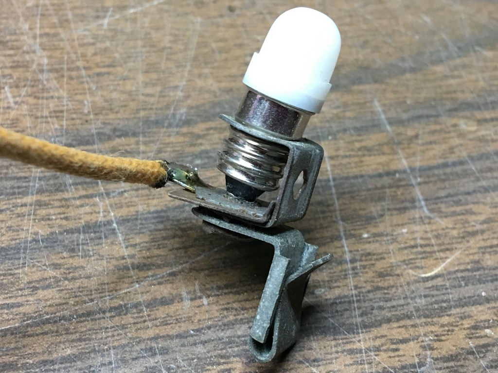

I didn't go the LED route on mine, just used the standard bulb.

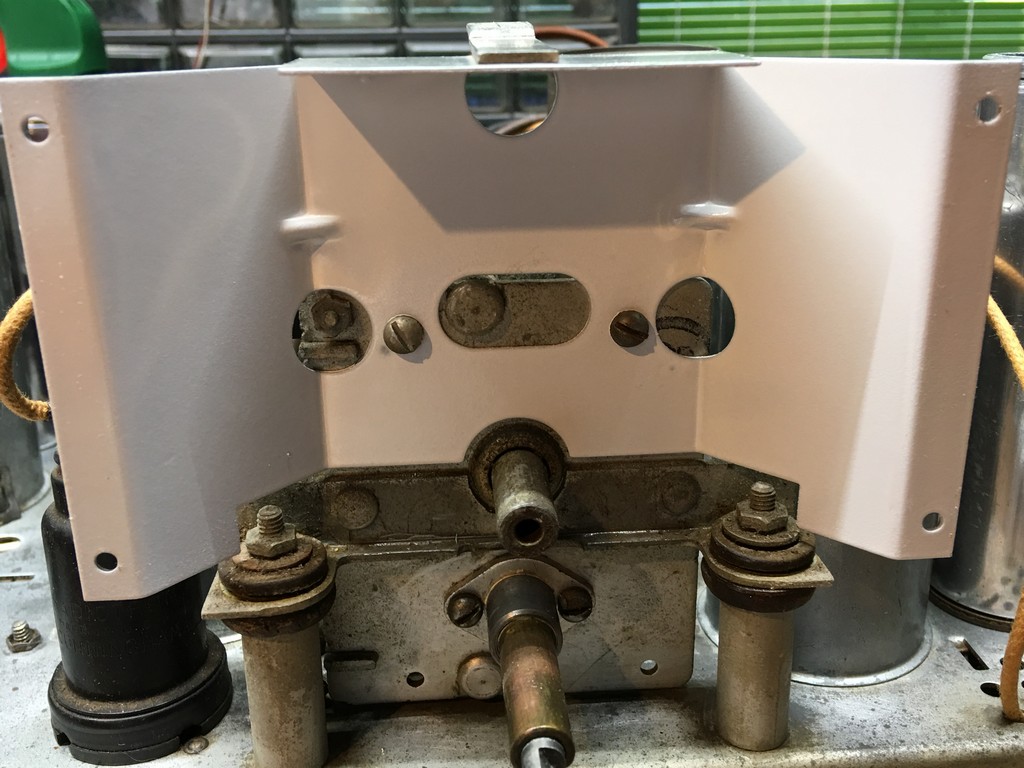

As long as the backplate has white paint on it, it will be perfectly fine for reflecting. Doesn't require a perfect paint job, as it will never be seen once the dial is in place.

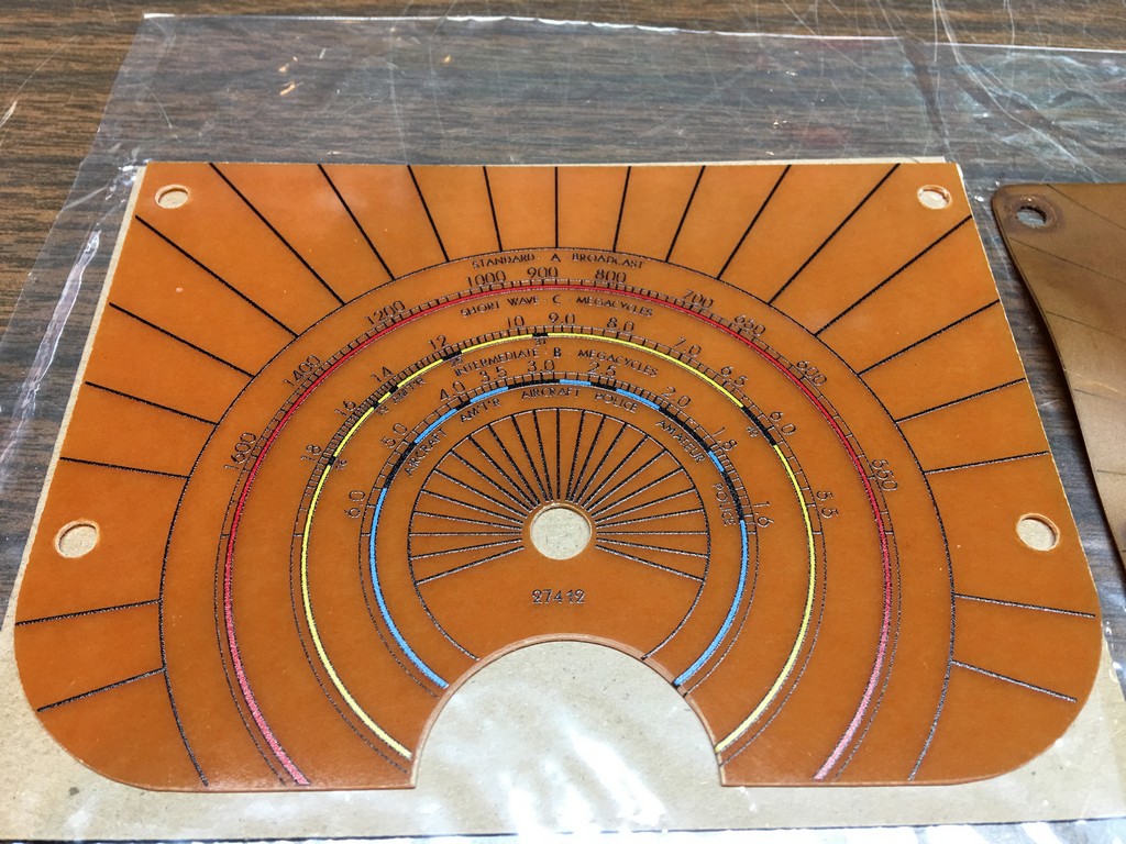

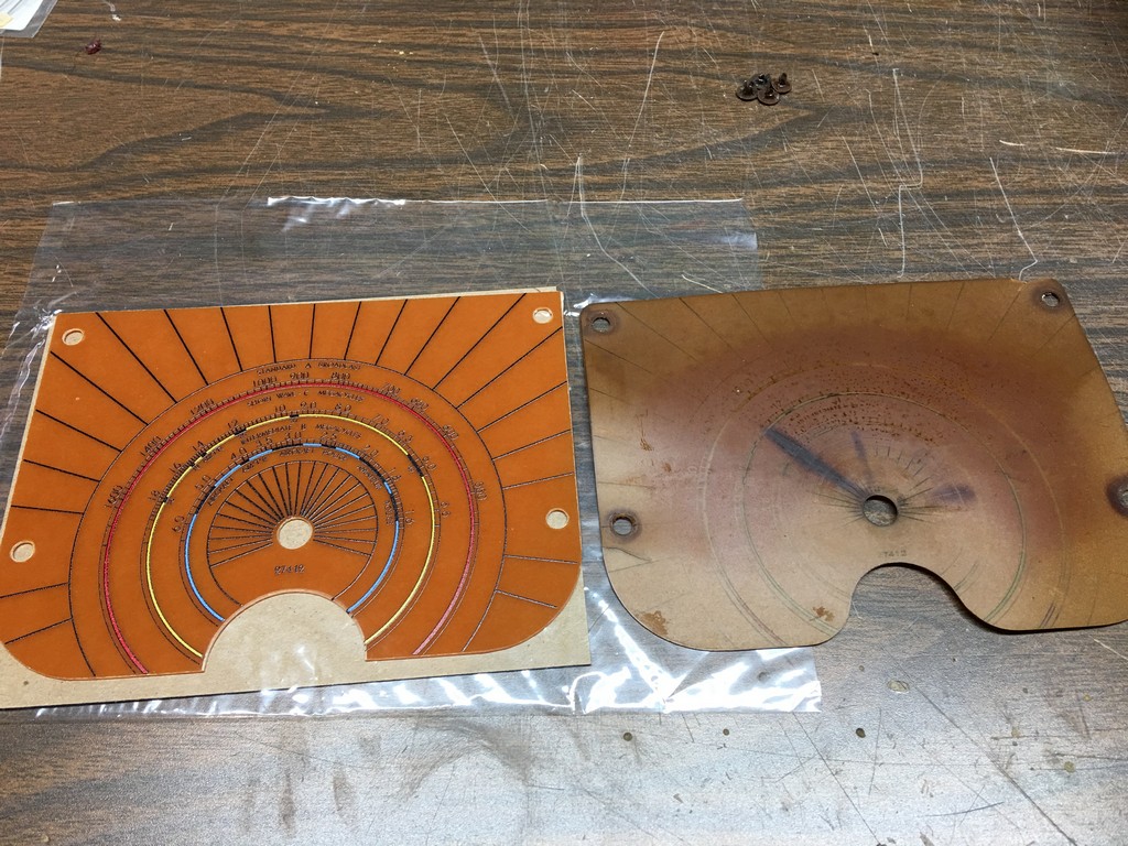

Comparing the new scale with the old:
[Image: http://www.philcoradio.com/images/phorum...-5_064.jpg]
The new scale isn't cut exactly the same as the new scale, but it does not matter as the outer edges will not be seen when the chassis is in the cabinet.
A closer look at the new scale:

Here is the repainted dial back plate:
[Image: http://www.philcoradio.com/images/phorum...-5_066.jpg]

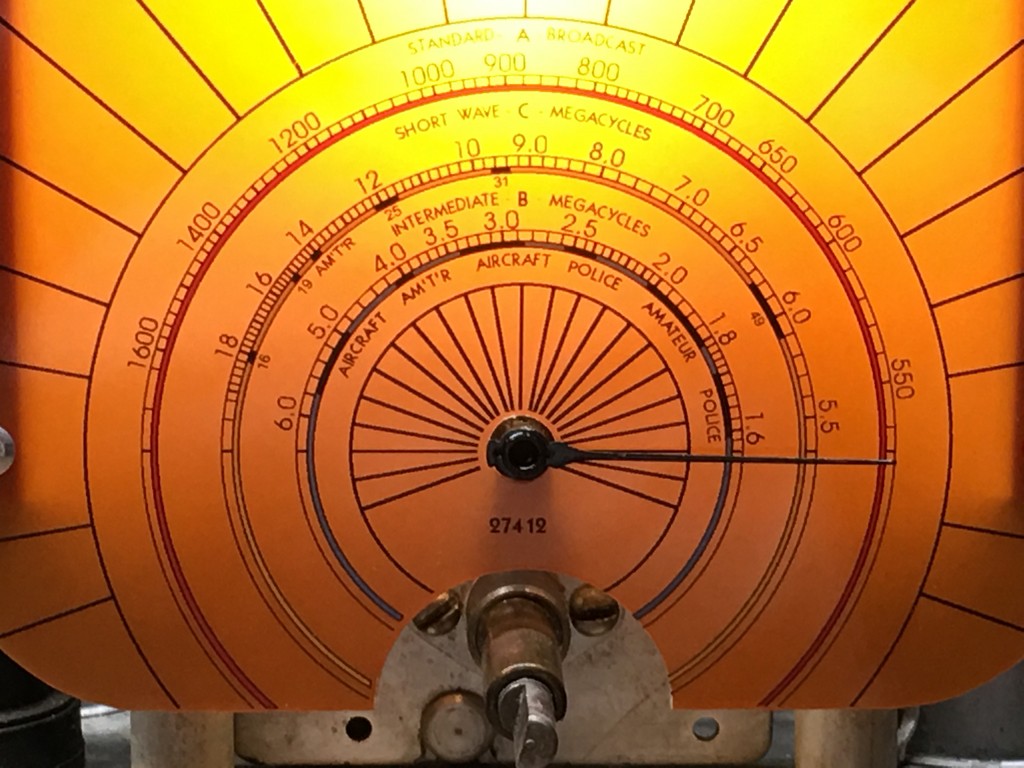

Greg, I decided to take your advice and use pop rivets to hold the new dial scale in place.
[Image: http://www.philcoradio.com/images/phorum...-5_067.jpg]
Looking good...I think...
So I removed the 80 rectifier tube and applied power.
[Image: http://www.philcoradio.com/images/phorum...-5_069.jpg]
[Image: http://www.philcoradio.com/images/phorum...-5_070.jpg]

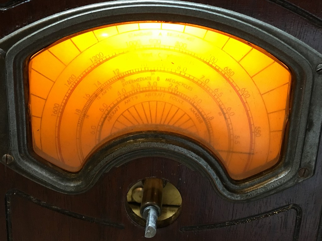

It looks much better than this "in person". The camera makes the LED lamp look much "hotter" than it really is. The gloss white paint on the back plate really helped with light diffusion. It is brighter at the top, of course, but the dial is well illuminated overall - again, not overly bright on top as these pictures seem to indicate.

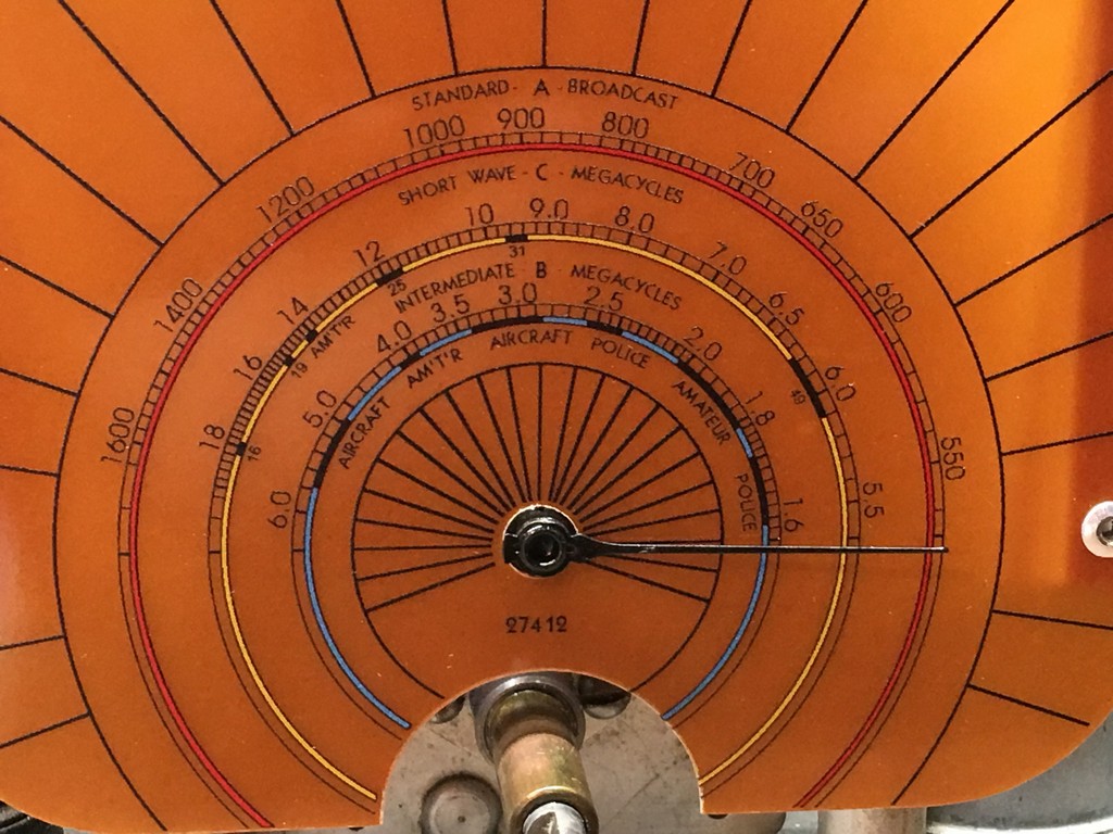

A close-up of the new scale with the power off:
[Image: http://www.philcoradio.com/images/phorum...-5_071.jpg]
I put the chassis back into the cabinet until I am ready to repair and refinish the cabinet - hopefully, before this summer is over.

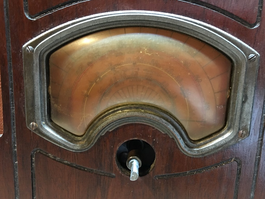

You can see below that I really do need to get that dial cover ordered.
[Image: http://www.philcoradio.com/images/phorum...-5_072.jpg]
[Image: http://www.philcoradio.com/images/phorum...-5_073.jpg]
John (Eliot), you had asked about the LED lamp I used. I don't remember where I bought these lamps!  It wasn't from Pinball Life - they do not carry this bulb with a miniature screw base. All I remember is that I found them online somewhere, they were more expensive than the Pinball Life lamps but not too expensive, and they light up nice and bright. A bit brighter than a #46 incandescent, but not too overly bright. I like them
[Image: http://www.philcoradio.com/images/phorum...-5_068.jpg]
Edit: I think I just found them:
https://cointaker.com/products/1482
They come in "White" (bright white) and "Warm White" (white with a yellowish tint, more like an incandescent bulb). I have the Warm White version to mimic the look of an original #46 lamp.

That new dial scale looks great, Ron!  That's exactly how I installed mine. Yes, using pop rivets is a more permanent way of attaching it, but you really shouldn't have to take it off again. If the bulb goes, it comes out from the backside.
I just wish RD's repro dial scales weren't embossed like that, with the lettering raised. But hey, that's just a minor thing. Certainly better than not having any or a badly faded, darkened original scale.
Yes, you probably could try polishing the (once was) clear dial cover. I actually tried that on mine, but it never got very clear and the yellowed hue still remained. You're better off to bite the bullet and buy a new one. It will only enhance the eye candy of the new dial scale, bright white dial back plate, and LED bulb. You won't regret it...especially enjoying the radio in a darkened room at night!
