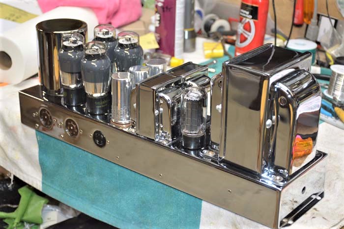

Finished except for an AC cord and testing the tubes.  All electro and tubular caps re-stuffed.  6 resistors in the biasing for the 6L6's  were changed.  Now to get the tuner chassis re-chromed.

You wasted no time getting the power supply back together, that came out beautiful. Icon_thumbup

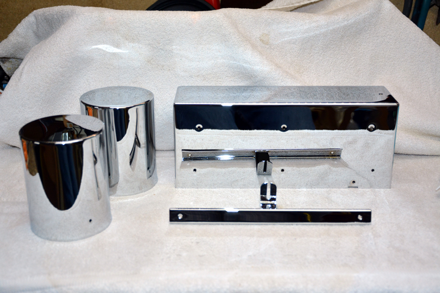

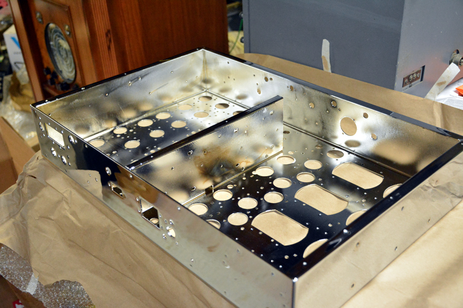

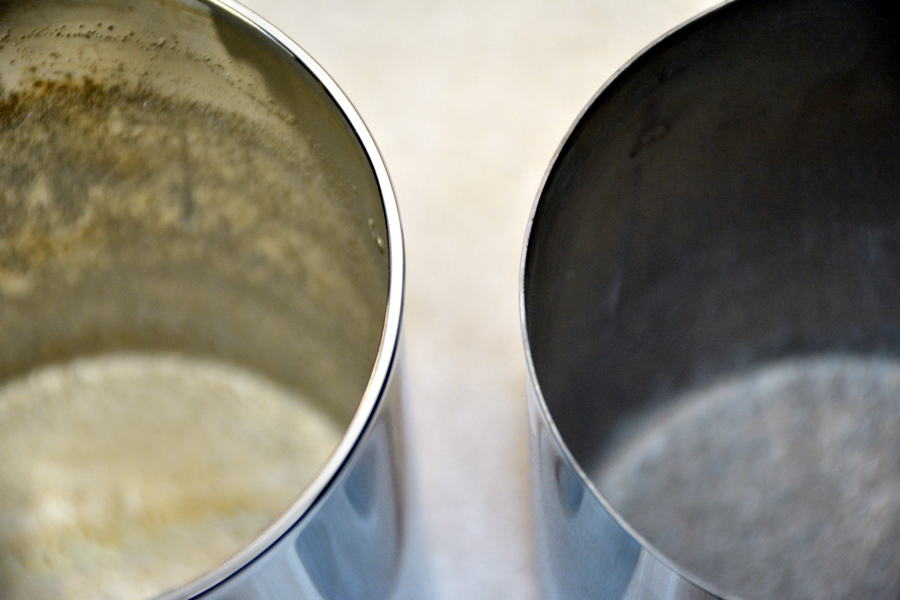

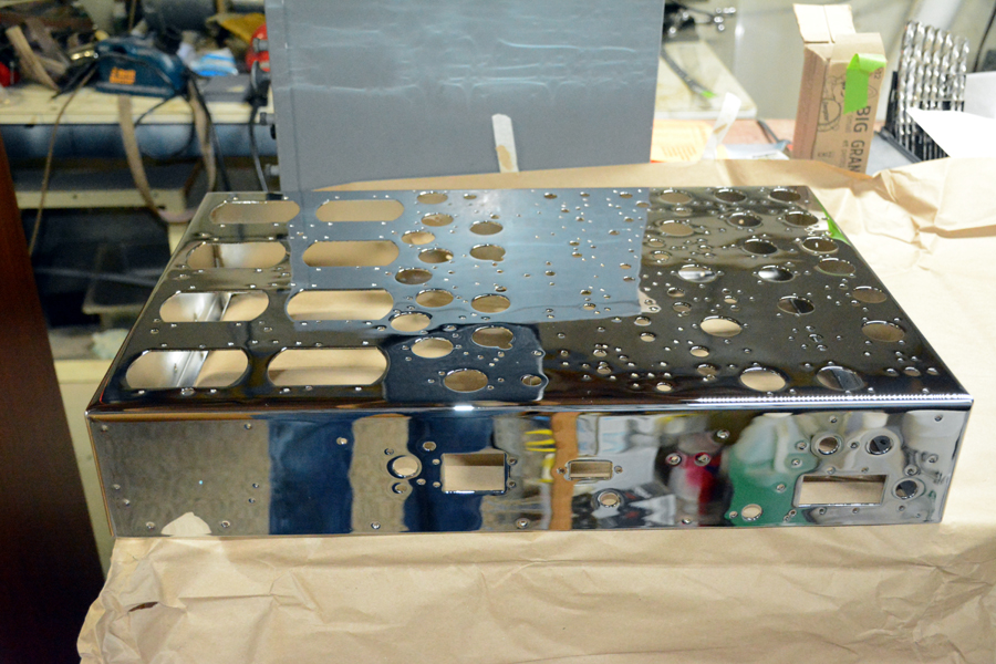

I finally got the tuner chassis parts back from Advanced Plating in Nashville.  They look great!  I sent them 2 of the very thin coil covers to see hw they would come back.  They look fantastic, but they sure had to add a lot of metal to them.  I hope I can make them fit as the thickness is substantially greater.
Ron, this is your old radio.  I hope you approve!!  Now the real work begins.

Wow, several old threads resurrected.
The chassis looks grand! I can only imagine what one feels when having completed the work and firing up this beast, all shiny.....in the back Icon_smile

Thankfully EH Scott usually put a hinged lid on the console so that the chrome could be seen! Otherwise I'd have to put the radio on a turn table.

rfeenstra Wrote:Ron, this is your old radio. I hope you approve!!
Are you kidding me? It's beautiful! You know, I sort of regret selling it now, but what's done is done. And you are doing a great job with it. Maybe one of these days I can get myself a nice Allwave 23 in a Tasman cabinet.

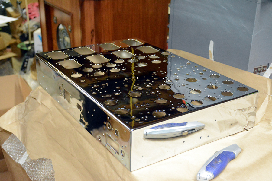

The chassis is literally better then new, and I mean it! In spite of the touted pedigree about Scott radios, especially by Scott themselves, I think most of their chassis were flash plated with chrome, no triple plating with copper, chromium, and nickel.

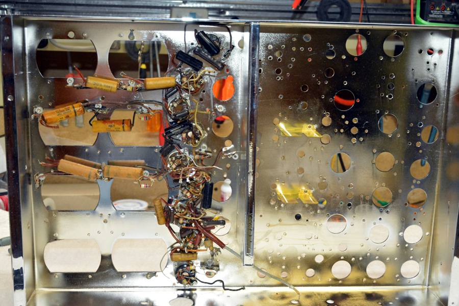

Reassembly has begun.  I started with the RF section, riveting all of the tube sockets and terminal strips back in.  all of the resistors are just out of tolerance so i will replace all of them.  Caps will be re-stuffed.  Some were changed previously and I can't re-stuff them so I'll find others to substitute and re-stuff.  I'll check the micas as best I can.  while it seems I can get a good ground to the chassis under the rivets, I'm a bit concerned that the plating could present a problem in the future so I am running around wire to all ground points and soldering a couple of those to the chassis.  I don't like tacking down ground problems.

Now regarding this Philharmonic. What are you using for rivets?
#87
The rivets are Keystone purchased from Mouser.  3 lengths cover what is necessary.  Scott Seickel has a video of his riveting table which I have sort of copied.  You can find it on YouTube (link below).  I had dies from an aircraft tool supply co. but they didn't work well.  Scott had a link to another source. I Bought them and they work great.  I had to do a bit of reshaping the diameter to be able to get close to the tube sockets.

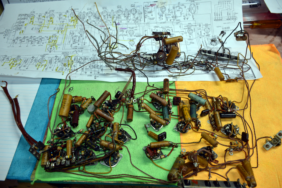

All resistors have been changed and caps re-stuffed in the RF tube socket section.  A lot needs to be installed - all coils and the selector switch.  But first, Ill get all of the tube sockets and terminal strips installed in the IF/AF section.
Looks like a rat's nest to me!  I think I'll break it up into 3 sections and replace components one section at a time.  The AF section is especially crowded.  That'll take me a while.  I know the candohm is defective so I'll need to order some resistors for that.
