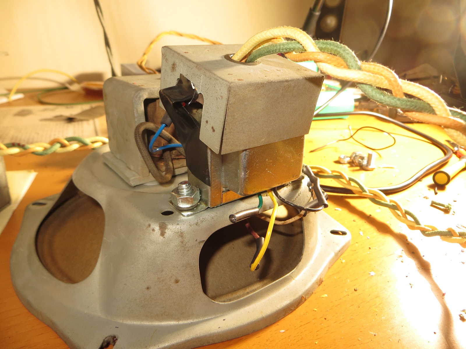

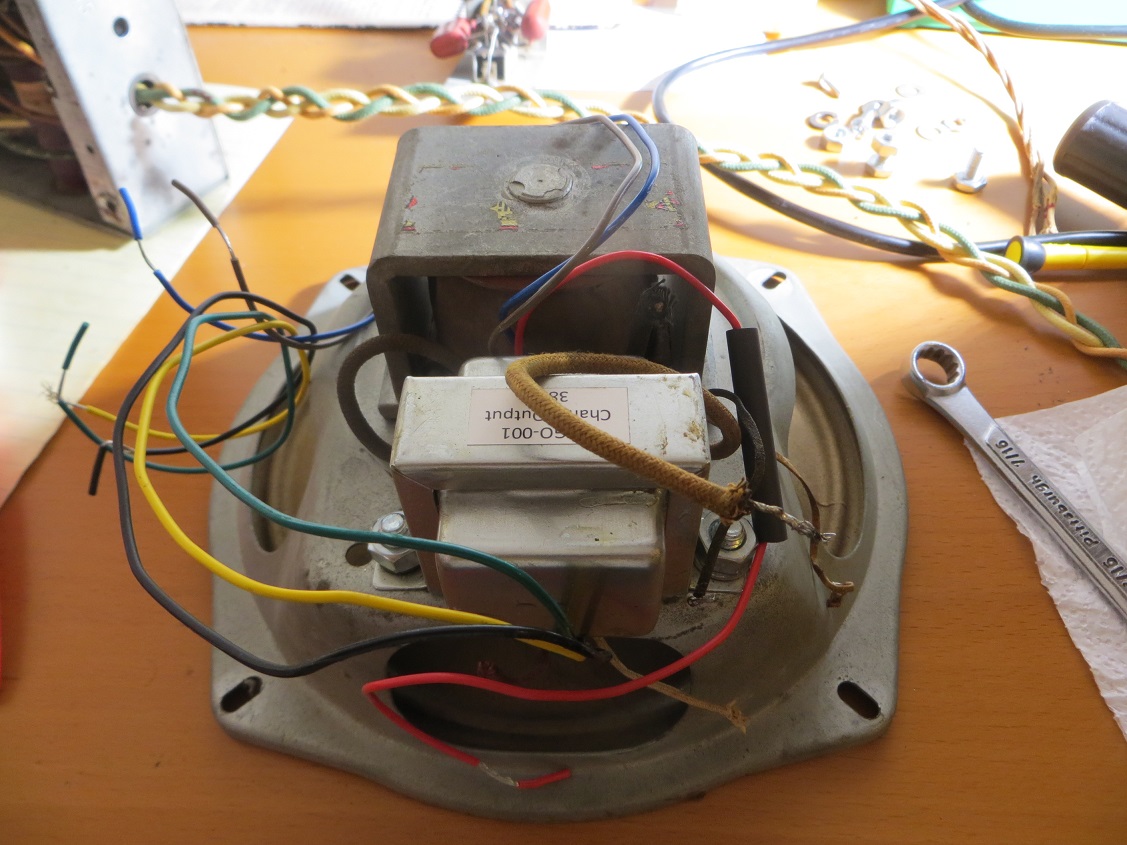

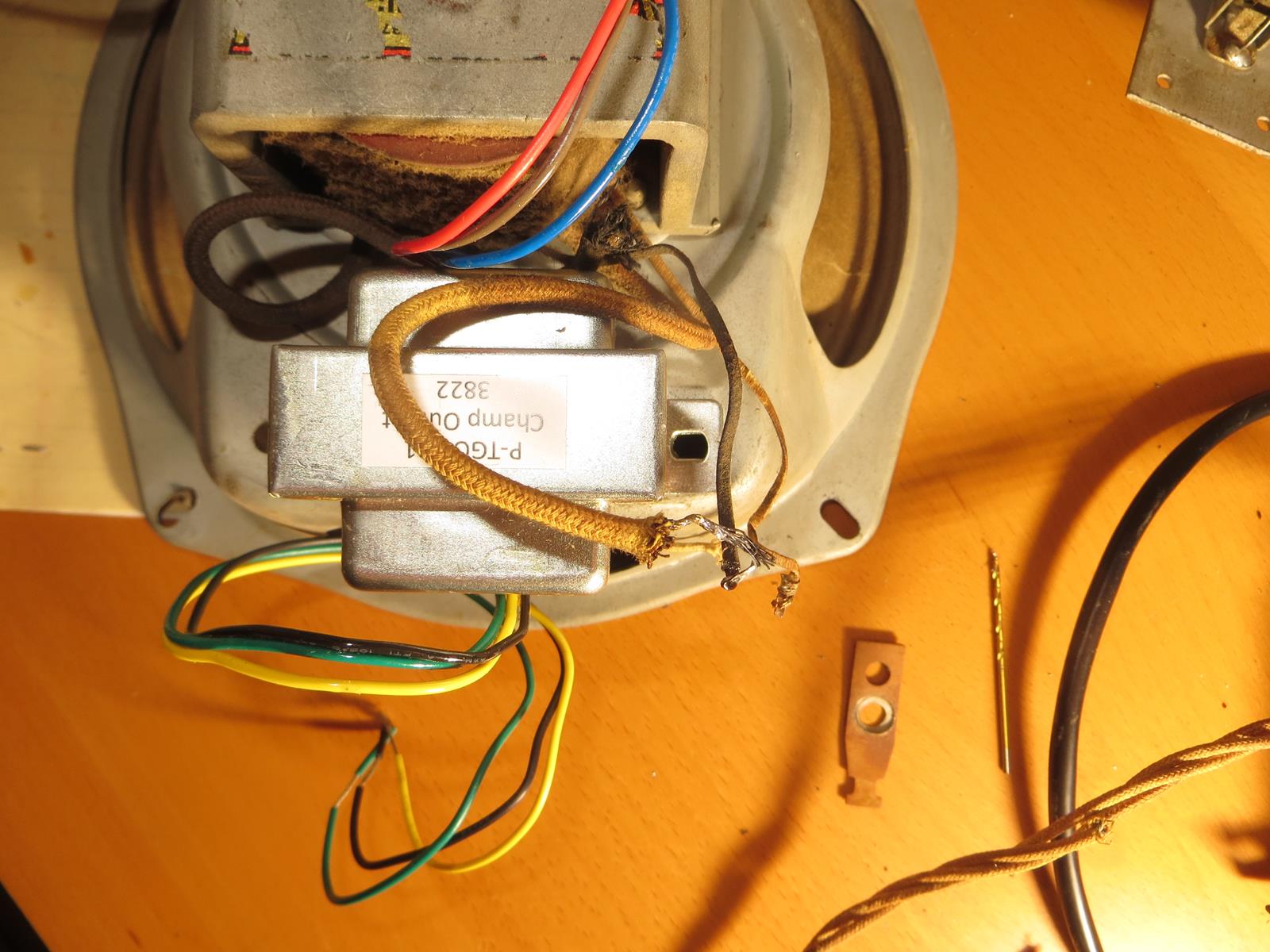

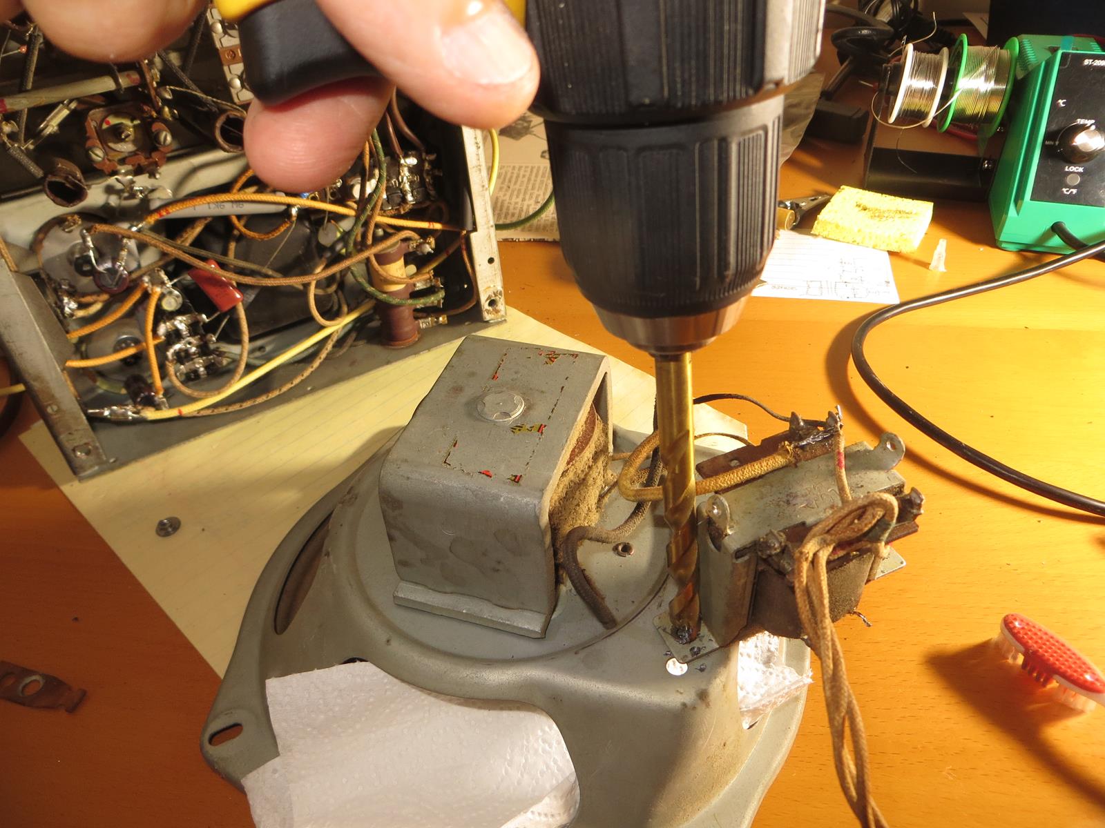

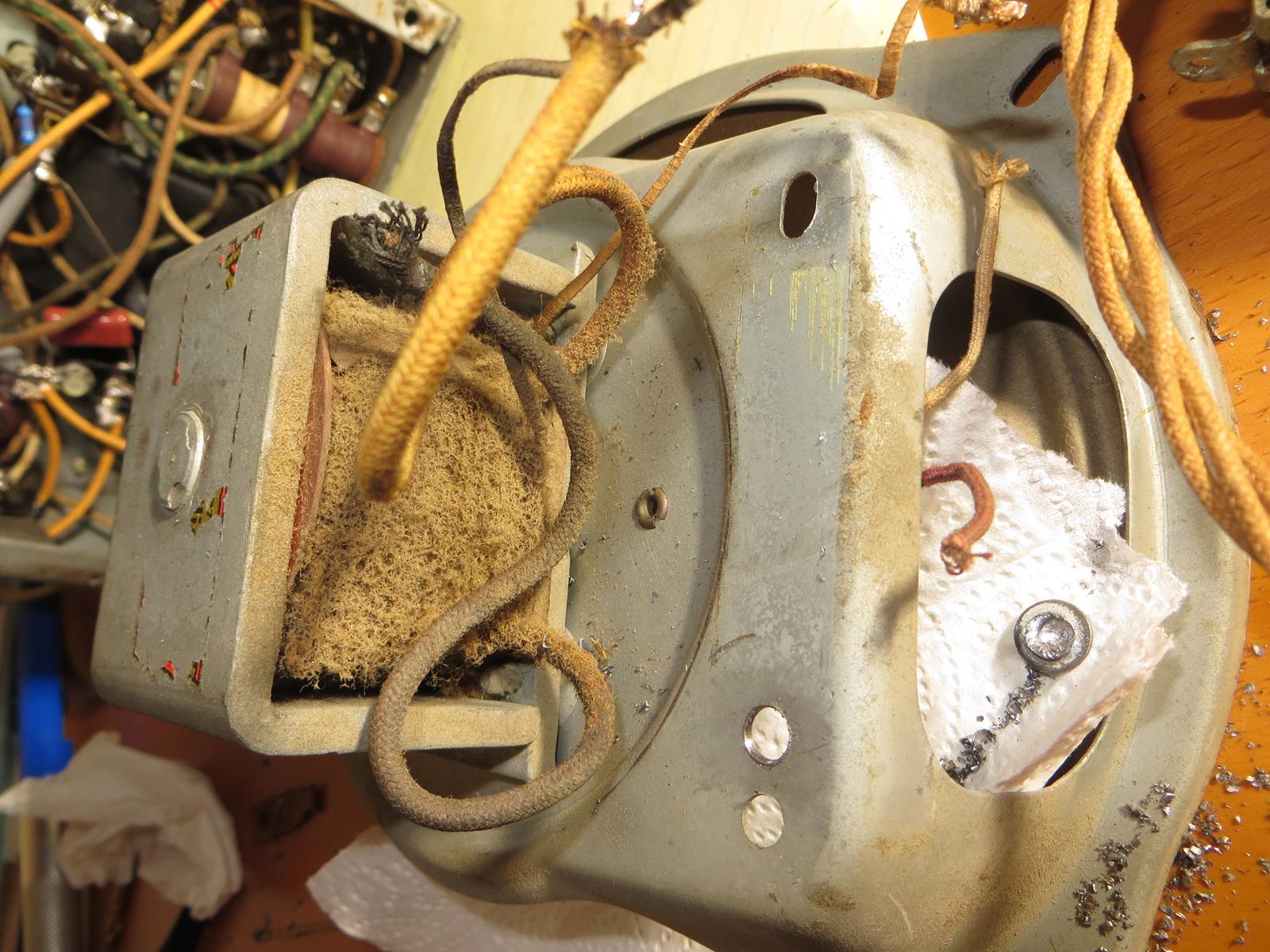

Drilled out the rivets on the speaker without drilling the cone.  Figured out better to use a very large drill bit, and eat the rim off to the level of the OPT mount surface, instead of drilling thru the rivet.
Will wire it up another day. Holes line up perfectly.
#80
Had to drill out the speaker & transformer holes a little to fit the 7/16 bolts I had.  Without touching the cone or flexing the wires.

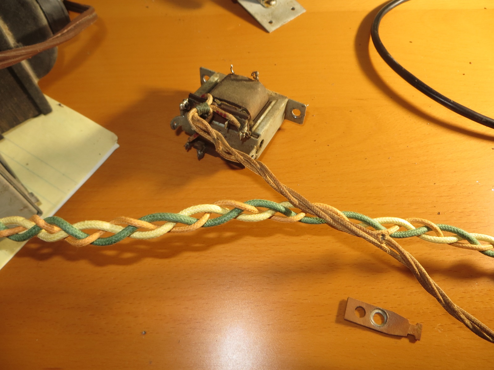

Had to go to a craft video to figure out how to braid 3 speaker wires.

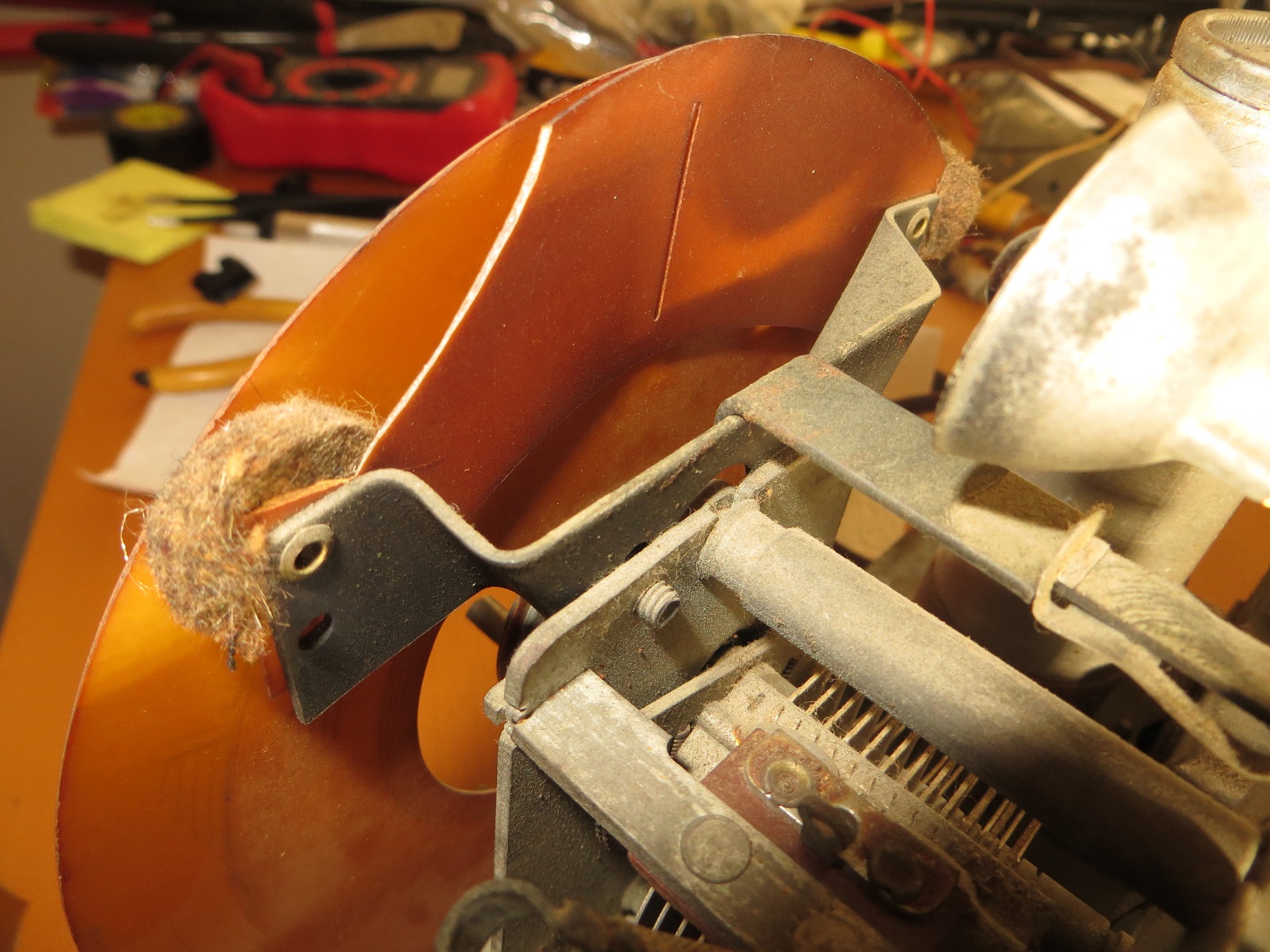

Crappy day today. Chipped the back piece of the dial, fortunately only at the edge. Still psd me off.  Was trying to pull a tube out to replace. Glued the piece back on.  It won't show up when the radio goes back in cabinet.

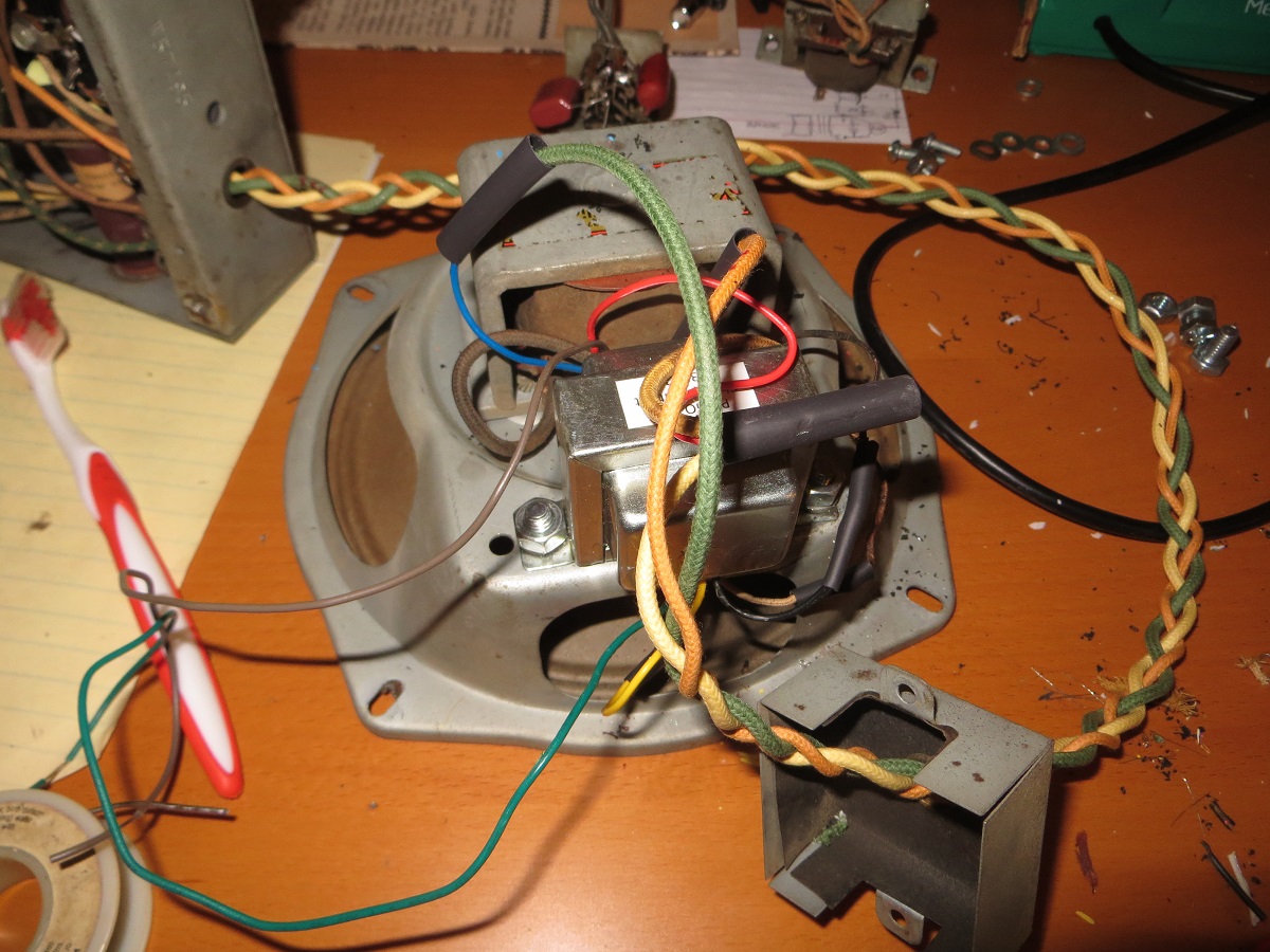

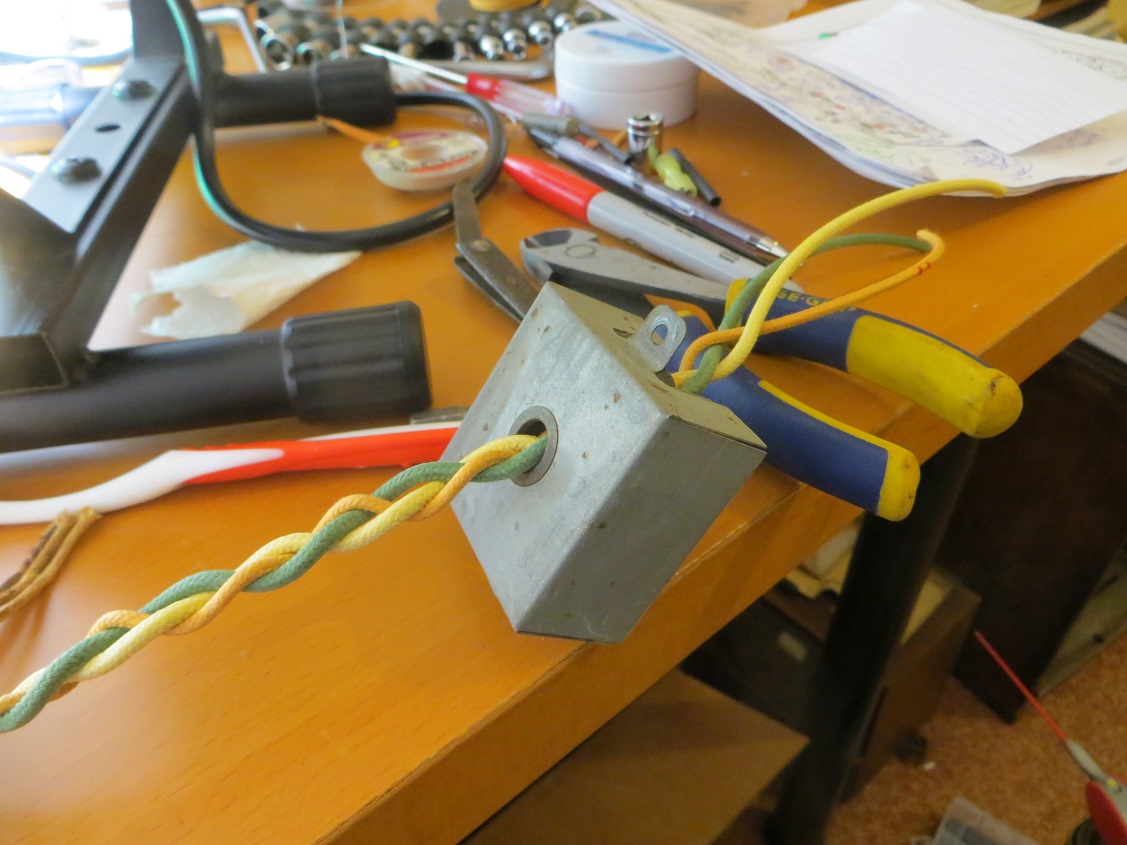

Plus after taking care to remember put the speaker transformer cover on before attaching cables, only to find out the new transformer doesn't have the attachment screw holes. Right in front of me if I would have used my head.
Hate to clip off an original piece but it looks silly.
I did have the sense to read up on tuning capacitors. I used a dry toothbrush to clean the dust off, instead spraying it with contact cleaner.
Bryan

Got the 37-60 parts radio yesterday. One that they lost the first time before shipping. Output transformer is good. Voice coil & field coils are good. Speaker cone had cracks and was sloppy repaired. Rear dial surface with the slit is good. I can replace the one I cracked. Haven't checked the power transformer yet or antenna coils. Generally happy. Gong to leave the speaker alone for now, since I have the new Champ output transformer mounted.

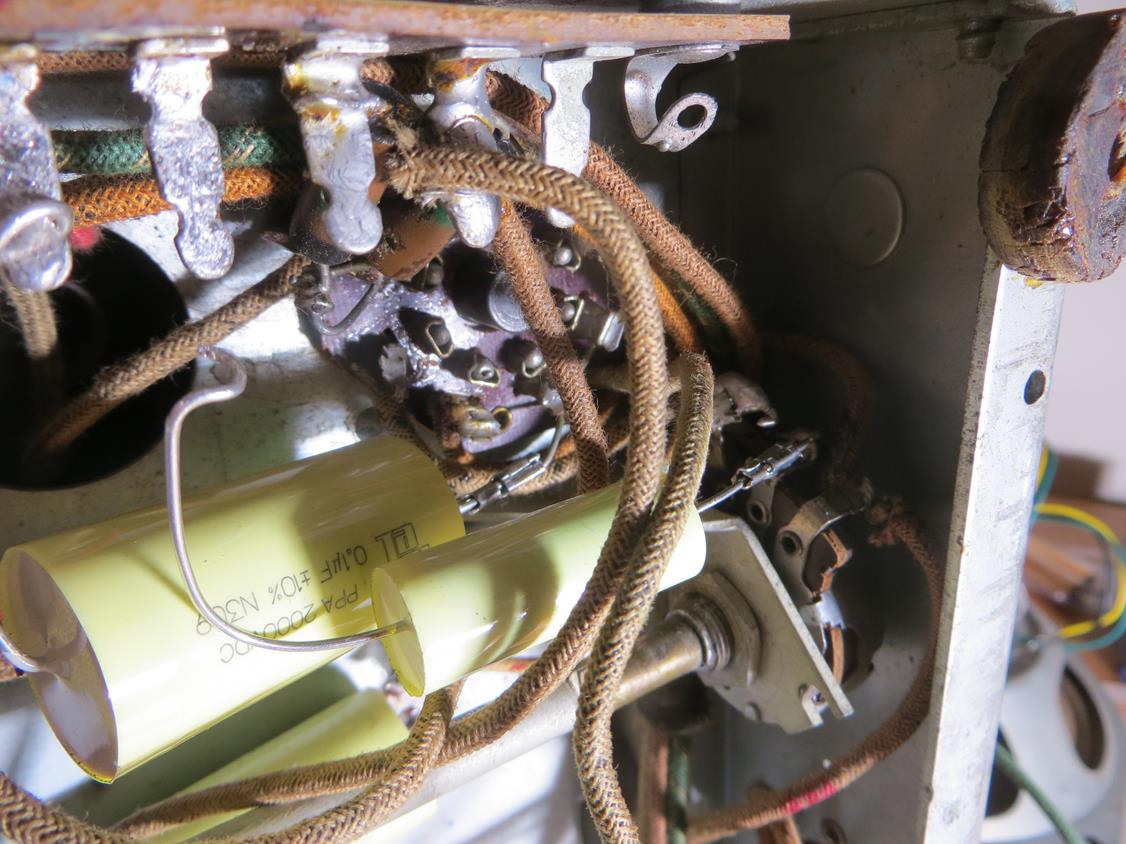

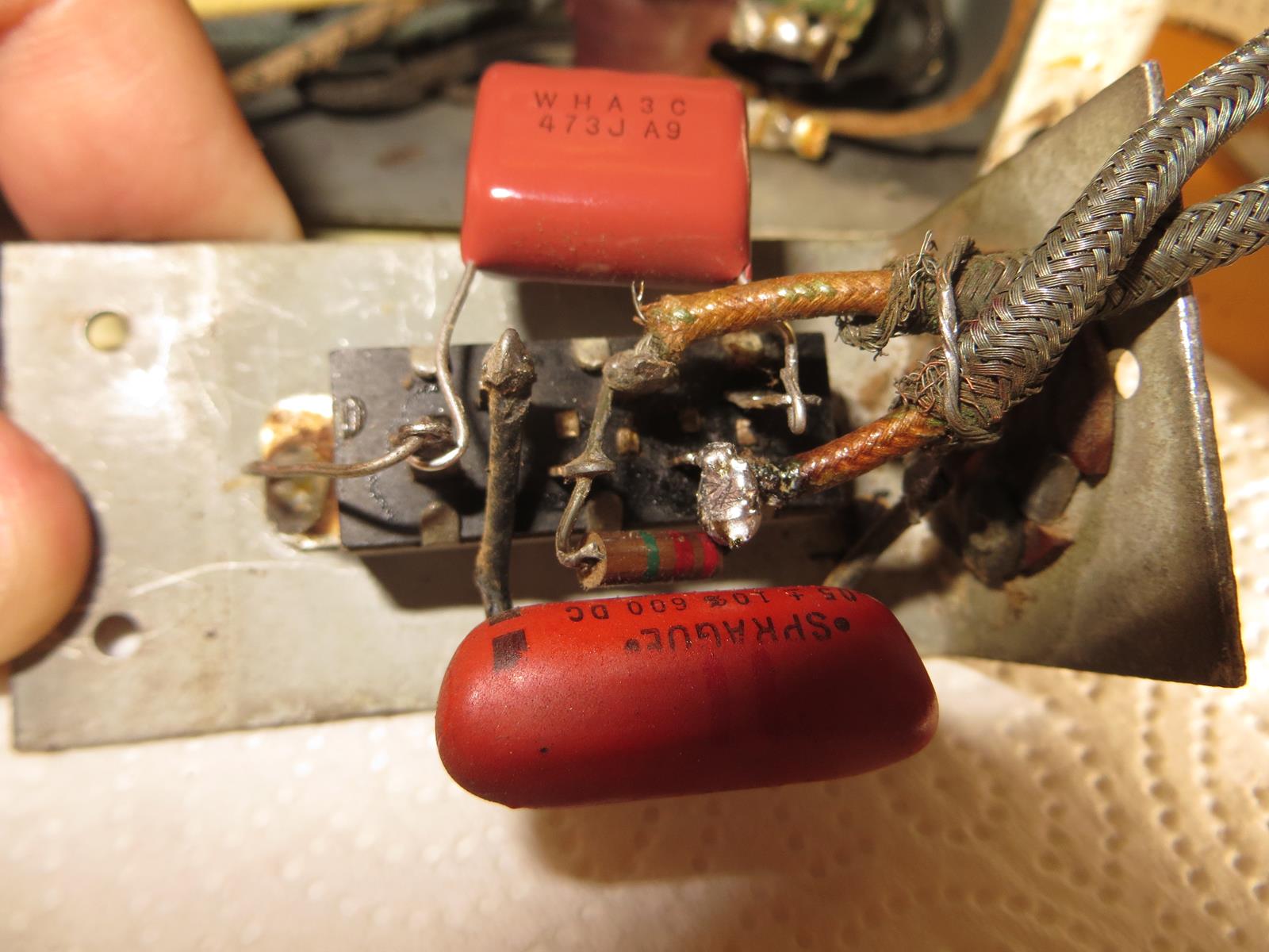

BTW, that huge 0.1uF 2kV cap in a photo in the post #79, what is it for?
#86
Morzh - that's # 16, cap for osc/det tube . Bryan

I was asking as this seems to be a very nice 2kV cap you might need for other things, and it is a waste of a good cap whereas 500V 0.1uF cheap cap (my standard is 0.1uF 630VDC) would do fine, and will be smaller in size.
Mike
