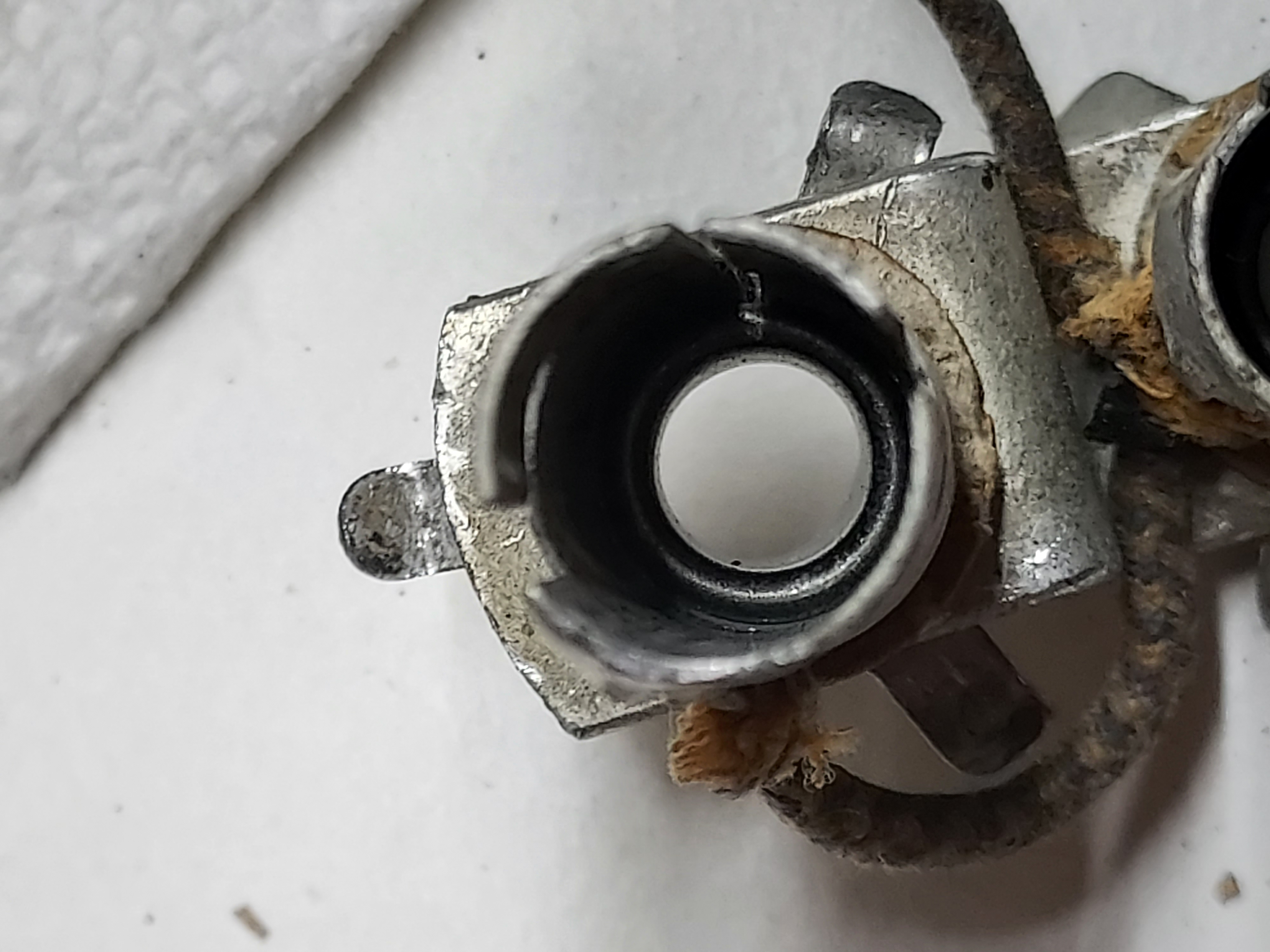

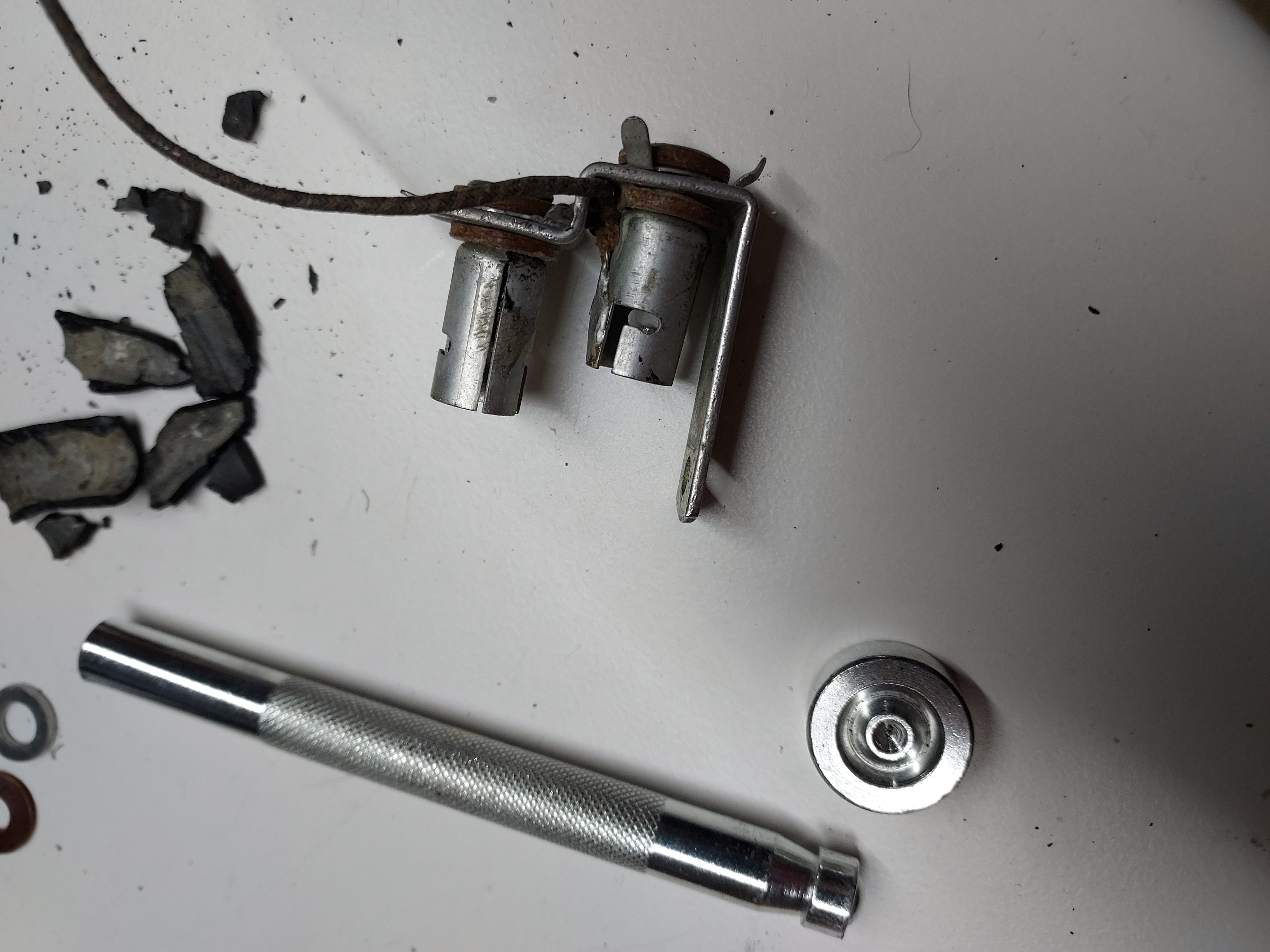

Successfully riveted the sockets.
But. That hard dried up plastick that it was coated with, and which was already cracked, fell off. Which is probably good: I will use some thick plastic or silicone tubing.

That black "plastic" was probably rubber tubing once upon a time, but like most rubber products, U.V, ozone, and heat turn rubber into plastic. Another item your Philco has in common with Rogers radios, they too liked to put rubber sleaves over the shells of the pilot light sockets, half the time chunks fall off when you try getting the bulb out. Those eyelets and that tool is useful to know about since Philco liked to install their sockets the same way, and if someone mangled the tube shield base, needing replacement, using eyelets is the only clean way to do it.

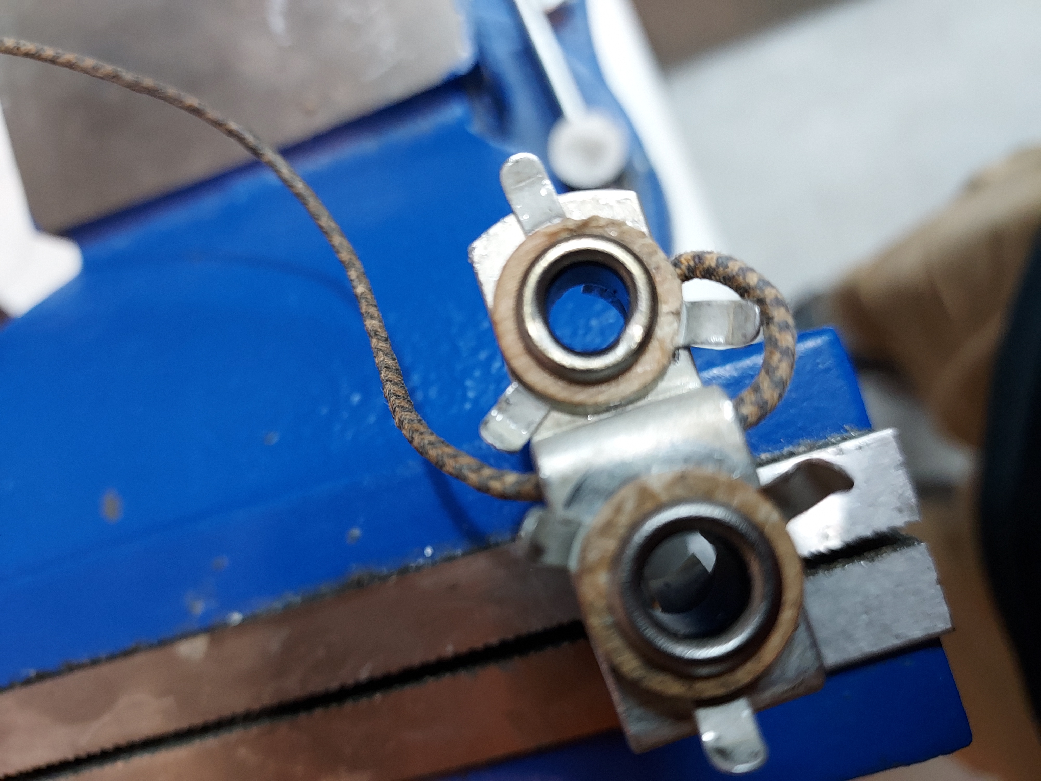

When I just got the tool out, first I thought it was not going to fit at all.
Then I realized the flaring rod was fitting, to exact size, that is I had to push it inside, it was rubbing as it went in, but it did not expand the sleeve. Literally within 1 mil.
Then the anvil was not usable fir the socket further away from the bracket. Simply did not fit. I simply situated the eyelet rim on the anvil of my large vise, and then hammered onto the rod.
For the socket closest to the bracket, I could use the anvil.
This said, it did not mangle the eyelet rim much at all; maybe it is important for the projects where the part is used according to its direct purpose, and aesthetics does matter, but in this case it does not and is barely noticeable anyway.
As for the rubber, the sole purpose of it is insulating the socket electrically from the chassis, and so even 3-4 layers of black tape would do.

I think even #8-9 length would do, but then when they are being put together, there is a lot of play initially, and the longer one (#8-12) from the kit was easier to work with as it has more protrusion, and, when flared, goes exactly where needed.
The Philco rivet problem was, the flared part was so small, and the rivet itself so thin, it readily separated into a thin ring and the rest of it, when I just touched the bulb. The second socket lasted a bit longer, but also separated without a major effort on my part.

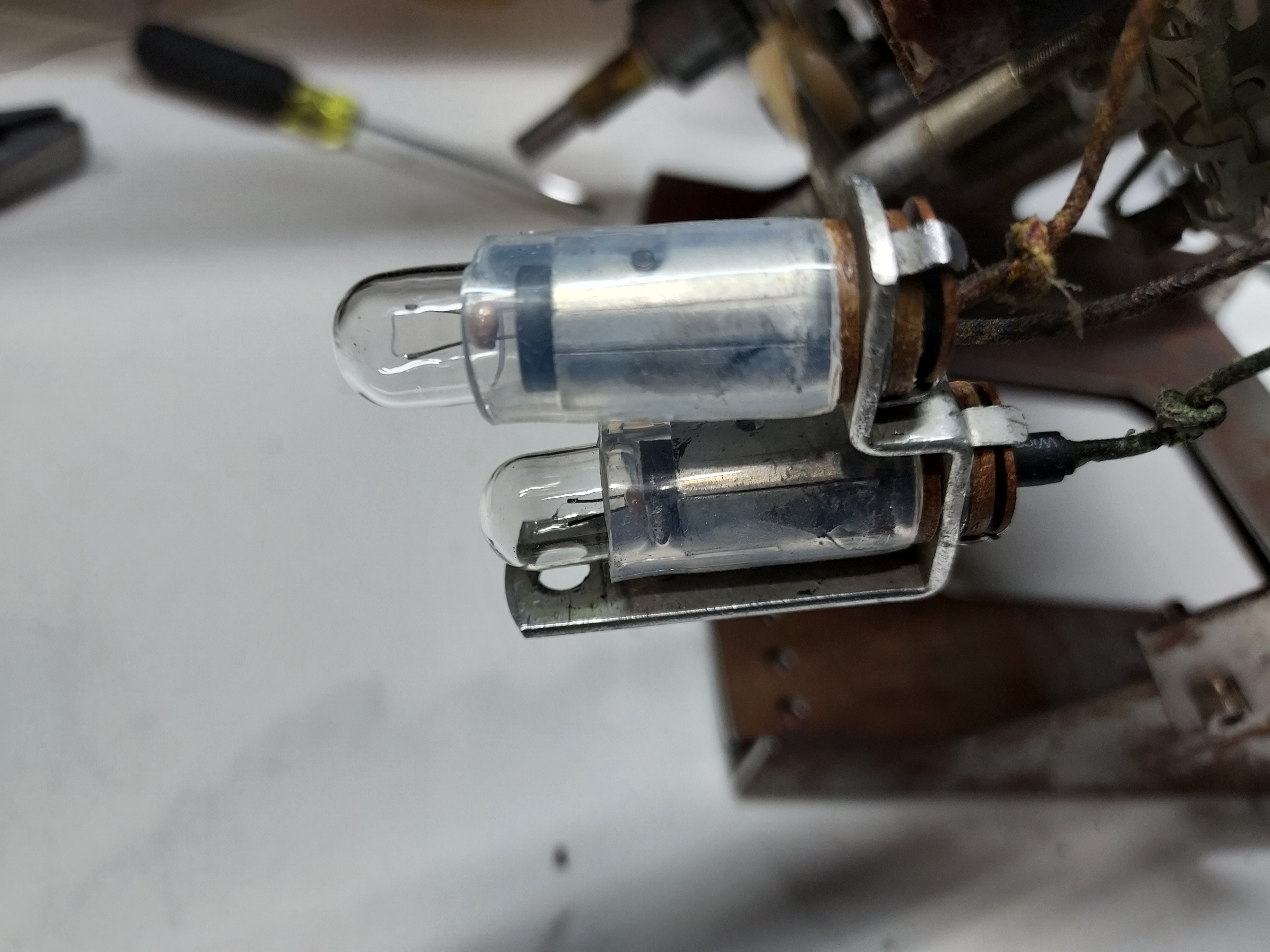

So, I tried various heatshrink tubing pieces, and, even though I think it could work, it is inconvenient. It had to be cut at the top rim of the socket, as otherwise the bulb would not go in. But that exposed the metal with very think insulation (which is what heatshrink is).
So I ordered some 3/8" ID, 1/2" OD silicon tubing, and made this
This made fairly thick insulation, close to the original, plus it would not start pulling off the bottom due to some incoming wires' thickness over the socket.
The result is this:
Plays well, and now ready for aloignment. Hopefully, tomorrow.
