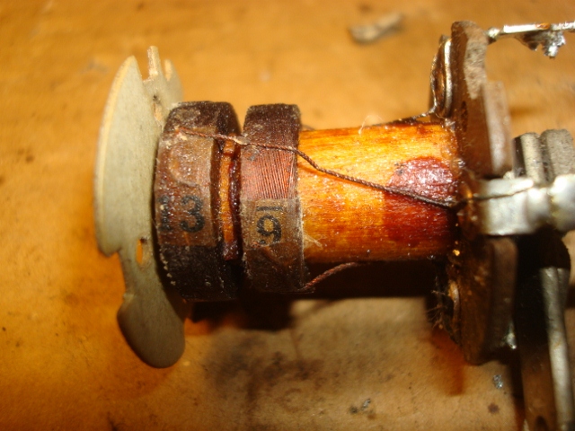

I pulled the IF coil, and much to my surprise, I found a "modern" looking coil.
Now, what do I do with this thing??? It doesnt look bad. I connected my meter to ohm it. It checks around 75 ohm on the primary, 55 on the secondary. I probed the wires coming from the coil to see if the resistance changed when I moved wires. Nothing. Now, interesting - as this coil warms (from my hand) it increases in resistance. I warmed it with the light bulb over my bench, and I could watch the resistance increase - to about 80+. Not sure if this means a thing or not. The secondary also did the same, just not as much or as fast. I cleaned the connections and resoldered, then reinstalled temporarily. Same problem. Seemed weaker even. I changed the IF tube again. Same. I am waiting for things to cool again and will try the ground on the trimmers. I did try tightening the bolts. I also resoldered the socket connection on the plate pin.
I did inject the signal at audio freq at the grid of the 2nd detector just to double check the AF section. Aside from a hum, it sounded ok.
I dont think I can rewind this coil myself. Any more ideas?

Thermal coeff. of copper is about 0.4% per degree C. That is if you have 75 ohm at say 25C then at 36C (which is your body temp) it will become roughly 4% more that of 75 would be 3 ohms. So yes it is close and your hand will bring the resistance of 75 ohms close to 80.
