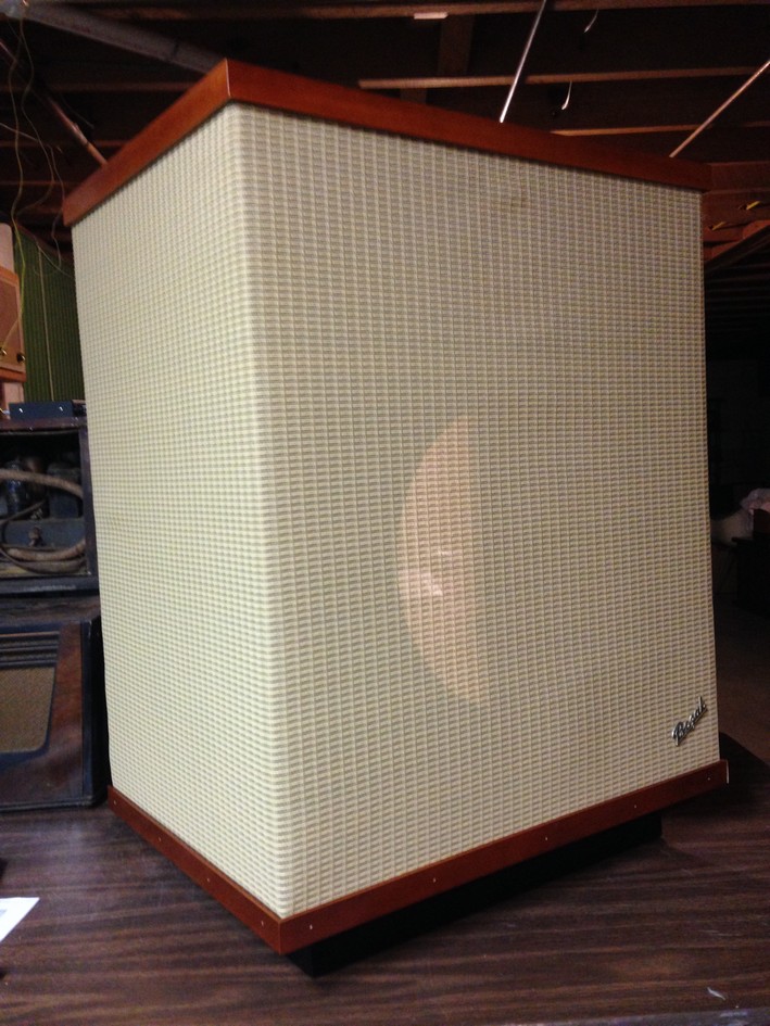

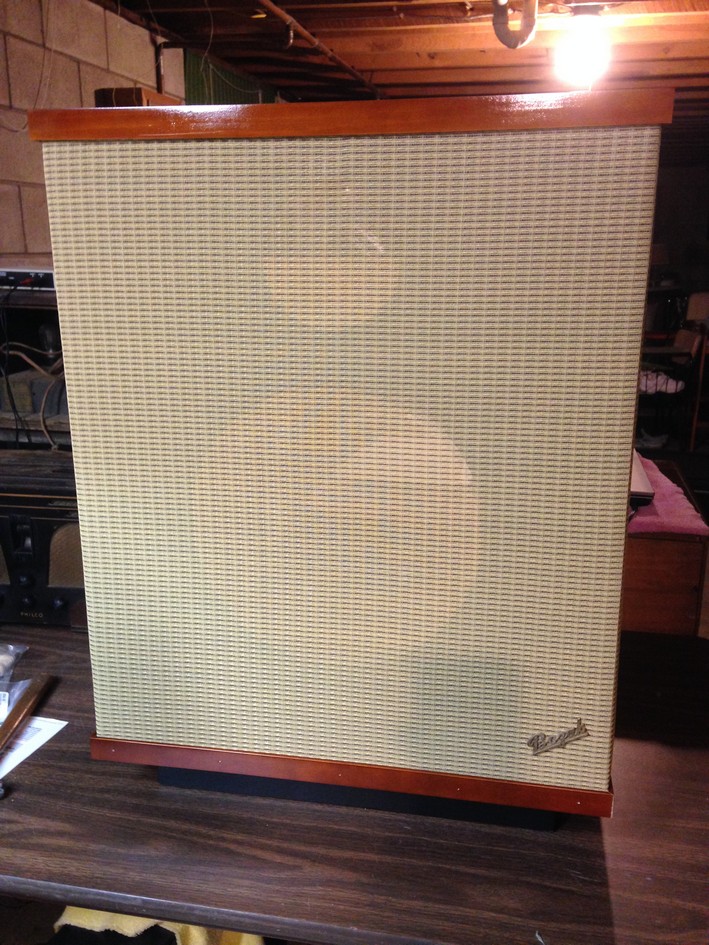

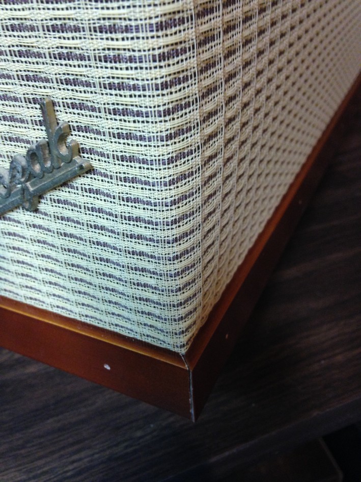

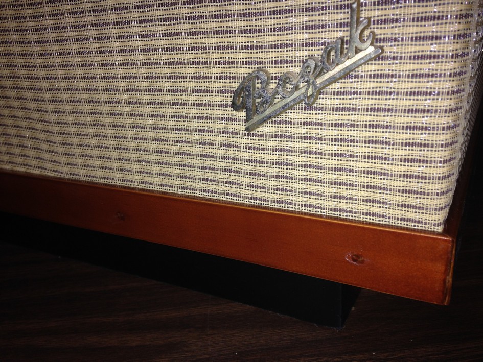

I know you folks are waiting for pictures, so here's some shots of what I consider to be the better of the two cabinets.
[Image: http://www.philcoradio.com/images/phorum/bozak_040.jpg]
[Image: http://www.philcoradio.com/images/phorum/bozak_043.jpg]
Close-up of the joint of the front and left side trim:
[Image: http://www.philcoradio.com/images/phorum/bozak_041.jpg]
That turned out very good.

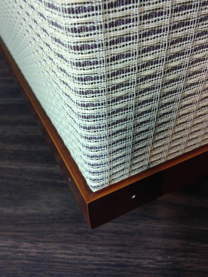

Now, a close-up of the joint of the front and right side trim:
[Image: http://www.philcoradio.com/images/phorum/bozak_042.jpg]
Not so good.
But I've already decided to touch that spot up with Medium Walnut toner and let it go.
On the other speaker...the trim fit perfectly until I nailed it in place. Now, there is some slight gapping at both corners. They will probably get filled with some filler and touched up with toner.
Yes, I'm my own worst critic. Honestly, though, go back to page 1 of this thread and compare how the cabinet looks now with the "before" pictures. I do believe there is a definite improvement in the looks overall.
I'll have to fill the tiny holes where I countersunk the nail heads using a nail set. I'm debating now whether to use Timber Mate filler which is walnut in color but not the same shade as my toner, or use regular natural wood filler and then dab toner on the spots. I'm leaning towards the latter.

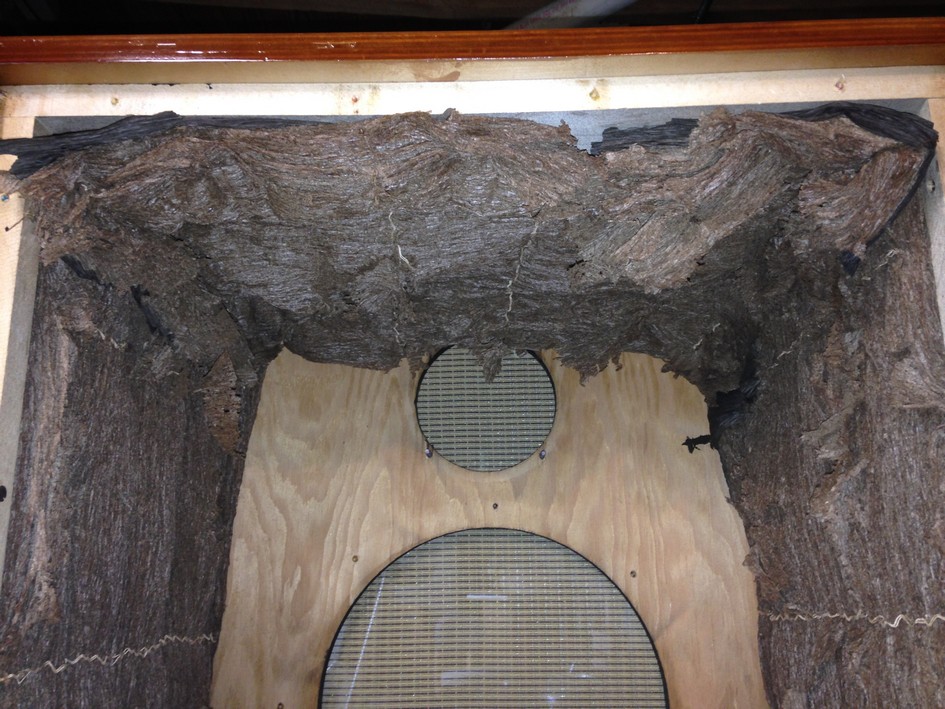

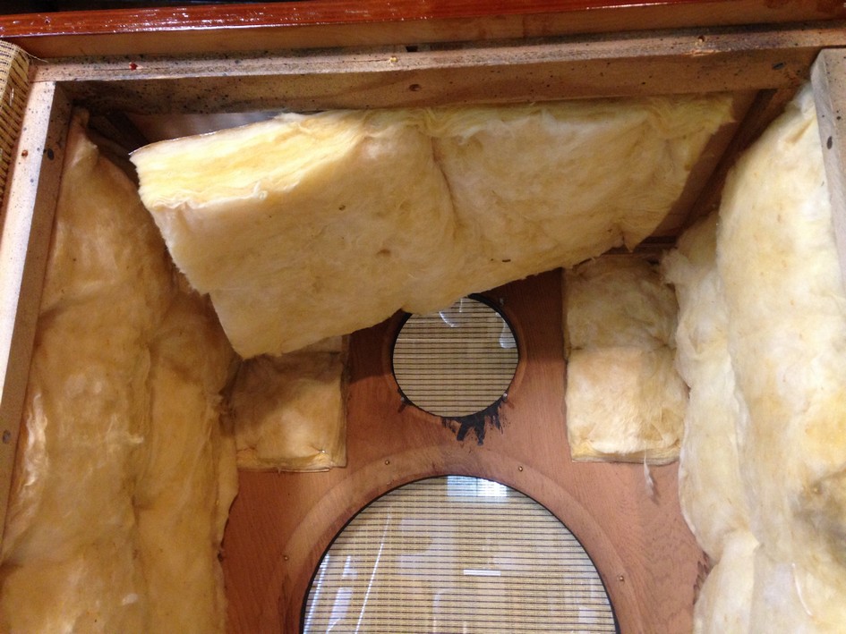

That having been done, I turned my attention to reattaching the insulation inside the cabinet tops...
[Image: http://www.philcoradio.com/images/phorum/bozak_045.jpg]
[Image: http://www.philcoradio.com/images/phorum/bozak_046.jpg]

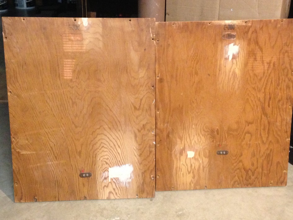

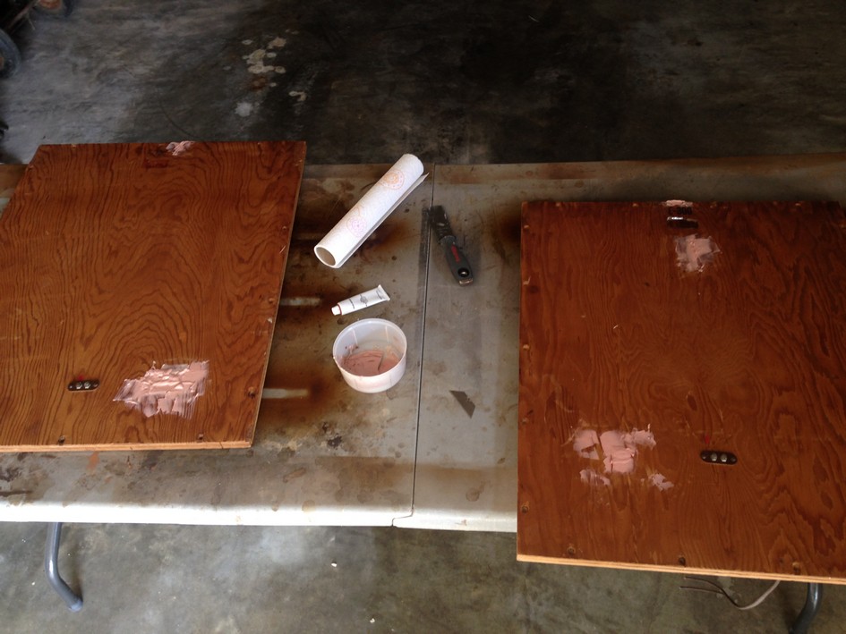

After that, I decided to attack the cabinet backs.
I removed the insulation from each back.
Then, following GarySP's advice, I applied Bondo to the extra holes in the cabinet backs that should not be there.
[Image: http://www.philcoradio.com/images/phorum/bozak_047.jpg]
In a little while, once the Bondo is fully dried, I'll sand down the backs and then reattach the insulation on the inside of the cabinet backs.
The project will then be basically complete.

After sanding:
[Image: http://www.philcoradio.com/images/phorum/bozak_048.jpg]
The areas where the Bondo was applied aren't perfect as they have a few depressions in them, but that's OK - no one is going to look at the backs anyway - the important thing is that the unwanted holes are now sealed up.
I've re-stapled the insulation to the backs and they are ready to be put back on the cabinets. Of course the speakers and crossovers must be installed, and the new wiring run before the backs can be attached.

Did you use new insulation, and if so is it any different than regular house insulation?
John (Eliot)
Thanks!
No, I retained the same insulation that was in the cabinets already.
The brown stuff in one cabinet is some sort of paper insulation product. Quite fragile now after 60+ years.
I don't know if the other cabinet is that much newer that it had fiberglass from the factory, or if someone replaced the original brown paper stuff at some point.
