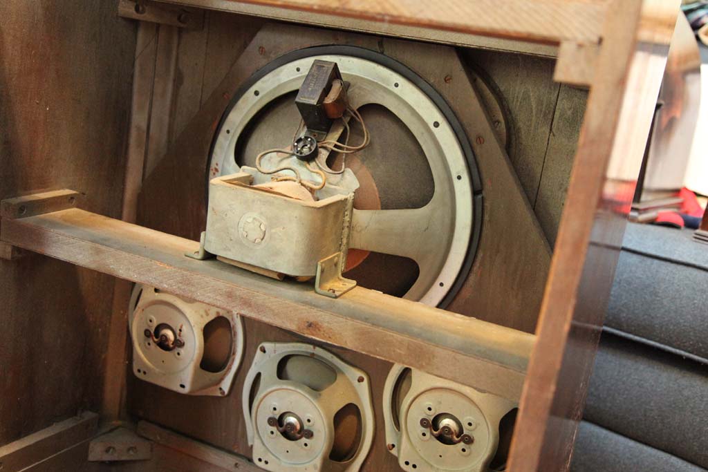

Would a few pics of the mounted speaker help???
Of course, always good to have few more pics. I have mounted it by now, as the speaker itself is not that complex an animal - there is that felt that I use the weatherstrip instead, two bolts and two screws, at least that what it was when I got mine (with one bolt missing).
It is my understanding the speaker is not mounted to the speakerboard by the rim, and is only pressed against the felt strip due to the location of the mounting holes for the bolts on that horizontal bar, am I correct?

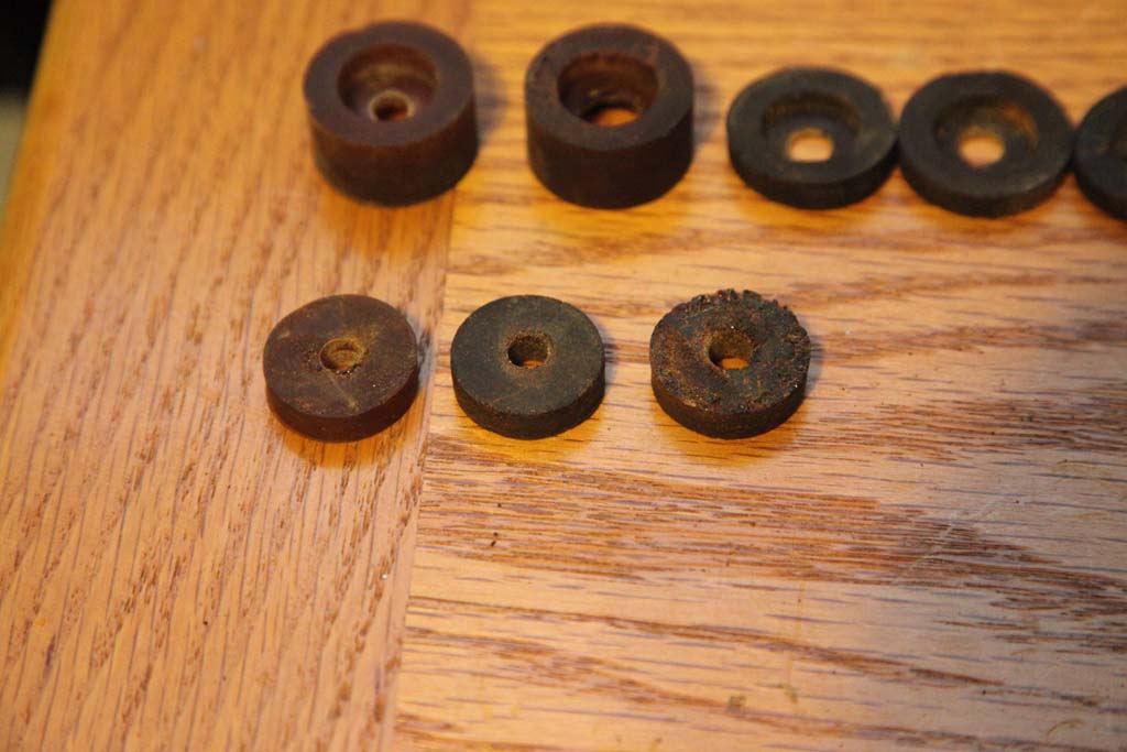

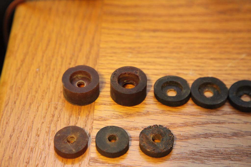

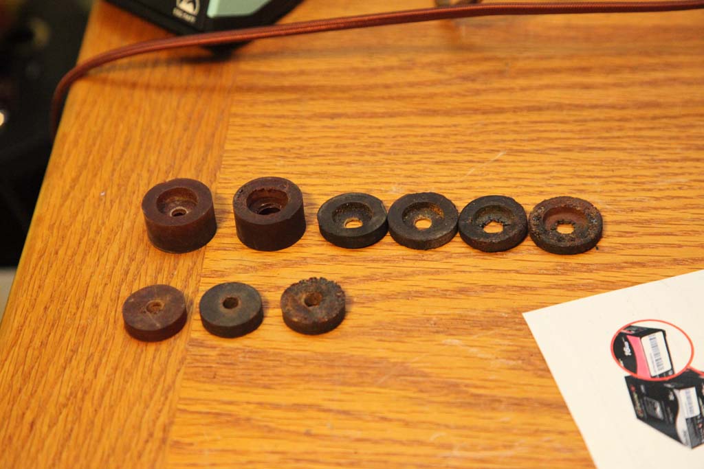

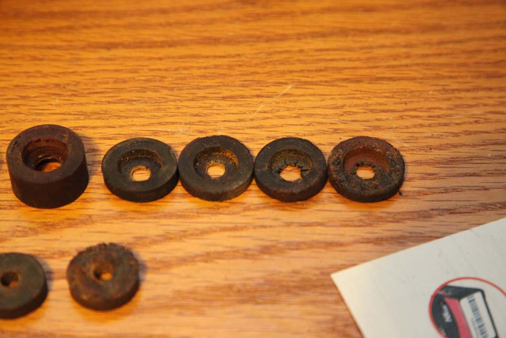

The rubber part - yes I am talking about those that fit between the chassis and the crossbar.
I am not sure how many of them go there, there are also no through holes in the crossbar where those round mill-outs are. (they remind a fig. 8 - two intersecting circles).
But there a severall various rubber parts - some of them are obviously too big to fit in between teh chassis and the crossbar.

Here are some photos.
Rubber grommets or whatever you call them plus one pic of the speaker mounted.
All grommets
Closeup 1
Closeup 2
Closeup3
Speaker

Morzh, I've never worked with your model, so keep in mind that I could be wrong. I think the two thick bushings probably go on the front of the chassis. Look for two metal posts sticking out on each side of the front of the chassis, and two holes in the cabinet. They cushion the front of the chassis up against the cabinet. The three smaller ones are for mounting the chassis. There should be holes in the board the chassis sits on. There should be four of them and the missing one may well be stuck in the cabinet. The other four, I am not sure about.
I am sure someone will speak up who knows for sure, but maybe my info will get you started.
PuhPow
You are probably right.
I am not sure about the big ones - the holes seem to be a bit larger than those posts but could be still.
Both smaller and larger flatter ones fit in those mill-outs under the chassis, in the board, so they are probably to cushion the chassis. Why they need the holes...not sure, there are no through screws that go there as there are no through holes drilled, so it is just padding then and the screws go separately in some other place. I guess they did cushion the heck out of that chassis.....it's a heavy one.
