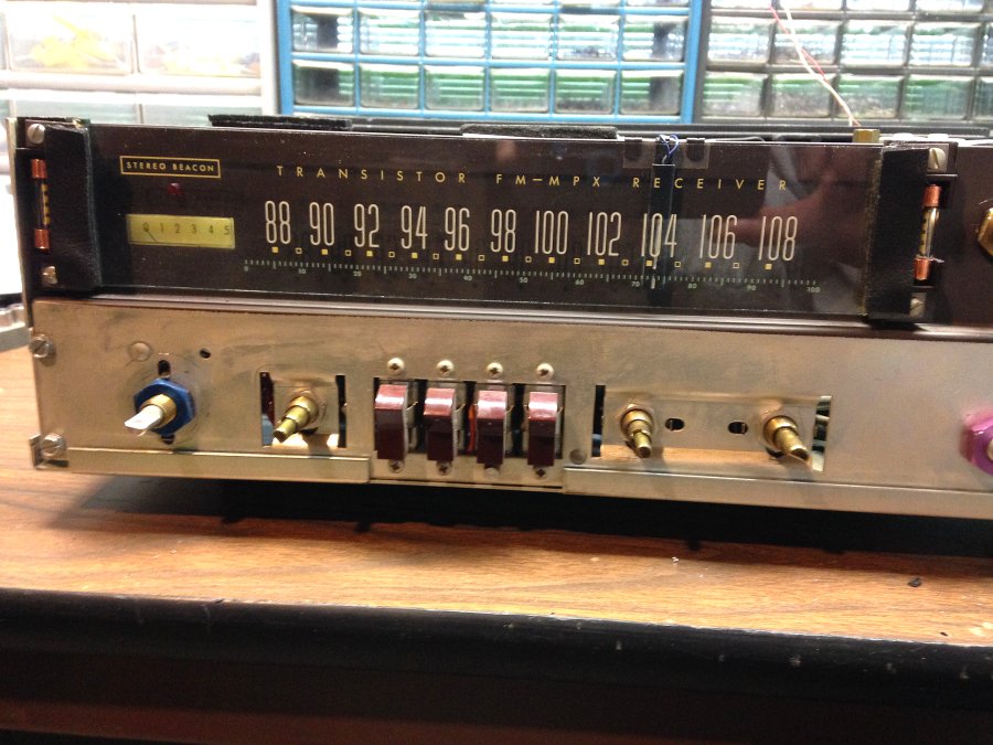

A few photos:
[Image: http://www.philcoradio.com/images/phorum...00-T_8.jpg]
[Image: http://www.philcoradio.com/images/phorum...00-T_9.jpg]
[Image: http://www.philcoradio.com/images/phorum...0-T_10.jpg]
Notice the strip of foam on top of the rectangular metal box which is part of the IF board?

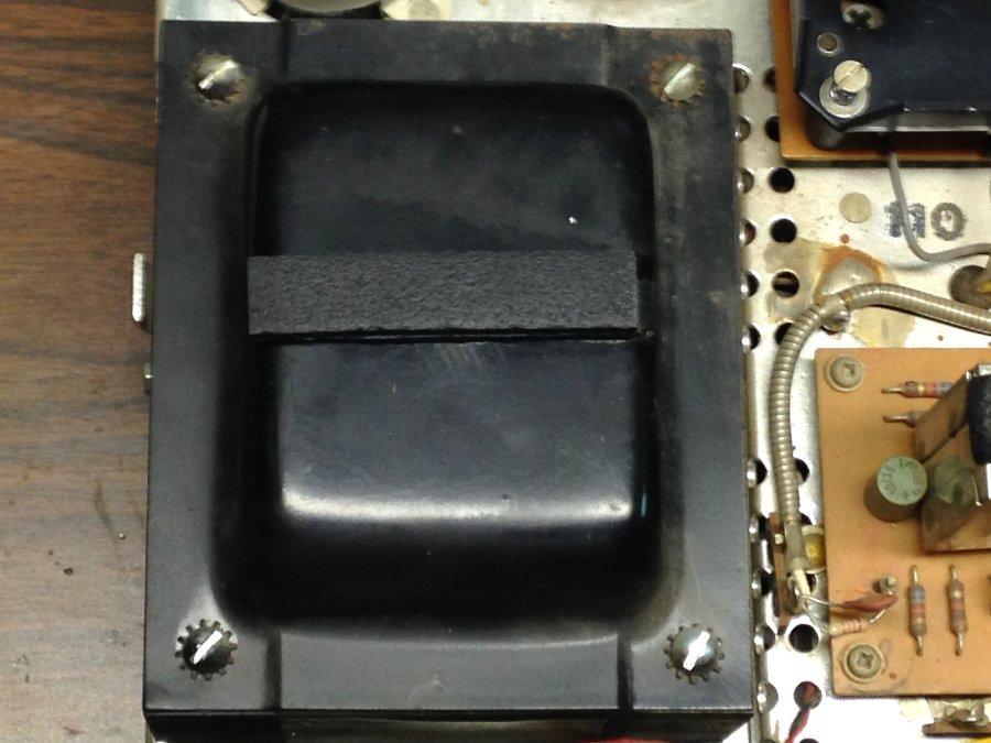

Notice also that it looks like it once had another piece of this foam on top of the power transformer, but is now missing save for the residue of where it was once stuck on there?
It looks to me like it might be similar to some speaker gasket material I have on hand...
What say you, Mike (morzh)? Would speaker gasket material be OK as a replacement for the foam here?

That is what I suggested before on the revious page. I do not know what speaer gasketing is made of, but if it is anything like dense rubber foam weatherstripping which, incidentally, I used for speaker gasketing in 37-116, then yes, should work. As long as the tranny does not get hot so you start sniffing fumes.
I was about to say that it looks like they did use a piece of gasket when I looked at your photos.....
(02-14-2015, 08:28 PM)morzh Wrote: That is what I suggested before on the revious page.
Yes, I know.
The speaker gasket material I have looks similar to what is on top of the IF board in my 700-T. Yes, I would say it is very much like dense foam weatherstripping. Its intended purpose is to seal speakers in enclosures. I do not know how it would react when hot...and I do not know if the transformer gets hot...somehow I doubt it based on its sheer size and the fact that this receiver will never be cranked to full blast while I own it.
OK, settled. Speaker gasket it is.

I applied two thicknesses of speaker gasket material to the top of the power transformer.
[Image: http://www.philcoradio.com/images/phorum...0-T_11.jpg]
The speaker gasket material looks very much like the dense foam Fisher used not only on top of the IF board, but also on either side of the glass dial scale and on the inside edges of the front panel.
After I put the foam on top of the transformer, I put the top cover back in place - no more thump.

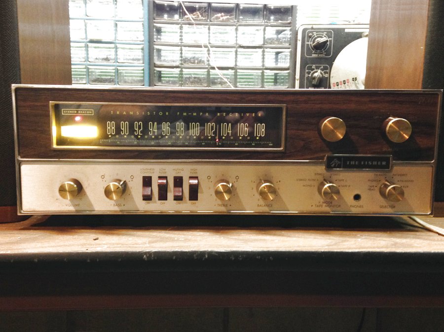

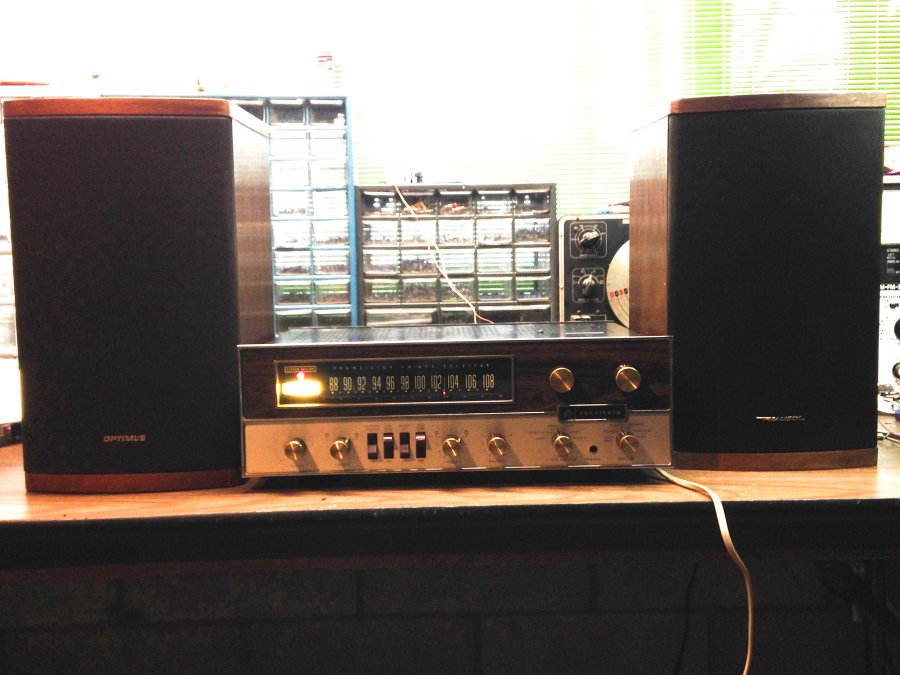

I then hooked up a set of speakers, and tried it out...
[Image: http://www.philcoradio.com/images/phorum...0-T_13.jpg]
[Image: http://www.philcoradio.com/images/phorum...0-T_14.jpg]
The right channel is louder than the left. I did notice as I was testing the transistors on the control amp board, that one of the transistors had somewhat lower gain than the other three - this may be the reason why. Other than that, the receiver sounds very good.

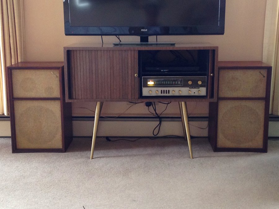

The final thing to do was to put it into my Mid Century component credenza. This is why I could not use the cabinet - there is not enough room for the receiver's cabinet with the unit in the credenza.
[Image: http://www.philcoradio.com/images/phorum...0-T_15.jpg]
Here it is - a nice Mid Century stereo setup in the living room. The component cabinet was sold by Radio Shack between 1961 and 1966. The speakers are Wharfedale W-60s, made in the early to mid 1960s. The receiver is a 1967 model. Now I can choose between this unit and my Motorola hi-fi, also in the living room.
I know a lot of you don't care for the flat screen TV, but we felt that we needed to make some concessions to contemporary life. The TV sound will play through The Fisher and the Wharfedales.
So now as I type this, I am allowing the 700 to "burn in" and it is playing nicely. I have it connected to my attic antenna, which is also used for TV. That is my next home project - to get the antenna off the attic floor and mount it permanently to a pole in the attic, the same way I had the antenna mounted in the attic of my previous house in Evansville. We almost never watch TV, but it is nice to be able to see the news and weather occasionally.
