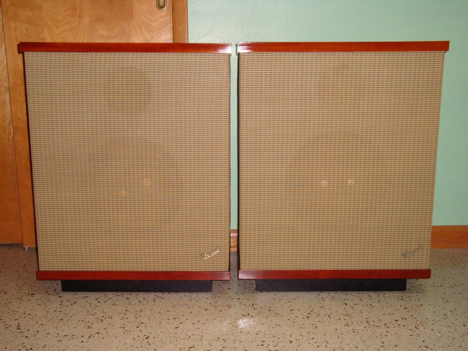

To recap, before:
[Image: http://www.philcoradio.com/images/phorum/bozak_001.jpg]
At long last, here they are (the "after" shot)!
[Image: http://www.philcoradio.com/images/phorum/bozak_049.jpg]
It only took two months and a day...but they are finally done and finally in my home office.

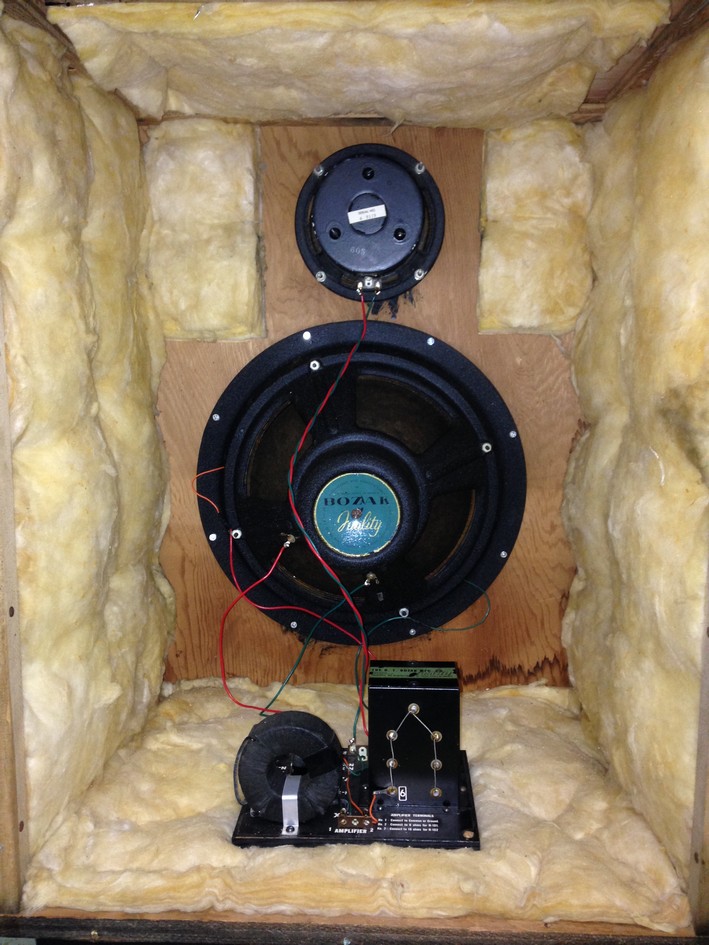

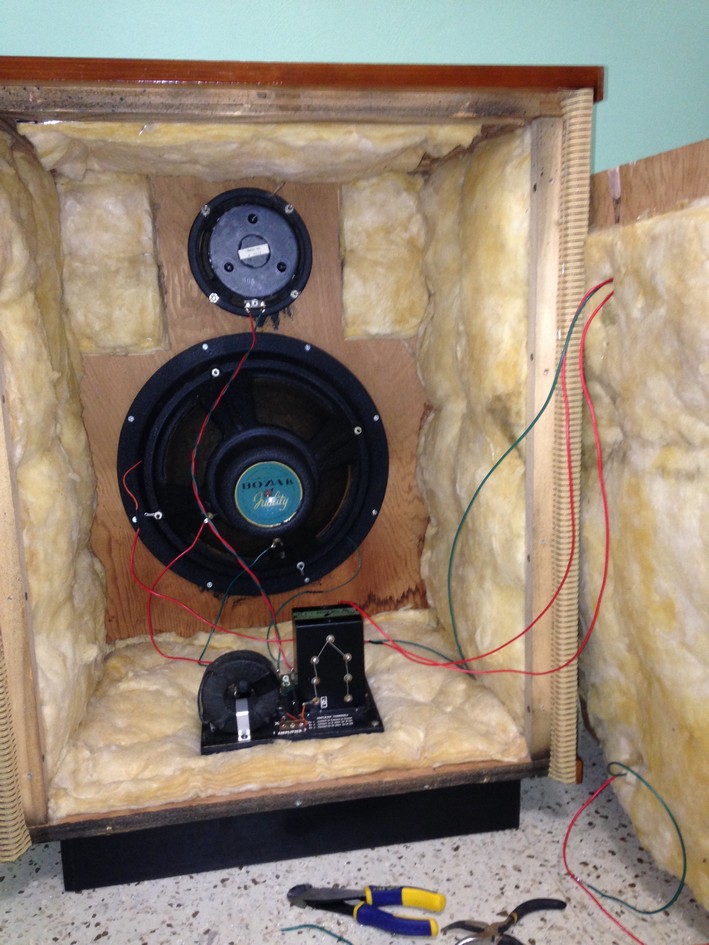

This shows you how things looked in one of the speakers after they had been reinstalled and rewired.

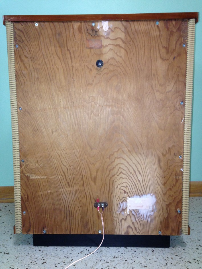

...and you can see the addition of a knob on the back. This also shows you how the backs looked after application of Bondo and sanding to fill the other holes.
Yes, I put another hole in each back and installed L-pads in each back.

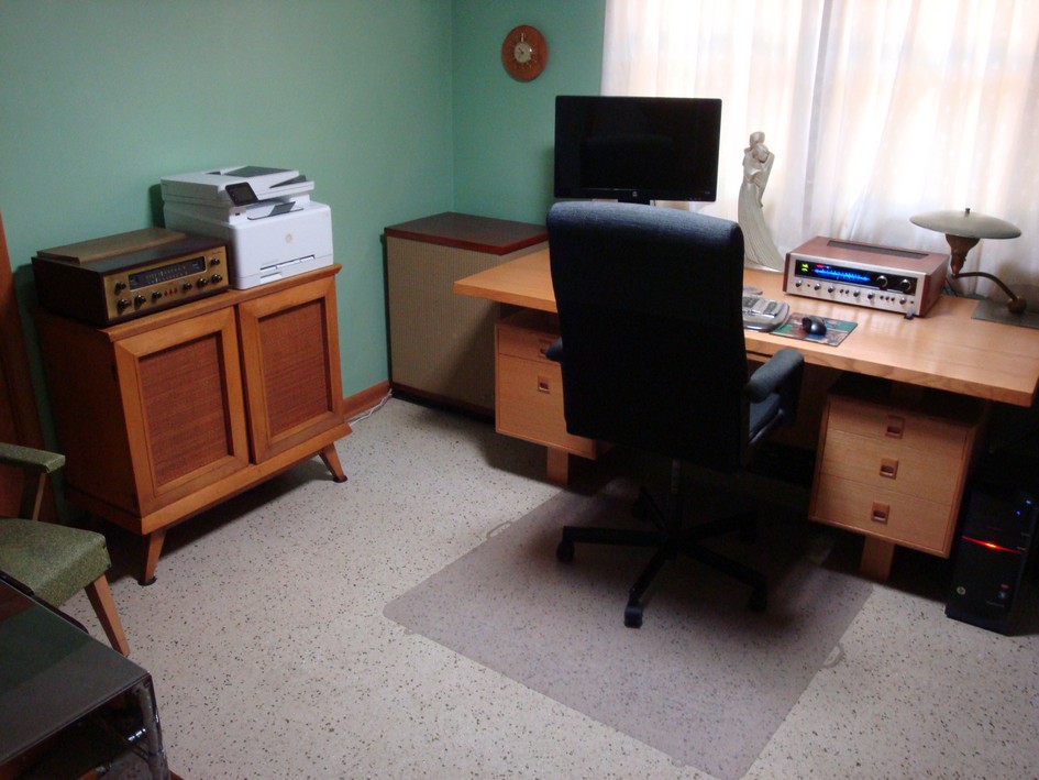

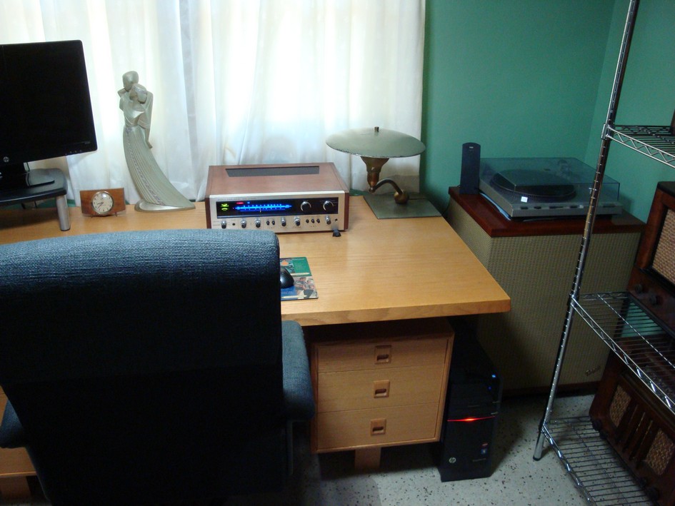

You can see a Mid Century record cabinet on the left with a 1959/60 Fisher TA-600 as a static display. In the next year or so, I plan to give it a thorough going-over and restoration and I may begin using it instead of the Pioneer SX-1500TD in here at that time. To the right, along the wall, is my shelving unit full of Philco Tropic radios.
I turned on my Fisher 700-T in the living room and listened to the speakers in there, Wharfedale W70s, for a while. Then I came into my home office and listened to the same program material on the Bozaks. The difference was like night and day. While the Wharefedales sound very good, the Bozaks sound very lifelike. It is like being at a live performance instead of recorded sound. Amazing!
