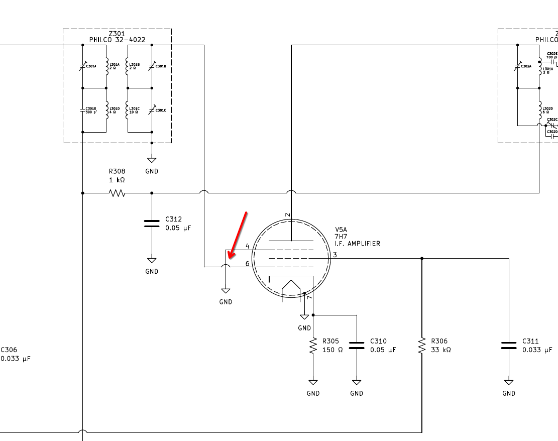

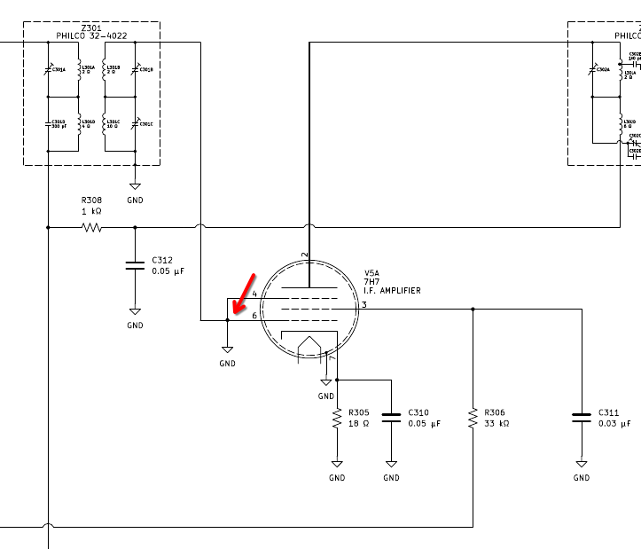

I forgot to make mention of it the other day, but last week I corrected another error on my schematic (applies to both Revs 0 and 1). I had thought, from looking at the Philco schematic, that pins 4 and 6 of the 7H7 used as the second IF amp were connected. I realized when comparing against my physical wiring notes that they are not. I also verified using the Rider's version of the schematic that they are not tied together. I'm sure that the original Philco schematic was correct, but this particular crossing was blurry and it looked to me to be a node. Anyway, I've attached the corrected schematics.
Before Correction:
After Correction:

I have never hear of the Suppressor Grid to be used in parallel with the Grid.
SG sole purpose is to be anti-dynatron grid, which is suppressing the secondary emission.
Which usually makes it connecting to GND or K.
Not only would it not make sense for a suppressor grid to be tied to the (signal) grid, but both would be tied to ground in this case killing the input from the previous IF transformer. Maybe there is a circuit out there that makes use of the suppressor grid for something other then eliminating secondary emission, but it's probably in some one tube home brew project. I did run into a similar wiring error in a Phonola though, they tied the suppressor grid to chassis ground whilst the cathode was floating above ground, and this was a wiring error from the factory. I'm not sure what difference this would have made to the performance of the 6K7 IF amplifier tube, but there was evidence that the tube had been changed most recently in the 1970s since it had the RCA block letter logo on it.
I have noticed that the AVC line in some pre-war Philcos is connected to the suppressor grid, as well as the control grid, of the first IF. The 41-221 is an example. Maybe that's what this is.
http://www.nostalgiaair.org/PagesByModel...013394.pdf
Rod,
41-221 is above. By "control grid" you probably mean screen grid, that of the 2nd IF.
I'd like for someone to verify this in citu, as unless that is verified, I'd almost think this is a schematic misprint.
Mike, check out the 42-PT2.
Where do I look?
7B7 Suppressor?
Both these radios seem to connect the SG to AVC. Which I am not sure why, but then the AVC potential is close enough to K.
But it will not connect to Control Grid.
Well, you're right but the AVC gets to the control grid through the IF secondary, no direct connection to the control grid.
I thought it was strange when I restored the PT2, then I just finished the 41-221 and noticed it is there also. Maybe it's a quirk of loctal tubes.
