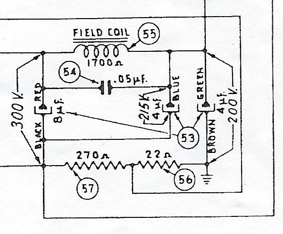

    My first restoration, Philco Model 40-165 code 121.  Speaker had been removed so I am going with a PM.  In the schematic, is the 1700 ohms the DCR read as if the choke was disconnected?  I mean it has nothing to do with X sub L?  Also, should there be a couple of fuses?  One in the line and one at the power supply output?

Correct. Inductance is measured in Henrys.  Resistors have very little inductance (wire wound) which can be a issue at RF but in power supply filtering it's a non issue. With that being said you'll need to increase the value of the three capacitors to 33mfd or so to eliminate 60cy hum. Remove #54 from the circuit.
You can add fuses 1A to the ac line and 150ma to the center tap of the HV winding.
Thanks for the info.  So wouldn't I still need a small choke with sufficient current carrying capabilities in series with the resistor to smooth out the hum?  If I did use a small coil, would the caps still need to be changed ?

No not necessary, you can filter using just caps and resistor. If you look at more modern set like ac/dc set from the '50s there's no inductance in the filter. Just as a guess if you didn't increase the size of the caps your probably looking at 5-8H to replace the field coil in terms of inductance. The series resistance isn't very critical in this circuit. Where it is critical is when the field coil is connected to the HV center tap back the chassis gnd. In this case the fc or choke does two things filters 60cy hum and develops negative dc voltage used for biasing. The fc dc resistance determens the amount of bias. Circuits wired with the fc or choke in this fashion are known as negative lead filtering.
That's part of the long answer to your question. The short answer is to use a 1700 ohm 25w resistor in place of the fc. Actual dissipation is about 15W but nobody likes a flaming hot  power resistor. Remove the .05mfd that is across the fc it's used to resonate the inductance to the fc to 60cy and will just couple hum across the replacement resistor. Good practice sez to limit the input cap below 40mfd so 33mfd is good and while your ordering go ahead and replace all 3 of them with 33mfd @ 450v.
Thanks for taking the time to explain the field coil replacement in detail.  I think it is time to start ordering parts.  One more question; The replacement speaker should be 8 ohms, right?

I have search the net for a 1700 ohm 25 watt wire wound resistor to replace the field coil.  Can't find anything within 5% tolerance.  How about two resistors between 3300 and 3500 ohms in parallel at 20 watts each?  By my novice calculations that should yield resistance within tolerance.

Yes the two resistor in parallel should work fine.
