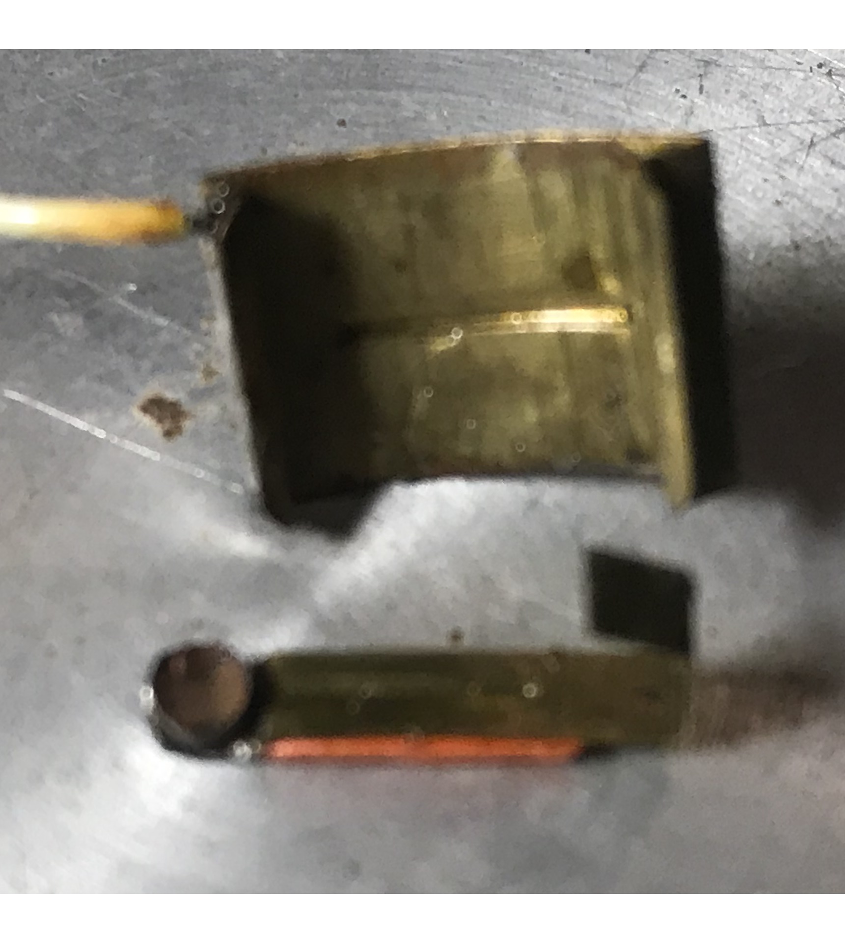

Got the amp working easy enough and sounds pretty decent- https://www.youtube.com/watch?v=bEtvu4ldFts but didn't have a lot of hope for the original motor after retensioning the brushes still not able to get continuity and the commutator looked burned, so decided to repower with a Mabuchi RC280 RC car motor, turns out these are just a purrfect 24MM diameter case and 2.0mm shaft size compared to the original-
The resulting speed achieved was ~22-1/2 RPM  Icon_sad so I thought about it for a day or two while I have been waiting for a couple other motor choices, ~$2-$3 free shipping from China!
But tonight I thought about ways to increase the speed with a sleeve over the motor shaft and picked a piece of PVC ~18ga wire insulation which got me close to the right speed, but adding a piece of shrink tubing over that made it just about the right speed at the top of the range  Icon_biggrin  https://www.youtube.com/watch?v=85gdEytzZac  The case cleaned up quite a bit with my favorite lanolin hand cleaner, a nice brush and a moist rag.
