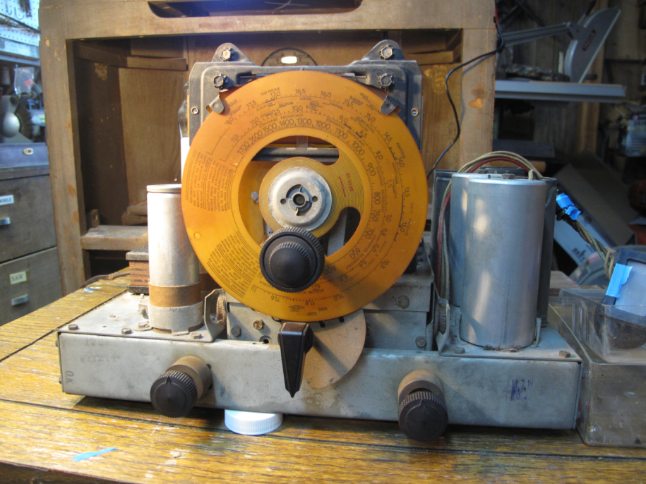

In my exploration I have found that the chassis is 95% original and a few repairs appear to have been made, perhaps in the 1950’s. Visual inspection showed no burnt, melted or otherwise damaged parts. All the capacitors appear to be original Philco brand save for one.
My initial test was to check for any shorts; this was done with a check of the windings of the transformer then a careful “power up” with a light bulb in series with the AC input. To my surprise nothing blew up or caught on fire!.  Local AM stations came in though faint. There was a 120 cycle hum (not unbearably loud but annoying.) The indicator lights were not functioning so I bought some new bulbs and repaired the light sockets for the dial and shadow meter.  I also purchased a tunable loop antenna (tecunAN-200) and, as the radio was in my 1929 one car garage, I made a local “earth ground” by tapping into an old 1 inch water pipe I could see thru a two inch crack in the concrete floor.
Next issue was to determine the antenna connections for the new loop; I finally decided to (after cleaning the terminals) to place the loop on terminal 1   with the jump connector tying in terminals 2 and 3. The shield wire from the tunable loop was placed on terminal two. My new “earth” ground wire went to terminal three.    I removed the chassis from the cabinet and placed it on a small table just behind the cabinet, in this way I could leave the speaker attached, the shadow meter was given a new front cover from the bottom of a frosted pill bottle and then placed in a plastic tray where I could see it. I placed tin foil around part of the bulb as the original metal casing around the bulb was missing. After lightly cleaning the chassis for dust and dirt, I was ready to test. (I am working on a 44 special bullet casing to make a new brass cover for the bulb.)
Surprise but the radio and shadow meter worked, at least partially. The shadow meter moves but not as “fine” as it should. On the band one the stations came in clear but mildly distorted. By adjusting the loop antenna dial I could get right onto the stations and they came in strongly. The radio dial was fairly accurate but not perfect. I could not find Big Jon and Sparkie L.  Bands two and three were dead except for 120 cycle hum.
The volume switch seemed to be working but had a few scratchy parts. The On Off switch for tone control was a different story. When the radio was turned on and in position one, the sound was very weak; in position two the sound was very bright; in position three the sound was bright; and in position four the sound was muffled. This told me that, if the tubes are not bad, then many capacitors will have to be replaced immediately.
The only non Philco part appears to be a replacement of Bakelite capacitor part # 54 &54A, the Bakelite double (3615-YU) had been replaced with a Philco Bakelite single capacitor (8326 SU) and an external “American Capacitor”  .3 (?) mF  in a cardboard box.    The tuning section may have been removed and worked on at one time as a wire from chassis (6JFG base) had been cut and then repaired, repaired with very old cloth electrical tape. The tuning section front section (for part #20 oscillator transformer) has what appears to be a replaced part as it is white while the others are brownish (aged?) in color. There is also a bend in the metal of the tuning box in one section.
My initial plan is to replace (restore) all the Bakelite capacitors and tubular paper capacitors with mylar film ones if feasible, however they would be replaced one by one and the radio tested after each replacement.  The aluminum can capacitors would be restored by opening the cans and using radial Mylar capacitors, if feasible. In that the aluminum can capacitors are primarily for the power supply, these should be the first to be restored. In that the tuning section will be the most difficult, this would be done last as the one section for broadcast band appears to be working correctly (why fix something that is working?). I would like to use capacitors that are between 20% to 30% over the originals and to have a WV of at least the original specification if not slightly higher.
My test equipment is very sparse at the moment. I have a digital multimeter and am attempting to restore an analog Triplett model 2400 (from 1946). My initial tests on the Triplett 2400, after replacing the leads with new wires and using a small 22 ½ volt battery, appear promising.  The 2400 was given to me and appears very clean inside, the ohms part is the only part I have tested so far. My Tek oscilloscope is currently not working and I may have to do without it for a while.

I have attached some pictures, I hope they make thru the web  . They are not great pictures but will give an idea about the chassis.

Replace the electrolytic caps first.
The order you suggest (replace-test-replace-test) for recapping is unnecessarily long.
You should replace all electrolytic and backelite block caps.
You do know (against better advice you powered the radio up; bad idea but now that you have the information would be even worse to waste it) the radio is working, meaning it probably has all critical parts in order. So, start replacing all those caps (except mica) until done. Then retest.
The resistors are only replaced if way out of tolerance. Else leave them be.
Welcome to the Forum. It sounds like you are well on your way. One caution for future radios that may save some hair pulling is to refrain from powering up a unit until the electrolytic caps are replaced. The dim bulb will guard against a short or defective power transformer but if the B+ is high it could damage other components when tubes conduct more than they should.
Like Bob said, start with the electrolytic caps, replacing them with aluminum electrolytic. They should fit inside the cans nicely. Then do the paper caps. The 2 on the primary of the power transformer should be Y2 safety caps. As you replace caps you can test resistors and replace the ones that are out of tolerance. I use 10%. Clean switches and controls next. The SW bands are usually not working because of the band switch or oscillator trouble. There's a lot of help here so go ahead and ask.

It’s ok to stuff the electrolytic cans with film capacitors.
M R Radios   C M Tubes
thankyou for the help. Can I replace the old electrolytic caps with mylar film ones? I will try again with photos
The two film caps run close to $40+shp. Didn't check the dimensions but may be too large in diameter the fit inside the can. Standard electrolytic are about $4...
...and there are some very good electrolytics that will last tens of years if picked well.
Check Tube Depot. They sell Solens and are much less than you quoted. Lots of guys here are using Solen film caps. I've generally had little problem fitting them inside the original cans. Use the 630 volt caps.
The last couple of restorations I have done I have used dipped film capacitors to stuff the electrolytic cans. Take a look here https://philcoradio.com/phorum/showthrea...685&page=2

I am starting to figure out GIMP, I know know about 1% of it. Attached is a bottom view of the chassis which I reduced to under 1 meg from an 8Meg file (after three attempts).

Thank you all for the advice. I decided to tackle the “canned” electrolytic Philco “condensers” first before anything else. I used the 1939 Philco catalog to get cross references.
Part #57 Philco 30-2024 8 mF 450V
Part #59,#59A Philco 30-2163 10&20 mF 450V
Part #24 Philco 30-2118 (substitute 30-2194) 16 mF 475V
I have since ordered and received from the Tube Depot :
Solen “fast “ 8.2 mF/630V for 30-2024
Solen “fast “ 10 mF/630V for 30-2163
Solen “fast “ 15 mF/630V for 30-2118
Solen “fast “ 22 mF/630V for 30-2163
I have successfully opened the 30-2024 but have not prepared it for re-stuffing yet. I marked it up ½ inch from the bottom and used a hose clamp cinched around it to act as a saw blade guide. The 8 mF Solen will fit in it.
The 30-2163 dual capacitor can I have not opened yet but I did, thru measuring, find that the diameter of the Solen 22mF is too large to go into the can. I was using the film Solen because I wanted to avoid mistakes in polarity but I now realize that I will have to go with an electrolytic rather than film in order to fit. Can anyone suggest a good brand capacitor that will fit?
The smaller non power supply capacitors I was thinking of using “orange drops” but I see that they are available in only radial, and not axial. Would that be an issue?
As for the x/y capacitors, is there any suggestion as to whether I should use an X, Y, or an X/Y? It is hard to tell from the schematic but I believe that the Philco part # 65 (3793-DG) (.014 mF double Bakelite ) would have a “line to ground “ , the ground being to the chassis and negative. Is that a correct assumption?
