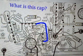

Anyone knows where it is located? The shematics has it in contact with C421 and R315 but those are at the opposite side of the chassis.
Alternatively, I have one non-identified 0.01mf cap touching R304, R307, R309, R310 and C308... Are they the same?

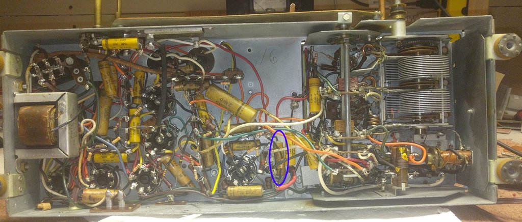

Hey Mars - I've attached a photo of the 2nd 47-1230 I did with C328 circled...this is after recapping (I restuffed them).  Check out my capacitor cross-reference which includes locations for all caps:  https://philcoradio.com/phorum/showthread.php?tid=19577
Rich
Hey Rich,
that is exactly where my mystery cap was.

See, that is where it gets fuzzy...
That terminal for this capacitor, also touches R304 and R307.
Now, on the schematics, I see that R304 touches C328, but not R307.
I see the same on the Sam's schematics. R307 and R315 aren't touching.
But, it would make sense that the one missing and the one extra cap of the same value are in fact the same...
-Mars

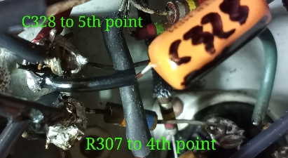

My documentation says that R307 (68k) should be connected from TS7-4 (not TS7-5, which is where C328 is connected) to 7R7-5.
Rich

I must say I didn't look up much the resistors, as I didn't change most of them; therefore, I relied on the parts placement drawings.
We know the parts placement drawing can very well be wrong, there's lots of errors in them...
Double checked in my radio, and for sure R307 doesn't touch the mystery cap, that I relabelled C328
