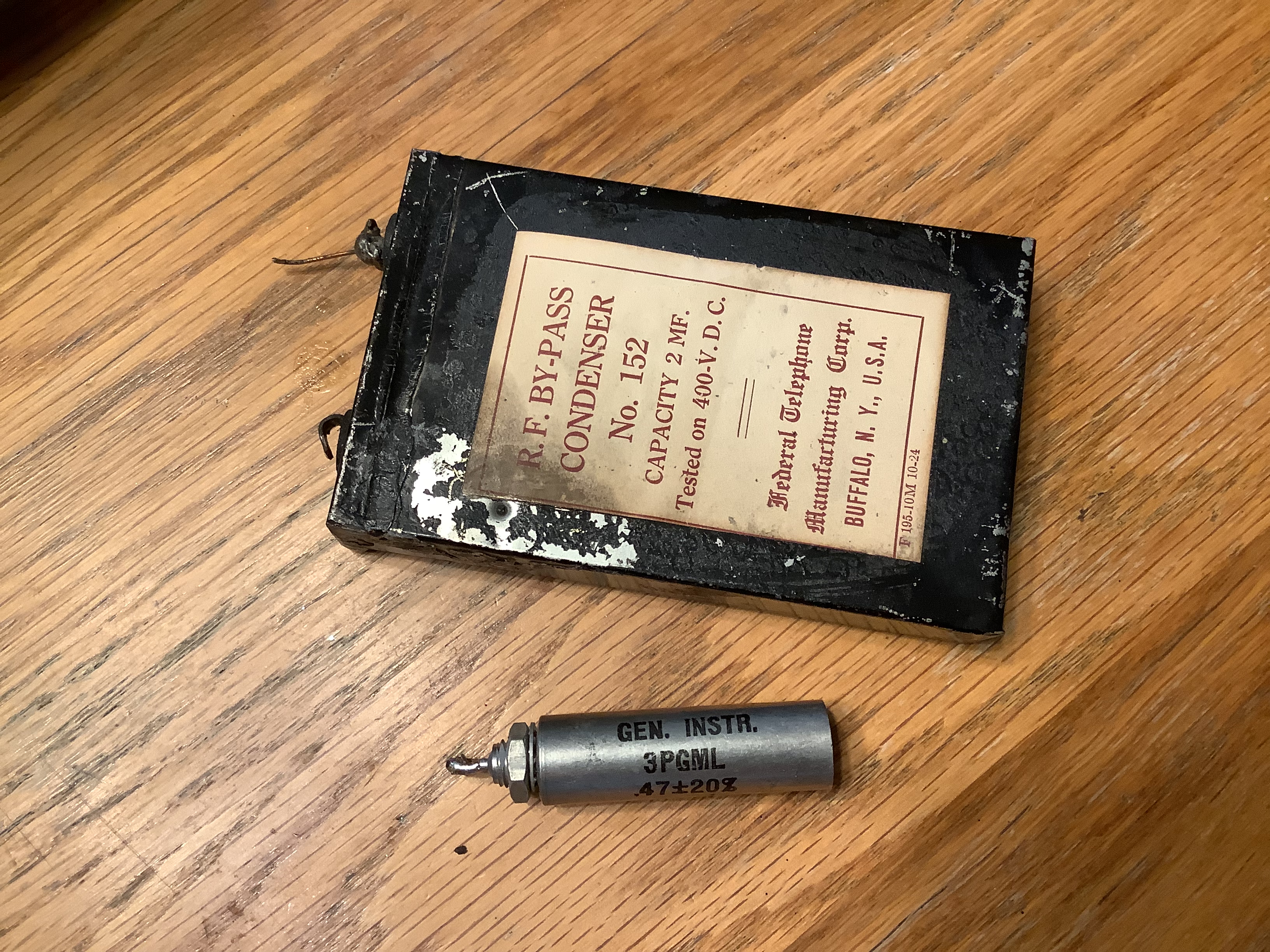

Hi Guys- I’d like to know something about these capacitors. Are either of them electrolytic? The older one has a 1924 date on the label. After replacing 4 of them in a kit built 1920s radio I’m getting reception but also a loud hum indicative of bad filter caps. Thoughts on either cap? Thanks. - Rob Q.
On the left seems to be electrolytic; on the right is probably a paper one.
Thanks. That’s what I was thinking. Another question for the Phorum is- “When did electrolytic caps come into general use?”.  ……….always one more question.

I believe both of the caps in your photo are paper. The cylindrical one appears to be a hermetically sealed oil filled cap, given the capacitance is only .47 uF, and is a lot newer than the other.

Well, the radio hints that neither of them is electrolytic.
And yes, as Ron had noticed, 0.47uF is not a value for an electrolytic of this size anyway.
