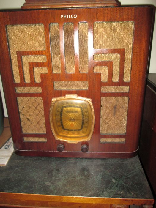

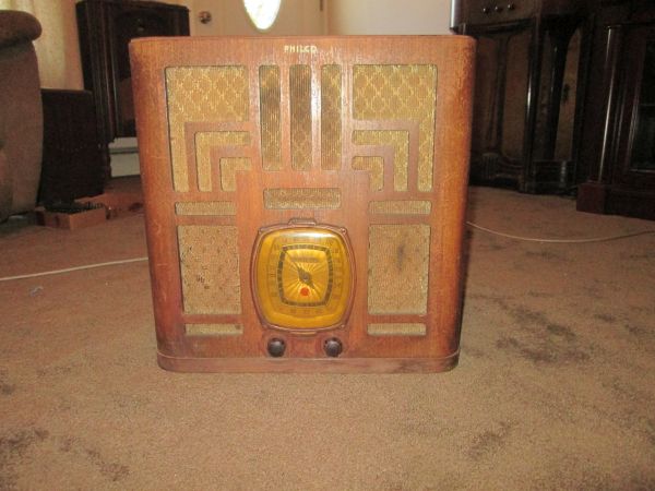

While I have been into Amateur Radio since 1957 and restored a number of vacuum tube ham gear, this is my first effort at a Philco. It will be used as a non working, static display at our small local museum.
My project is a Model 39-80 found in reasonably good condition. Needs a bit of attention to the veneer trim, grill cloth is pretty much gone and the glass or plastic is missing from the dial bezel.
The photo is the first cleanup of the cabinet with Gojo, not for sure where to go next ?
Always open to suggestions from anyone having experience with the 39-80, happy to hear from you.
Best wishes,
Charles
Welcome to the Phorum, Charles! I'm presuming that since this will be a static display you are not doing electronic restoration? Why can't it be a working example, that is, if you have the chassis? The cabinet is in fairly good shape for its' age. Just wondering... Take care and BE HEALTHY! Gary

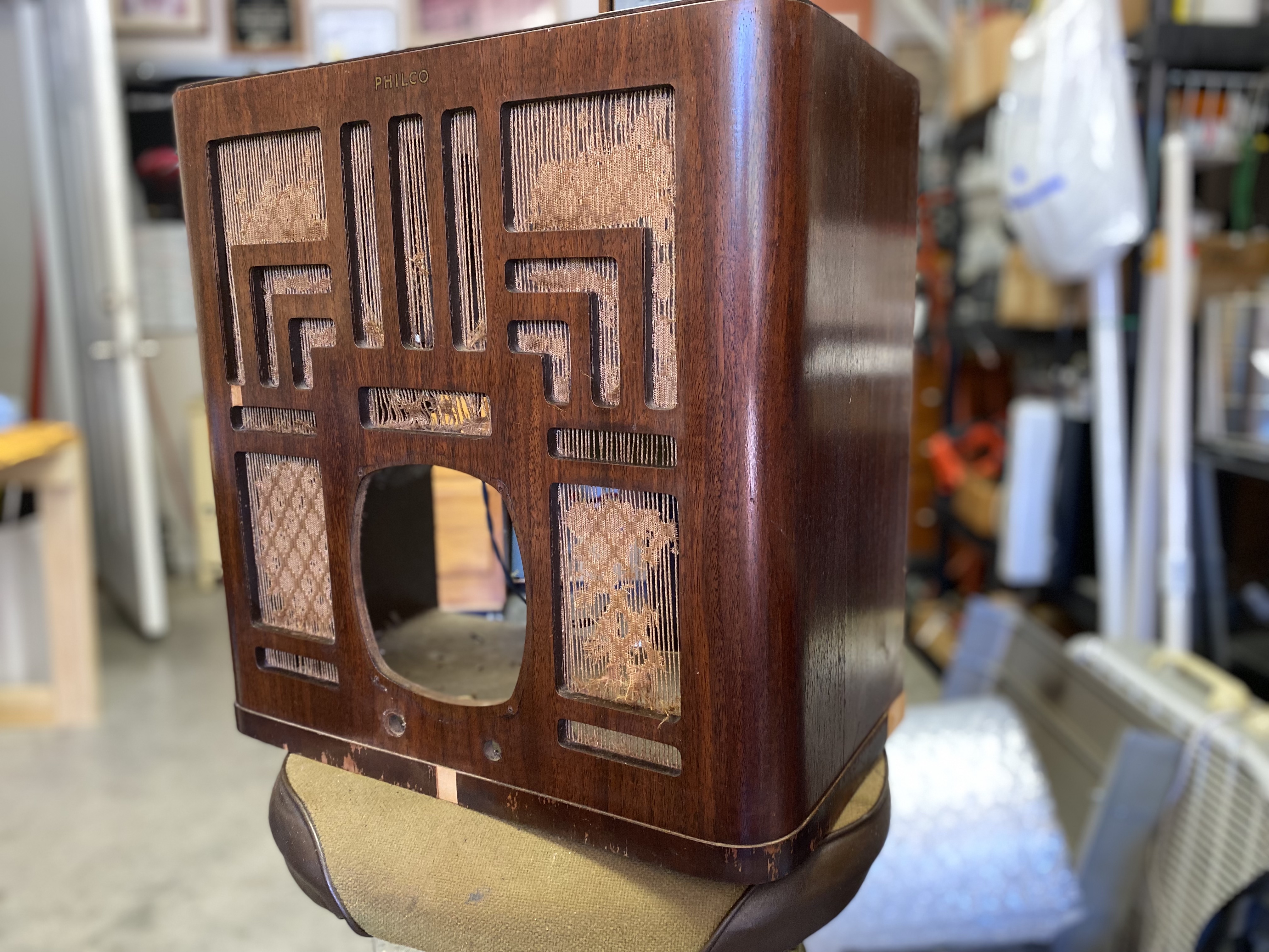

I've seen one of those sets. The grille cloth I don't think is in reproduction but you check w/ https://www.radiogrillecloth.com/ and see if he has any suggestions.
On the dial cover https://dialcover.com/ Mark is your guy. Send him the brass frame and he will install a new cover. It's plastic and has dinky rivets holding the cover in else you could just pop it in.

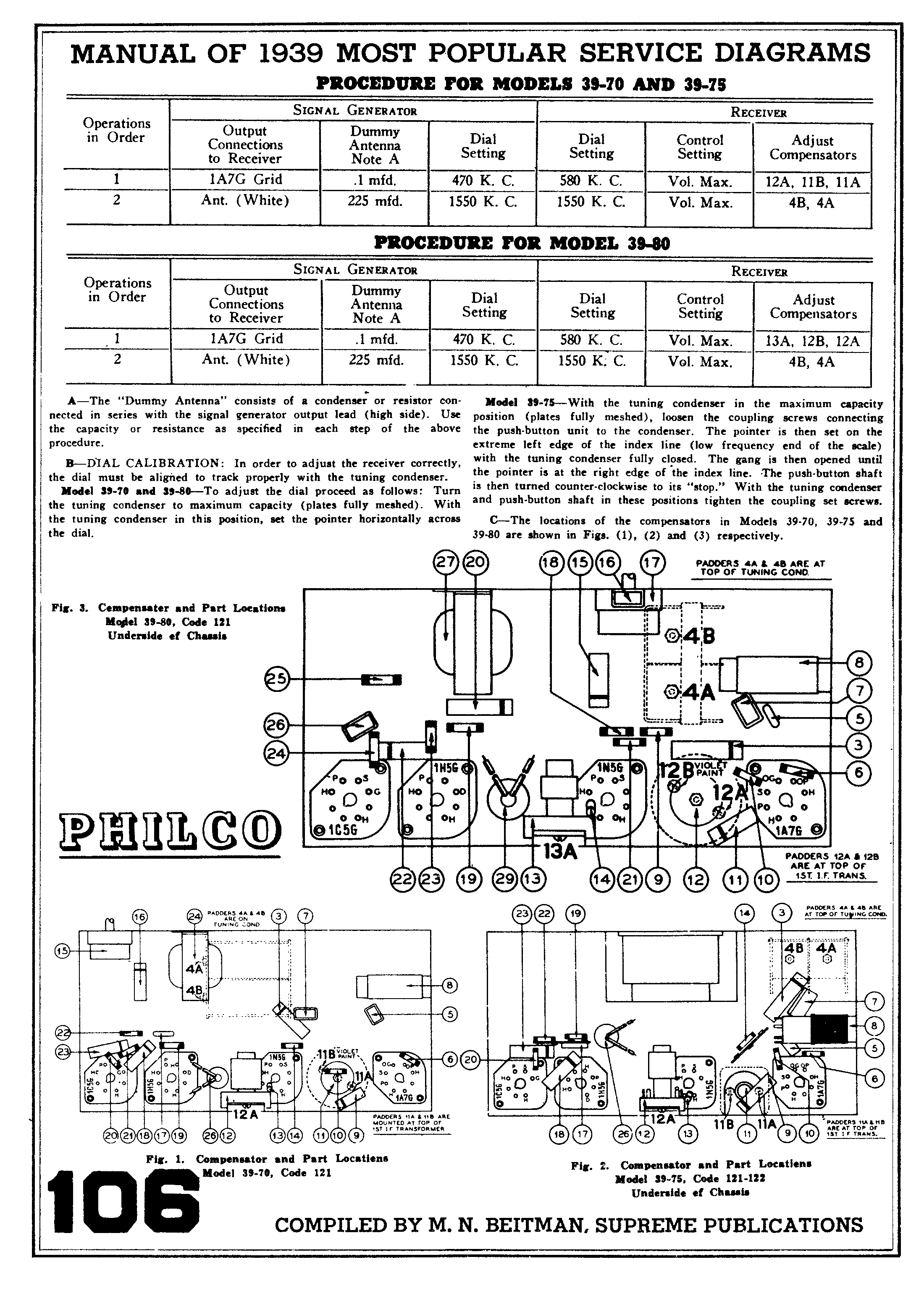

Here's a nice clean rendition of the service info for your set. https://philcoradio.com/library/download...%20308.pdf

Grill cloth ordered from Radio Grill Cloth and Dial Bezel will be in the mail today to Mark at Dial Cover.

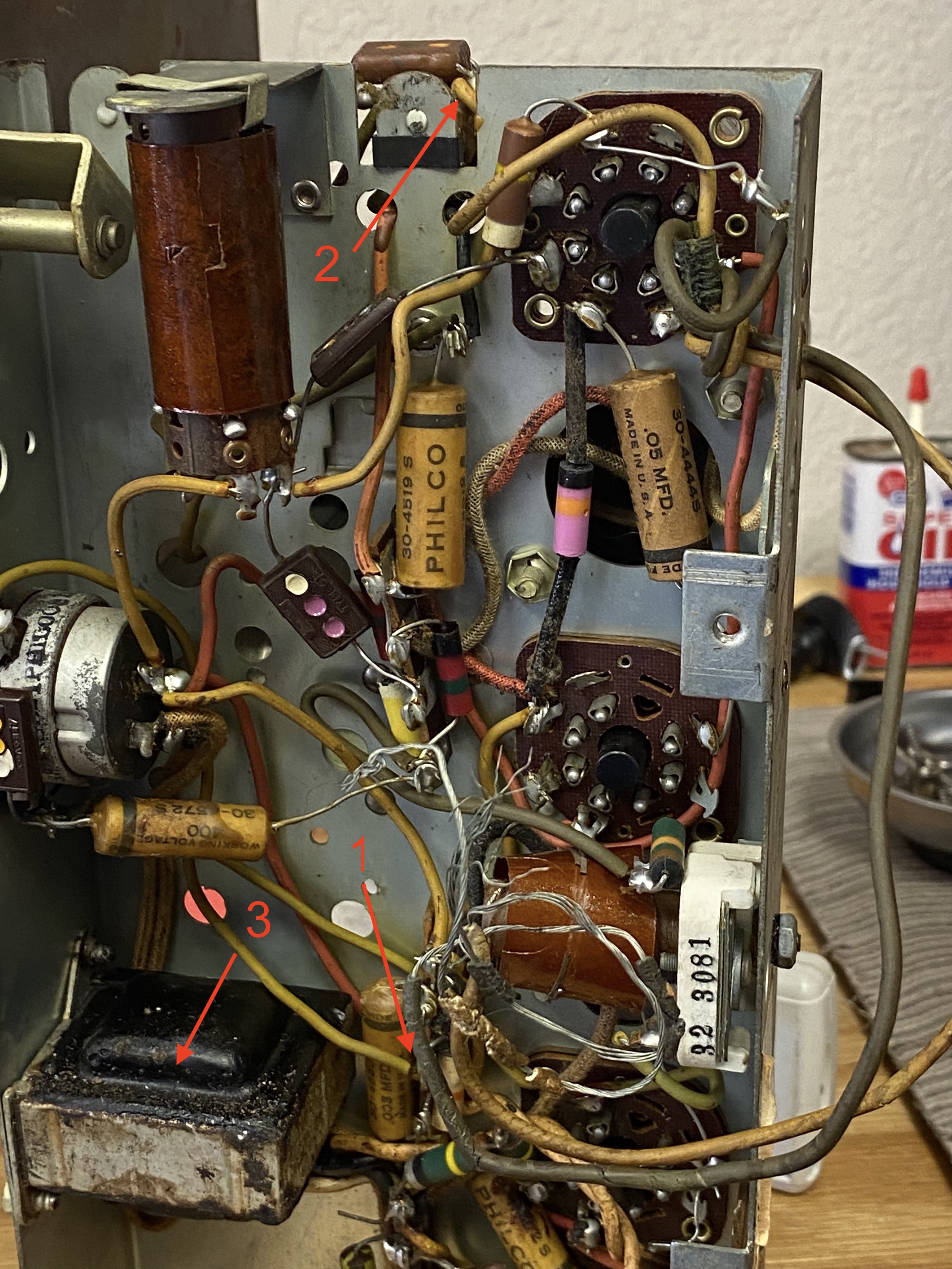

Three questions about this Philco 39-80, Chassis 121, see photo.
1. Two wires extending out side of the chassis was there originally an external antenna in the cabinet ?

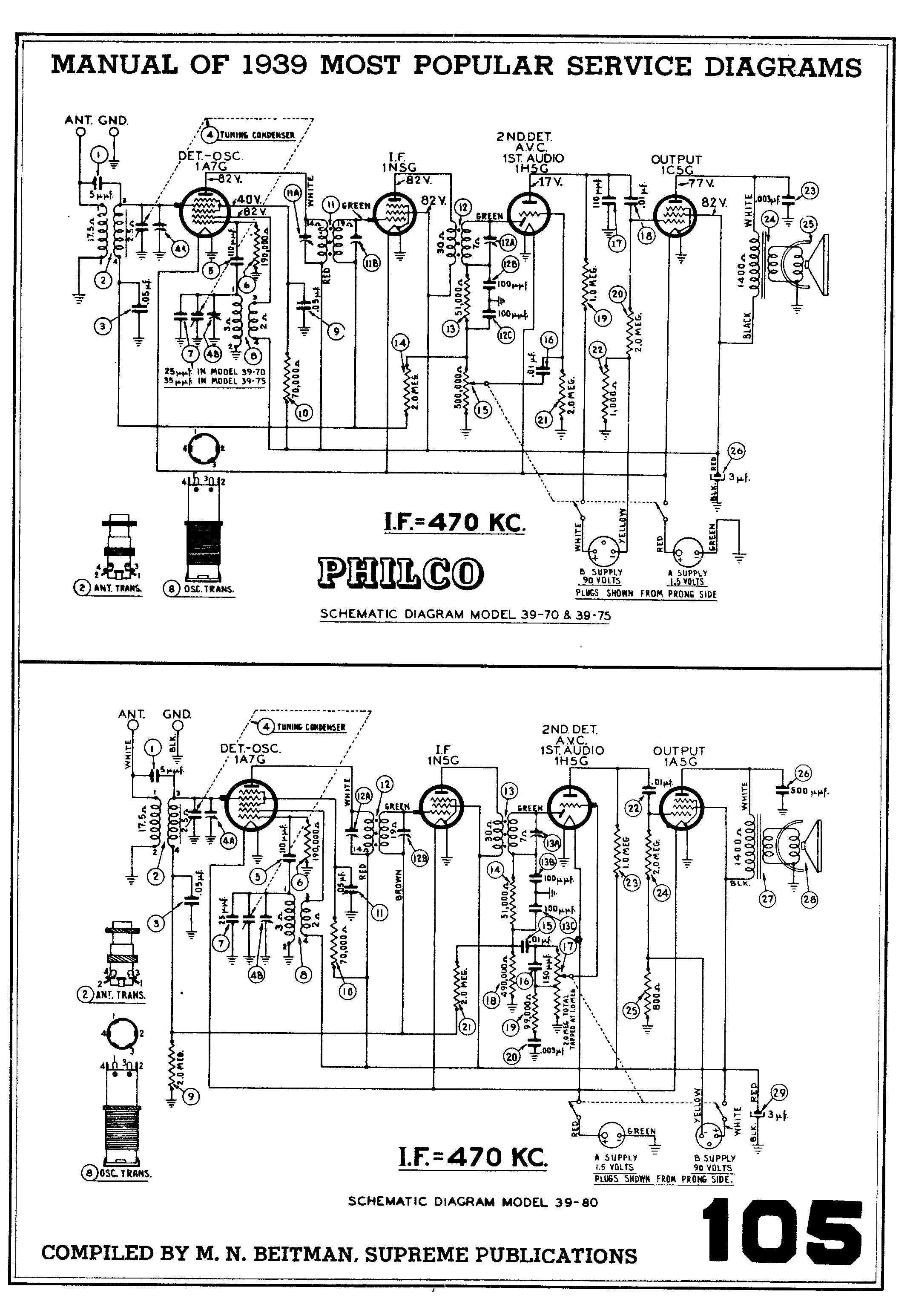

2. One wire appears to attach to the Antenna Coil at the Detector/Oscillator and the other to chassis ground ?
3. The audio output transformer appears overheated (have not measured it)?
Thanks
Charles
1 Generally Philco set didn't have loop ant till 1940 so it needs an external job. Also Philco sets from '39-'42 have rubber coated wire.
2 Yes
3 Now let me think about this. A hand full 9v batteries with about 4ma current flow is going to get the output transformer hot enough to melt tar off of it... [Image: https://philcoradio.com/phorum/images/sm...on_eek.gif]  No. It's probably from storage hot vs cold causing the tar to expand and contract.
I wouldn't be surprised if the primary was open. It's a pretty hiZ like 14K or so. That opt is the original one mine has a replacement from yrs ago.

Thanks Terry:
Was just curious where those two wires went originally, as I do not see any connection point for an antenna internal or external to the cabinet.
Good point, I did see on the schematics the 90 volt supply had a very low current, will ohm the transformer. The fellow I purchased the radio from said it had been in his "shed" for around 30 years.

Went to ohm the output transformer today, when I moved the wires, all of the insulation fell off of the primary and secondary leads !
All other wiring on the chassis appears to be in reasonably good condition, did note a resistor replacement had been made on the audio amplifier tube, with two 1 meg placed in series.
Also have to admit, had to look up on how to read the resistor codes on these oldies---LOL.
Also appears the audio output transformer may be driving a 5.5 ohm speaker ? So wondering if a replacement transformer with a high primary impedance and 8 ohm secondary would be close enough ?
