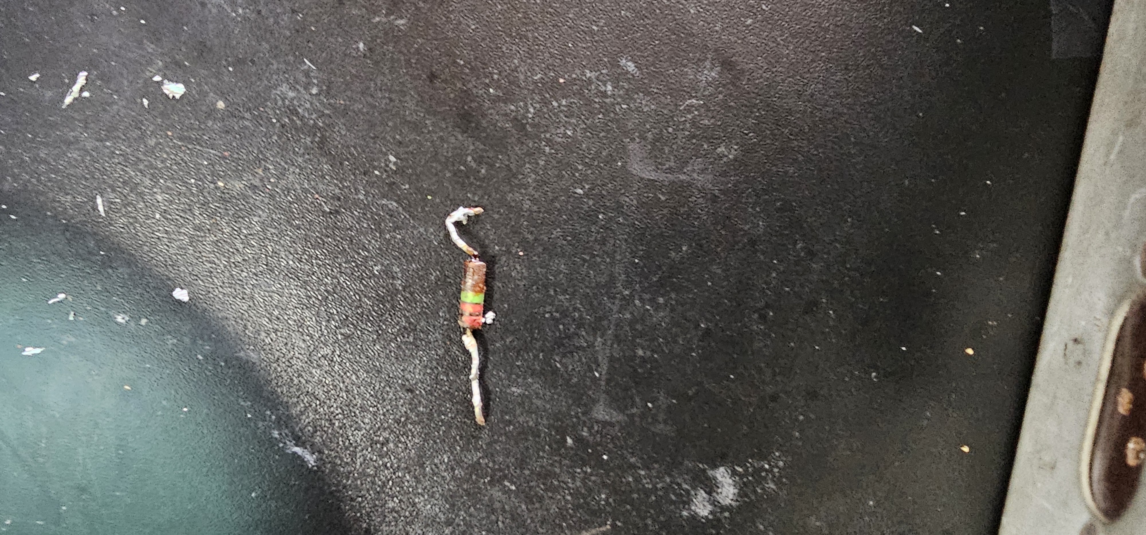

So far still no broadcast, I am posting pictures of #14 Oscillator and also a resistor #27 which connects to an XXL tube and the band switch. I am replacing the resistor and will give an update after replacement. Looking at the enlarged picture of the Oscillator I'm not sure if it may be bad.
#86
Please tell me this was it, I replaced resistor 27 and it's playing on the broadcast band. I am afraid to change the band Icon_biggrin but I probably should try the others.
It reminded me of having a tooth pulled, it was really tight between the 2 terminals.

What does the resistor measure? I think it should be 3.3 Meg.
If the oscillator coil has continuity and the resistance measures close to what the schematic shows then it should be OK.
#89
The resistor is a 2.2 Meg, it was the last one I hadn't replaced. The broadcast is coming in after replacing it.
