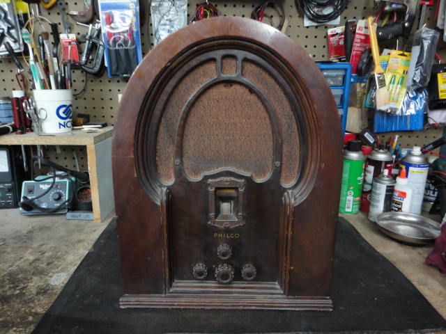

Well, it followed me home. It was on CL for 5 weeks at $140 OBO. The guy was quick to take my $100 offer. Code 123 chassis.
Doesnt look too bad at all. Im hoping I can save the original finish. It is intact, but has a good bit of age cracking on the top and sides. Maybe try some of the Shlagle Sauce ive heard about? Looks like the original cloth cord and plug-still in excellent condition.
Preliminary inspection shows a 36 tube with a broken off grid cap, and a power switch that isnt functioning. At least I hope its the power switch as I get open when checking the transformer primary resistance with a DVM.
We will see....

Turns out the reason I couldnt get a reading off the plug prongs was because one of the leads was broken off under the plug. Fixed that and get good resistance reading off the primary winding. The switch work too. Good to move forward.
I took the cabinet down and gave it one shot of GoJo. It amazes me how much crud that stuff takes off a cabinet. I dont see me refinishing this one.
That cabinet is in VERY acceptable condition! I would not refinish it either.

Finished this one up tonight. I ended up replacing the 1st IF trans and the shadow meter coil. Wish I had some better grill clothe (original is like the 90 uses), but this will do for now. Nice to be able to keep the original finish.
Very nice job! That is a beautiful radio. Give yourself a pat on the back.
