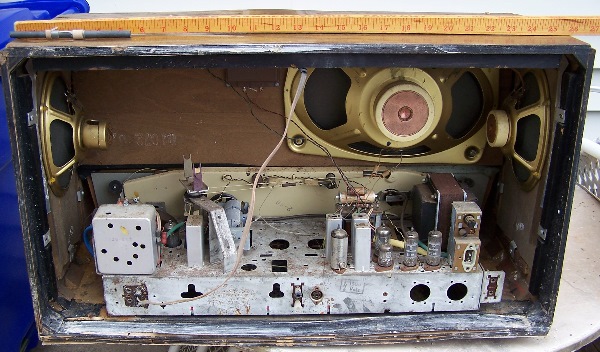

Took delivery today. The cabinet will need lots of work. Has had water drip on it I think. Bottom plywood has delaminated and the pretty top veneer is mostly loose. Glue injection coming up. Power cord was cut off.
The chassis has a little corrosion and a little rust. I've seen worse. Ferrite antenna has broken off the little connector wire but IS present. I don't see evidence of hot spots but don't know about the transformer yet.
Dial stringing looks like a headache. I've been told by Frank Karner it uses a separate string for BC tuning and a separate string for FM tuning. Has BC, 2 SW, and modern FM bands on the dial. Dial glass is nice and knobs and buttons appear pretty nice.

Since it's a 1957-58 model it will have at least some paper capacitors, probably the Ero brand kind with the black ends. Another thing to be aware of in Grundigs is the plastic they used in the bandswitch assembly in some of their sets, they used polystyrene which can be attacked by some solvents.
One of the things that many German sets are notorious for is the way they incorporated the power switch into the band switch assembly, so every time you turned the set on you had to select a band, which would wear out the contacts after being used several hundred times. The band switch assembly is also mounted horizontally, which means that any dust or other crap can collect in the band switch assembly.
I never understood why they mounted the ferrite bar antenna on a rotating assembly connected through pulleys and dial cord to a knob on the front panel. It seems like a needlessly complicated gimmick.

One shortwave band played tonight...for a little bit. Got several FM stations moving the tuner manually! Still no BC. Probably a grubby bandswitch I'm thinkin'. Time to test tubes and change some caps and resistors. Many of the resistors test right on the money or very close (in circuit).
I have repaired many European made sets and find the resistors are either right on within 5% or open, they never seem to drift. The paper caps are usually leaky and need replacing, the band switches, for reasons stated above, can be a bit of trouble. Sometimes the chassis's are very crowded and not to easy to work on, depends on how elaborate it is. The common thing amongst all of them is when working properly they sound really good.
