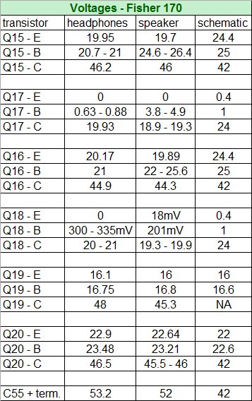

Here's the deal: On headphones, it plays well. But on speakers, it has a lot of distortion.
I made some voltage measurements. Looking at the chart below, notice that I measured voltage with headphones (second column) and with speakers (third column). The fourth column reflects voltages as listed on the schematic.
I measured all four output transistors, plus the two transistors in the power supply, as well as the positive terminal of main filer capacitor C55.
[Image: http://www.philcoradio.com/images/phorum..._chart.jpg]

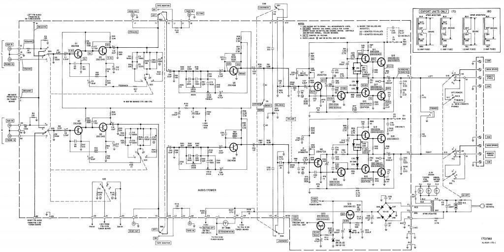

Here is the audio/power supply schematic. Click the thumbnail to be taken to another page, where you need to click the magnifying glass icon at lower right, then click it again, to see the schematic full size:
[Image: http://www.philcoradio.com/images/phorum..._schem.jpg]
If you look at the full size schematic, you will notice that in some places, two voltages are given. The higher voltages are for Model 180, a receiver that was a step up from the 170. The lower voltages are for the 170.

The sch is small on Photobucket, cannot blow up to read well.
Funny, it works for me - click the tiny thumbnail above and a new page should open in your broswer, with a schematic that is still too small to read.
Notice the magnifying glass icon in the lower right corner of that schematic.
Click it. Another schematic appears, still too small to read but with another magnifying glass icon in the lower right corner of the schematic.
Hover your mouse over this. The text "View Original" should appear.
Click the magnifying glass icon.
Suddenly, the schematic is huge...at least, it is for me.

Did work.
Too many nested zoom ins

OK, your EB volages on both transistor pairs, Esecially on q15-17, are screwed up big time. Should be 0.5 to o.7 V and you have almost 5V.
Strange. As if your speaker shorts the output.

Ron, have you tried connecting a scope to the output when the speakers are connected? It seems like the amp may be oscillating at an ultrasonic freq, which is screwing up the apparent voltage readings. Also you might try measuring voltages with an analog VOM, which is not so sensitive to possible HF AC signals.
As Morzh mentioned, with speakers connected the emitter to base readings on Q15 and Q17 do not make sense at all. This is what leads me to the possibility that you have large high freq signals present which may affect the readings of a DVM.

I remeasured voltages with the unit set to the AUX position, no input. Yes, the voltages are very stable that way. The voltages, comparing the transistors on the left channel to the transistors on the working right channel, pretty much correspond to one another. The only difference was found at one of the output transistors; the base of Q17 (left channel) reads 0.5 volts while the base of Q18 (right) reads 1.3 volts. The schematic calls for 1 volt. Both Q17 and Q18 measure 0 volts at the emitter - the schematic calls for 0.4 volts.
I re-uploaded the schematic to the server of this website, to make things easier:
http://www.philcoradio.com/images/Fisher_170_schem.jpg (964.9K)

There is no voltage at the emitter of Q17 because the transistor is not conducting and there is no current through R97. For Q17 to turn on there must be at least .6 V between base and emitter. Since you have only .5 V at the base, the transistor is not turned on and no current flows. Operating properly, with 1.0 V at the base, there will be .6 V across the BE junction, and the resulting current flow through R97 will produce the .4 V voltage drop across it.
What is the corresponding voltage across R95, Q15's emitter resistor? Also measure the voltage across R89, as there should also be about 1.0 V across this resistor to turn on Q15 and produce current flow.
The current through Q15 and Q17 should be equal, which will provide identical voltage drops across R97 and R95 .
Mondial
Thanks. I just went to the basement and made the measurements you asked for. Results:
0V across R95, 0.68V across R89.
Q15: E - 19.0V, C - 44.5V, B - 19.6V
Q17: E - 0V, C - 19.0V, B - 0.53V.
