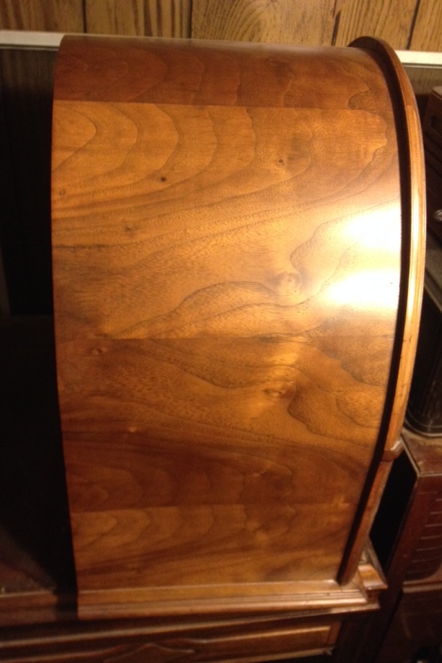

Jerry,
Both my 70's were/are original bookmatched veneered across the back, actually I have never seen an original 70 that wasn't bookmatched, both of mine are and all 3 90's I have owned in the past were also.
Not saying all 70/90's were, just the ones I have owned or seen have this type of veneer. I don't know what later or maybe earlier sets used but I know the one I'm working on had it to start with and I want to replace it as close to original as I can.
Original veneer, only refinished.
Tab, right and I'm wrong as usual! I was thinking of the few other Philco cathedral radios I have had and all were a single piece of veneer. Very nice touch.
Jerry
70's and 90's are the only ones I've seen like that and I've only seen maybe 7 in person, all the rest have been regular veneer. If I knew for sure my version came out with veneer like most other philco cathedrals I would defiantly use the paper back, it would be much easier to apply. I figured I already bought the veneer so (if I can figure out how to apply it) I may as well use it. Something else I've only seen once, I have an 80 jr that has bookmatched walnut on the front like older fancier cabinets. If I hadn't stripped the old finish off myself I would have thought someone applied it later.
