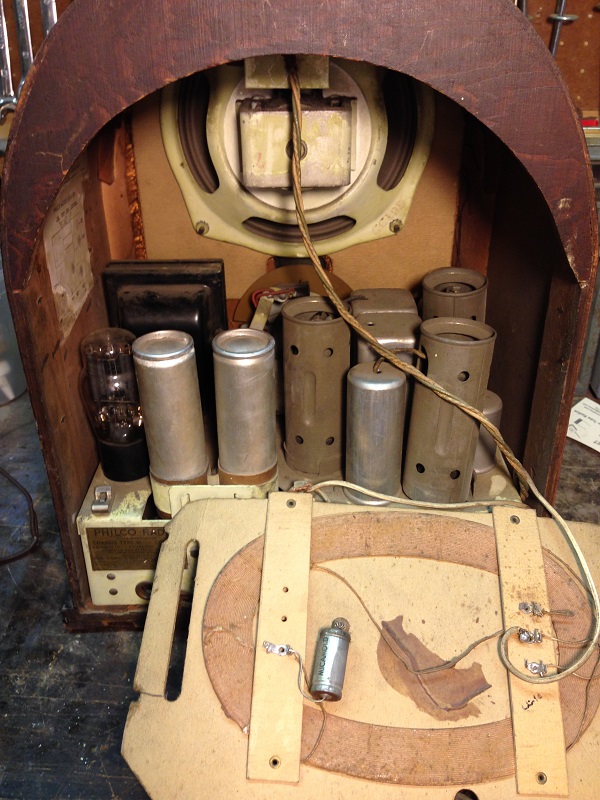

Quite the antenna job on this 60
I am going through the radios and I found this in my 60. From what I can tell, the guy took the back off a westinghouse radio and rigged it into the 60's antenna.
Not sure if it works but pretty cool thinking.
I wonder how well it works/worked... I keep wondering how well something like this would work with some of my tombstones.
Probably not very well. What you have is 60-80 feet of wire in a 1 ft space = a 1 ft wire. The 60 is not setup to use a loop.

I remembered seeing this in one of my old radio books, Radio For The Millions, Popular Science Publishing, 1943, on page 86... http://37.media.tumblr.com/58132522349bc...1_1280.jpg ... It may be of help to you. Sorry, exray, but, depending on how it is connected, it is a very effective type of antenna for local and medium distance reception, that is why it was used in so many sets of a later period.
Well Mike, a loop is a perfectly fine antenna when applied correctly. In practices later than the Model 60 the tuned loop replaces the on-chassis antenna coil and is tuned by the gang capacitor. That is what is suggested in the Radio for Millions article.
I'll pontificate a bit and say its awful hard to get decent tracking with this method. I tried my damndest to sub one for an antenna coil and although it 'worked' it didn't work satisfactorily. Two main gotchas are the cut of the tuning gang and the self-capacitance of the coil versus the loop.
The photo suggests that this is simply a loop from another radio connected to the antenna terminal. Not the same thing at all. In this sense its nothing more than a wad of wire.
There are ways to couple an ersatz loop to a 'random-wire' input but nothing shown suggests that such was done.
Its hard to see from the single photo, but I agree that this antenna does not appear to be wired in as a loop. I think I see only 1 wire on the back board.

To sub an ersatz loop into the Philco 60 would require disconnecting the original ant coil (which could be bad anyway) and not only subbing the AA5 loop to correct inductance at the high end of the trimmer range but adding a precise (unknown) amount of capacitance to get it to track.
Not to say it can't work but it hasn't been shown in this or any other random examples.
I would be very interested to know exactly how this loop is connected to the Philco. Unfortunately, OldRestorer didn't say. In the photos one really cannot see how it is hooked up, but I think I see 2 lighter colored wires there coming from it. I have seen too many of these odd things that actually WORKED over the years to pooh-pooh it before I know how it is connected; and, if it is logically connected, how it actually worked.
