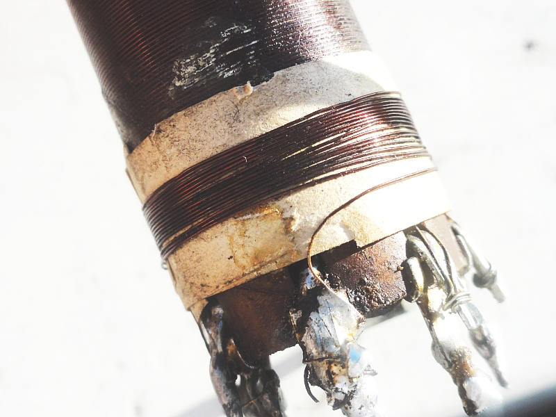

I have rewound about 5 osc coils already. I just pulled this one out, someone already has attempted a rewind. There's about 14 turns on the outer winding, I believe Ron says 18T of #38 wire.
Going to do the rewind and see what happens. I am deciphering the previous work, and it appears it may have been wound CW instead of CCW.
Would the set still work somewhat (it is sensitive, and sounds ok otherwise, except for the dropoff on the high end) if it was wound backwards?
Looking from the bottom, starting at terminal 3, it is wound CW going to term. 2. So I' am going to make it, right and a much cleaner rewind. I use old strips from photogaphic film as an insulator.

Success! The (outer) coil was rewound in the wrong direction. (See photo) Cruddy job they did, put the tape right over the original plastic insulator.
I not only have BC, but the SW band too. The lower part of the ant coil was open, so I did that one also.
What is really odd, some mentioned that the BC band would not receive at all, or the dial would be way off. Well, when it was backwards, the dial was very accurate, and except for the dropoff around 1300kc, seemed fine.
