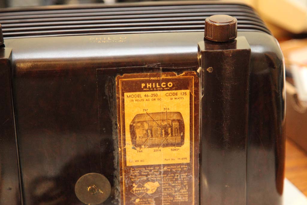

Philco Transitone 46-250 Code 125.
I bought this some 1-1/2 years ago during Kutztown auction.
Could not resist the $12 or so price (it was cheap).

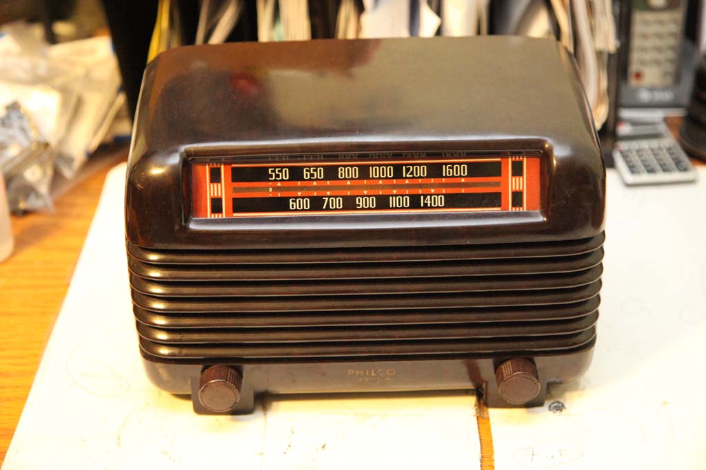

As you can see someone tended to it before - the chassis is hammer-painted.
The cabinet is just fine, the dial is like new (I do not think for 12 bucks I bought the radio with the new repro dial, but who knows).

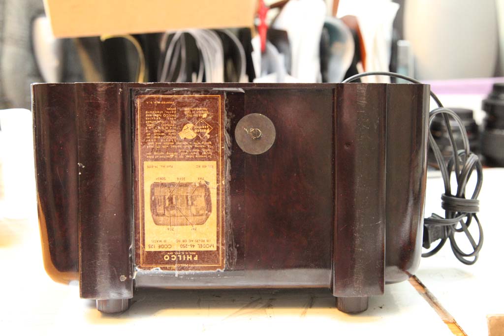

Thanks, I will shortly post pictures of the bottom and inside with screws.
One screw on the bottom.

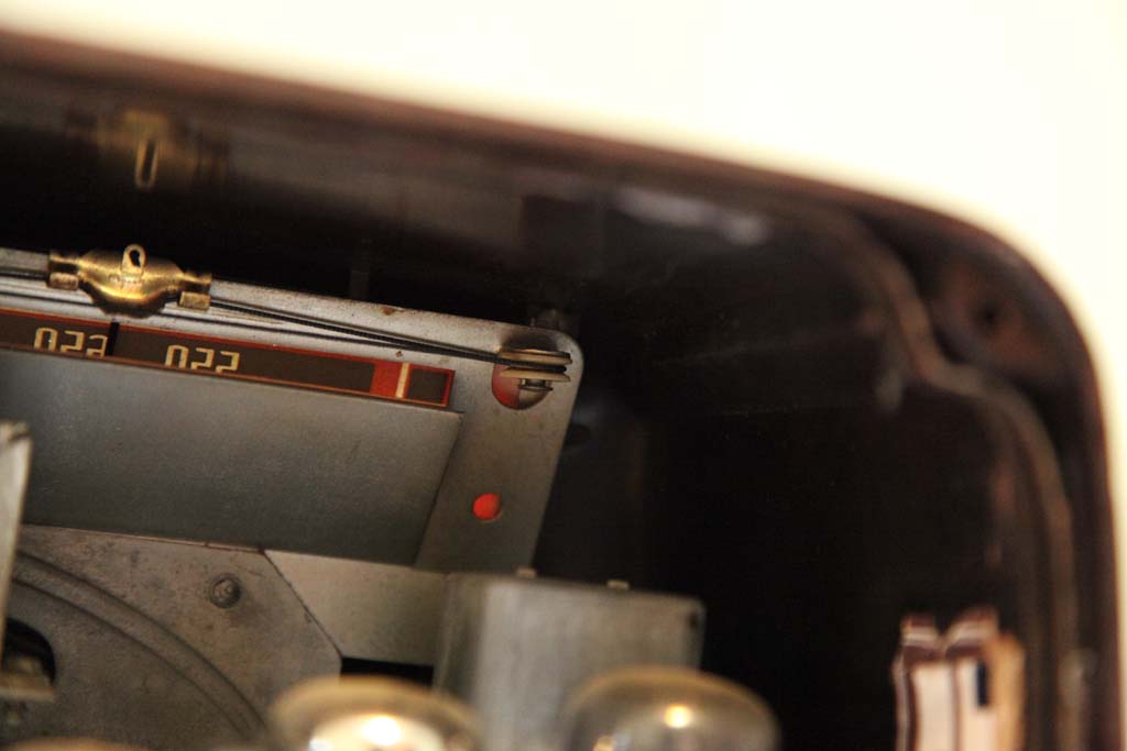

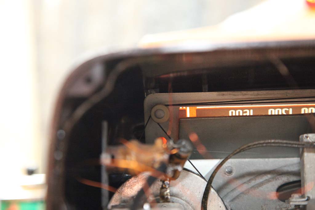

One screw at the right upper corner (look above the dial string roller)
Same at the left upper corner.
As you can see the vew of the screws is partial, and so is the access to them with scredriver.

don`t over think it .screws should just hold dial plate in just remove one screw

I have the same radio, Dial glass does not come out with the chassis. There are 2 tabs on the front of the chassis that insert into 2 slots in the cabinet to hold the front of the chassis secure.

So it one screw then and it will come out?
Posts: 411
Threads: 42
City: Ironton Ohio
Yes, just the one screw, knobs and antenna. You will see after the chassis is out the 4 screws that hold the dial glass to the cabinet, 2 screws on each side held in by 2 thin metal retaining bars.

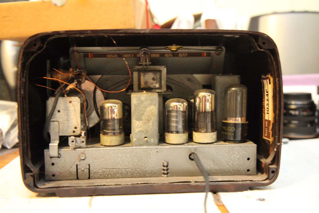

The chassis was repaired recently, with all caps replaced, lytics and film, with modern orange dip types.
The guy who did it obviously can solder, the rework is neat.
He left the antenna cap in a Philco tube, as it is on top and so is visible, it is probably restuffed as the tar is not what you see in originals, it is black and cracking a bit.
So, I will check it against the sch, and if it is OK, will try to power, and, should it work, give it the alignment.

One finding, the loop is not connected where it should.
That is, one side of it is, like it should, goes to tuning cap and Ctl grid of the mixer tube, but the other end is soldered to the external antenna lead connected to the antenna transformer, and not to the other transformer's coil's end. Which though makes the reception possible, disables AVC.
And the transformer seems fine.
PS. I only have code 121 sch whereas the chassis is code 125. Still I think this is wrong.
Found a couple of different prints both claiming being code 125.
One lists the rectifier 35Y4, Another - 35Z5, but the tube I have is 35Z3.
Checked the connection, seems to be correct for this tube.
The soldering on it is mostly neat, might be factory, the one that has been reworked is due to the caps change. So not sure if the tube is original or not.
The tube has no pilot lamp tap on the filament so the Candohm has a third pin (sch and photos of radios I see show 2-pin Candohm). The third pin is used to create that tap.
It clearly has been re-soldered. I think it is OK.
One sch that shows 35Z5 also shows 50L6 output tube (the one I have).
The sch showing 35Y4 shows 50B5 tube (the pins are different).
I think other than the antenna, the rest is fine.
