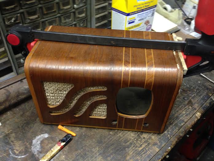

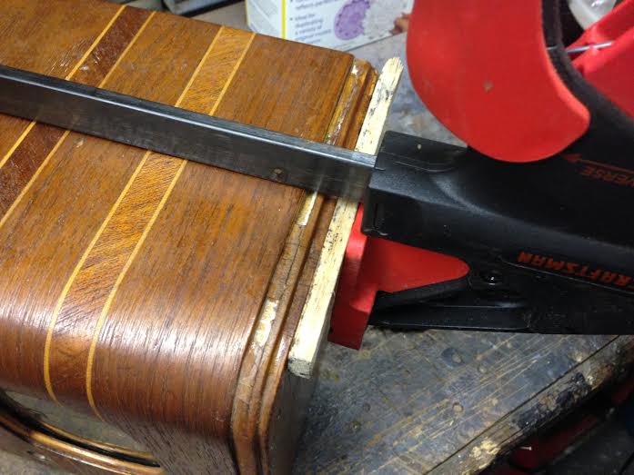

I have begun trying to repair the repair someone tried. Ugh I hate when they think glue without clamping is ok...
She will need new wood on the top side lip and then a new dial cover. I think Mike may have bought one though...
Did you Mike?
Here is the start. I have absolutely no time so it will be a long time between posts for the restoration.

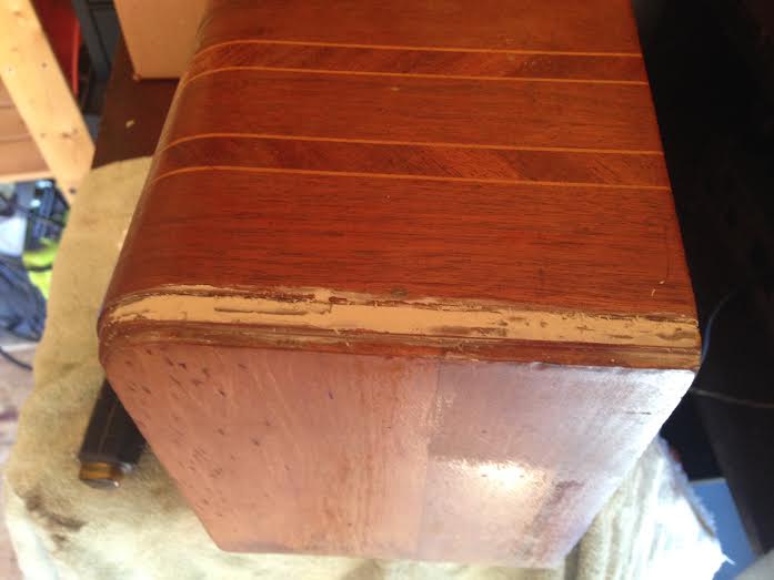

Working in all the missing chunks along the top sides of the radio. Someone poured glue in there and didnt do an actual repair or clamp it,,, Ugh..
Them laymen.....

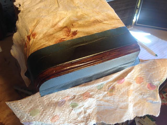

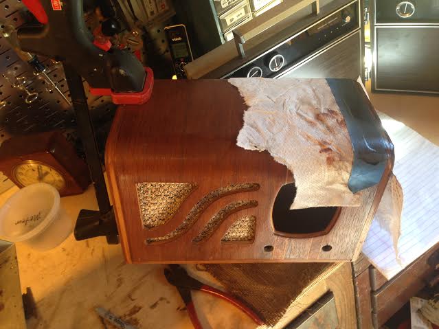

Veneer repair and matching test.
I have a box of ancient artist oil paints from my grandfather, and I myself am an antique, which even when just about dried out can come back to life with a couple of drops of unleaded, and fill in where needed or to augment a really rough project where rattle cans don't finish up properly. Don't do enough to fire up the compressor and deal with charging and then cleaning the sprayers like the old days when I'd wait until I had a driveway full of stuff to do. Anyway this is outdoors stuff only!

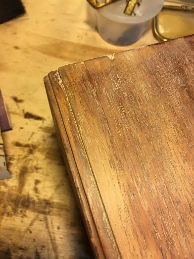

Took care of that nasty long veneer issue yesterday and leveled it out today.
Getting there!
