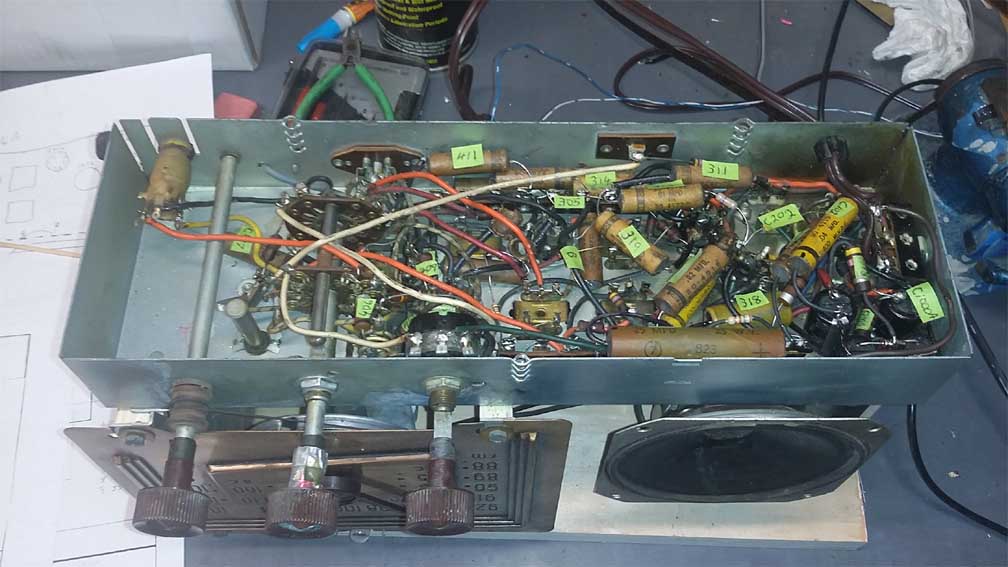

I finally got back to working on this one again. It has a pretty nasty hum in it that is affected by moving the 35C5. I have cleaned the pins and tightened the socket. I already replaced the weak rectifier tube and of cource the electrolytics. Also I have re-stuffed all the paper caps. The voltage is good now. I think I need a 35C5 tube. Any recommendations?  I looked on ebay but I thought I would ask here first before buying one.

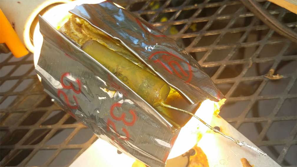

Oh and here's my first time capacitor cooker seen below. It's about 75 watts and only takes about 5-6 minutes. And does it stink! It's an outdoor activity only.

A faster way with tubular caps: simply heat one end at a time with a heatgun until it sweats (5-10 sec) and pull the wire with needlenose pliers.
Turn, repeat.
Back to this one again. So I have done the basics and replaced bad tubes no more hum. Now the radio works kinda. Even the fm works with poor sensitivity.
The question I have is on IF transformer Z302. The signal level is dropping from 4vpp to .04vpp through it yet it seems to tune OK. (measured with a X10 scope probe) From the drawings Z302 looks like it is a step up transformer.
The other IF transformer has a drop from 4vpp to .5vpp.
 Am I missing something here?

Upon further inspection and a different method of measuring I found that Z302 the input side has 4vpp and the output also has 4vpp.
I am still stumped as why there is such poor am reception. It seem there is not enough gain. and I don't know what is normal for this thing. I am tired of it for now I will work on it some more later.
