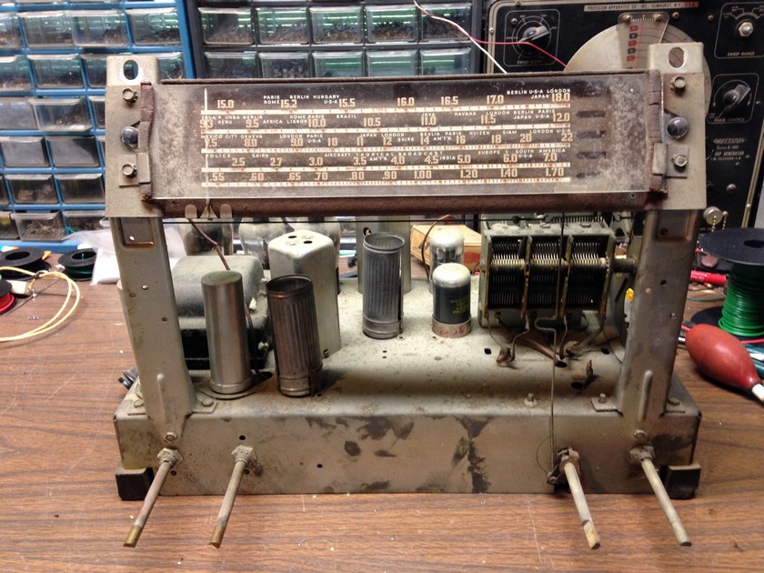

Here's how the chassis looks outside of the cabinet:
[Image: http://www.philcoradio.com/images/phorum...e00007.jpg]
It uses seven tubes and has five tuning bands - the standard AM band (540 to 1720 kc); SW from 2.3 to 7.5 and 7 to 22 mc; a fourth band covering the 31 and 25 meter bands (9.4 to 12 mc), and a fifth band covering the 19 and 16 meter bands (15 to 18 mc).

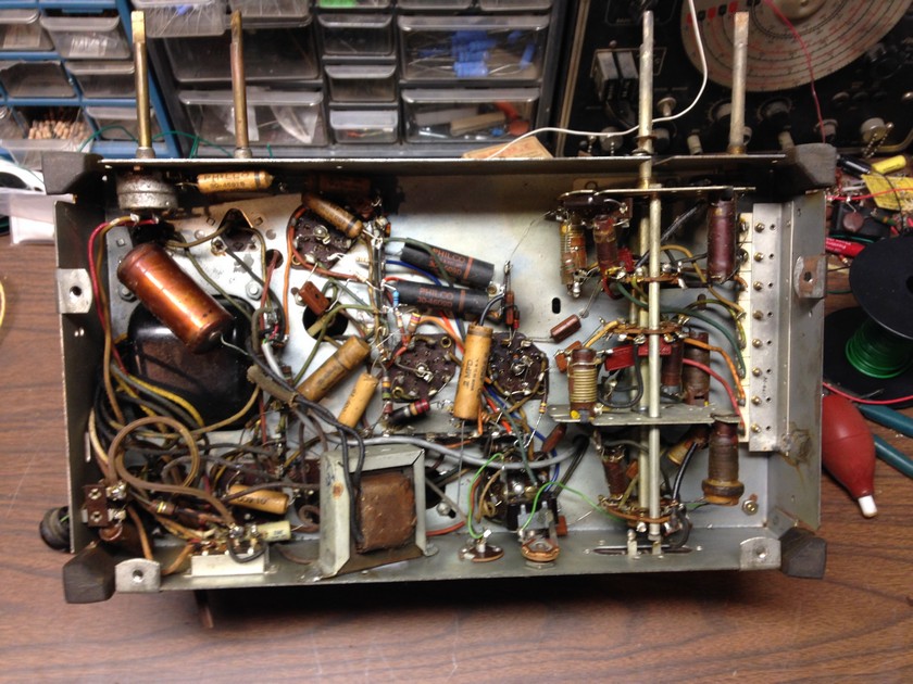

As usual, I started working on it before I remembered to take a "before" under-chassis shot.
[Image: http://www.philcoradio.com/images/phorum...e00006.jpg]
At this point, I have replaced three paper capacitors and four resistors, and also replaced a few rubber-covered wires. Can you tell which capacitors have been replaced?

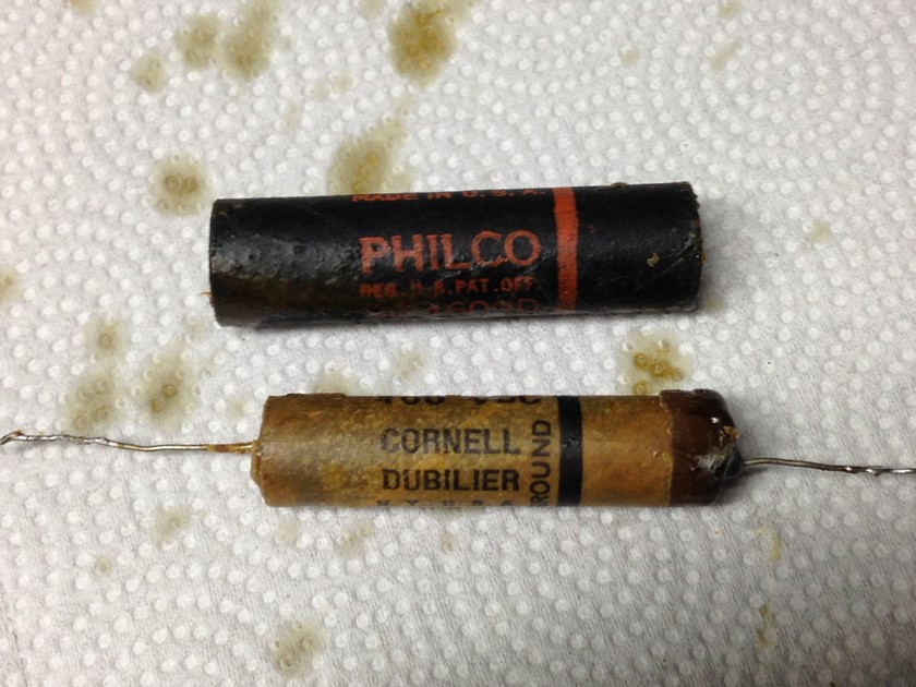

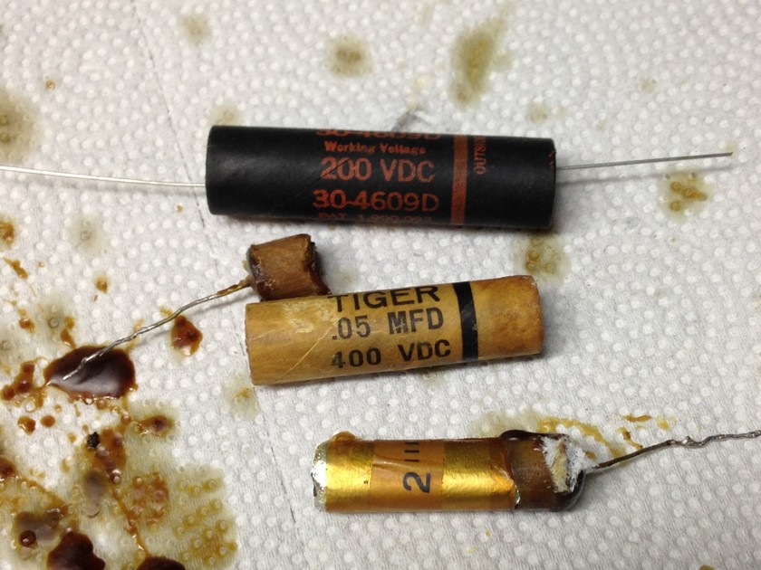

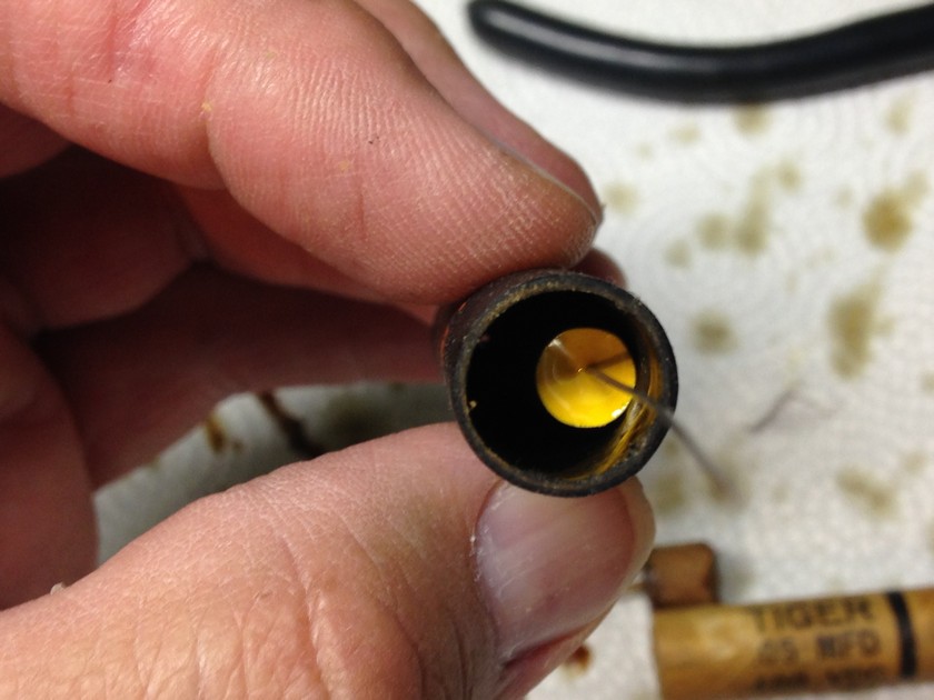

Look at the surprise I found when I removed the innards of the first one:
[Image: http://www.philcoradio.com/images/phorum...e00001.jpg]
[Image: http://www.philcoradio.com/images/phorum...e00005.jpg]
Philco actually stuffed a Cornell-Dubilier Tiger inside a Philco branded sleeve! Notice also how Philco rated this cap at 200 WVDC but the Tiger inside is actually rated at 400 WVDC.
It received a new yellow film cap rated at 630 WVDC.
[Image: http://www.philcoradio.com/images/phorum...e00004.jpg]
I sealed each end with hot glue, let it set up, and then reinstalled the new cap in the radio.
I also pulled the old paper cap out of the original C-D sleeve; I may need that sleeve for restuffing later on.

Ron,
Unless you tell me that you know for a fact that Philco rolled their own caps, I would theorize all their Philm (that is paper) caps were rebranded.
It is cheaper to buy in qty from a component manufacturer than to make your own.
As for can I tell...? the angle of the photo is such that I cannot see the ends. Otherwise I could try
The three largest caps in the middle of the chassis are the ones that have been restuffed (so far). Unlike the two black .05 uF caps, the 0.2 uF cap only had the actual part inside the outer sleeve - not another manufacturer's sleeve. (Although it was probably made by another manufacturer, please read on...)
And, yes, Mike...at one time, Philco did make their own capacitors. All of the caps inside those bakelite blocks that everyone loves to hate were all made by Philco. But after a 1938 strike, Philco began purchasing more and more parts from outside suppliers. You can read about it in the second to last paragraph on this page:
http://www.philcoradio.com/phorum/showth...?tid=15057

So...did you stuff the Tiger first and then stuff that into the Philco sleeve?
Lookin' good.
Posts: 16,582
Threads: 574
SO, 111 was the first Philco superhet....glad I got it.
(10-12-2014, 07:03 PM)klondike98 Wrote: So...did you stuff the Tiger first and then stuff that into the Philco sleeve?
Nope...
I only used the Philco outer sleeve. I did save the Tiger sleeve for possible future use.

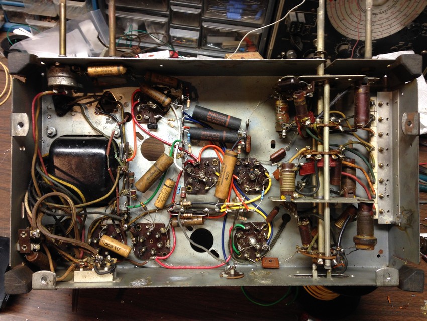

Today's progress:
[Image: http://www.philcoradio.com/images/phorum...0001-1.jpg]
I have replaced some more wires and a few more resistors. I have also replaced a couple mica caps and one more paper cap, with several to go.
Both IF transformers have now been removed so that they may receive new wires.
