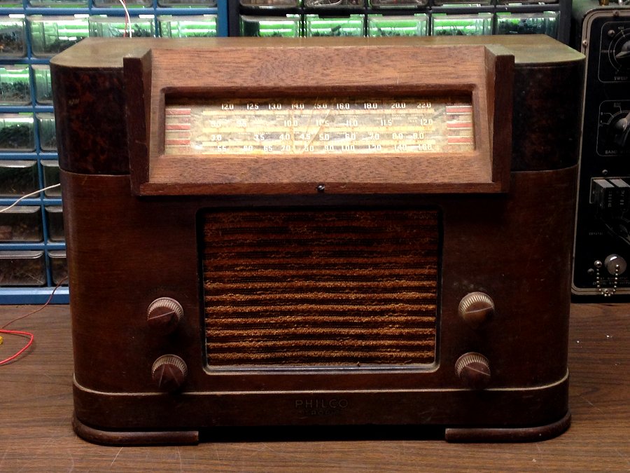

Here's my next case:
[Image: http://www.philcoradio.com/images/phorum...e00001.jpg]
That was a quick and dirty photo. Here's a better picture:
[Image: http://philcoradio.com/images/phorum/tro...720T-1.jpg]

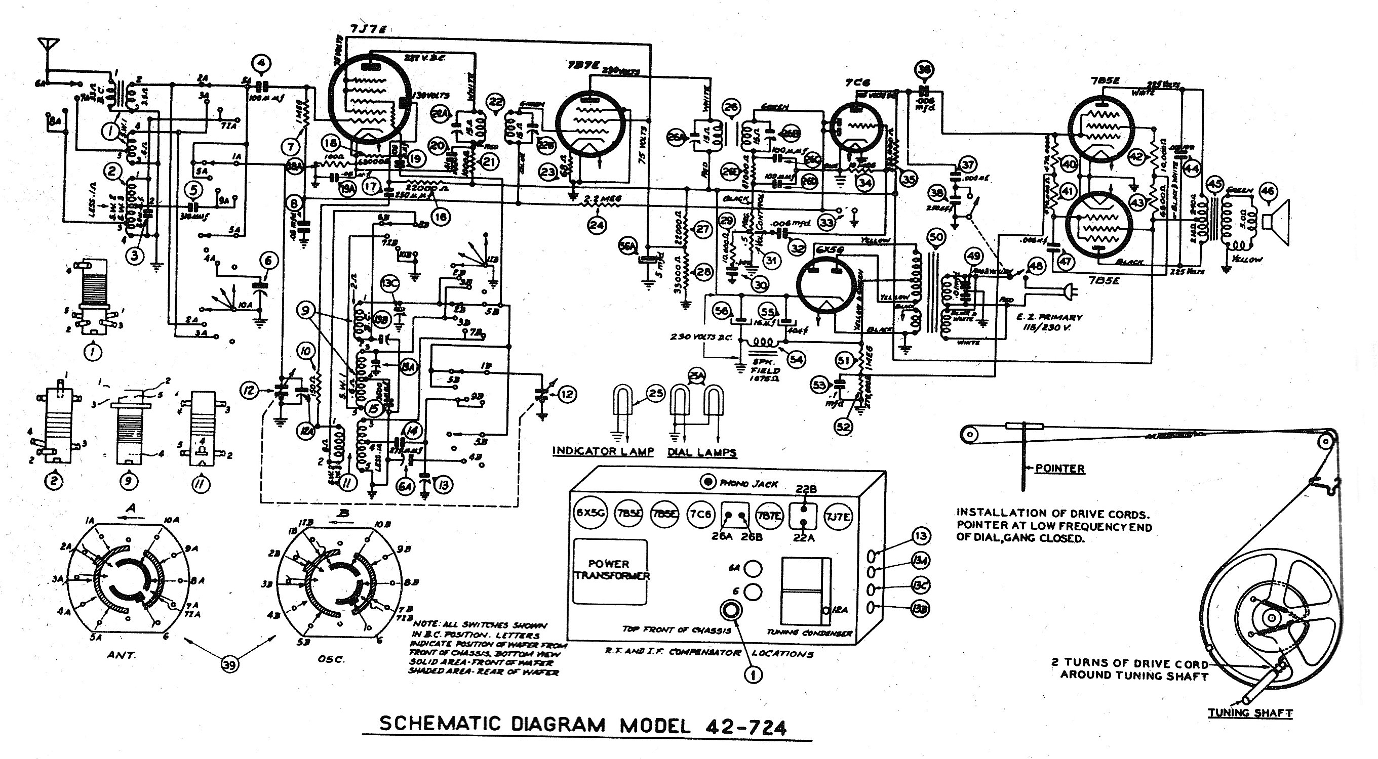

I could not find a schematic for the 42-720. The chassis, however, appears to be very similar (if not identical to) the 42-724.

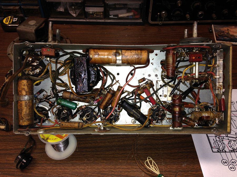

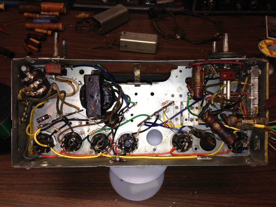

Let's take a look under the hood.
[Image: http://www.philcoradio.com/images/phorum...e00002.jpg]

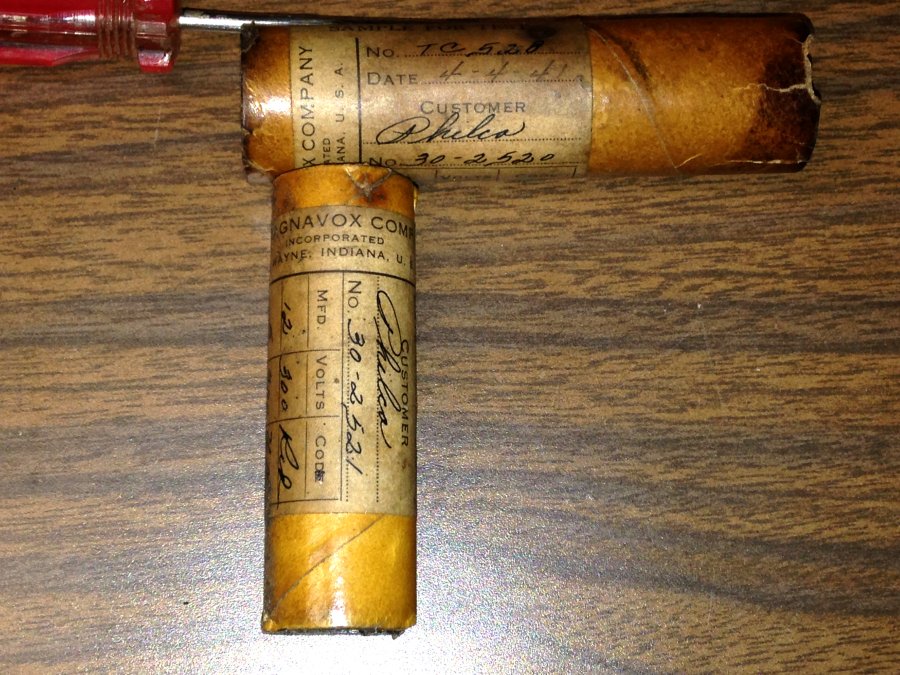

Did you notice the writing on the electrolytic caps?

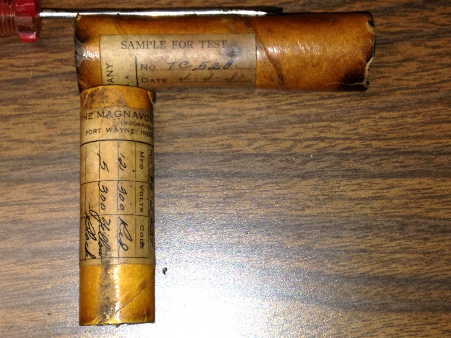

[Image: http://www.philcoradio.com/images/phorum...e00003.jpg]
[Image: http://www.philcoradio.com/images/phorum...e00004.jpg]
Production samples, made by Magnavox for Philco and dated 4/4/1941.

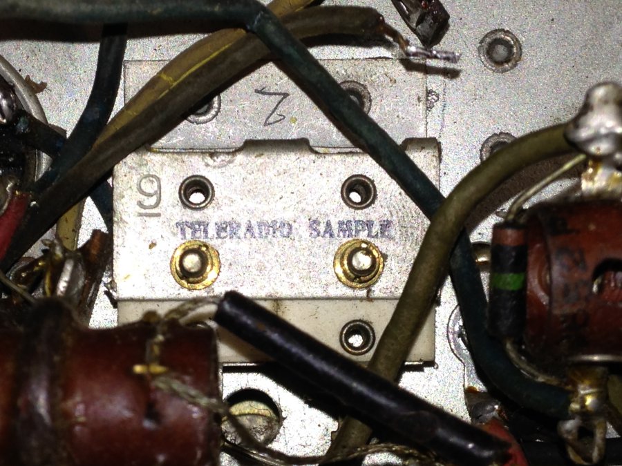

Another sample part - the two-section trimmer condenser which is just right of center in the under-chassis photo above:
[Image: http://www.philcoradio.com/images/phorum...e00005.jpg]
It is marked "TELERADIO SAMPLE".
I am wondering if this radio is a preproduction sample?
Well...if it were in better shape, I would just leave it alone and let it be a "shelf queen." But this radio was obviously used - and used a lot. The brown flocking on the backing plate behind the dial glass has turned black and is in bad shape; it will need to be reflocked.
Someone drilled a few holes in the side of the cabinet, for some strange reason.
The original Tenite escutcheon is gone, replaced by a wooden escutcheon that is OK but just not quite the same as an original. I can tell the wood escutcheon is much newer by the crude pieces of metal attached to the back that are holding the glass dial scale in place.
Worst of all...the glass dial scale is broken.  And it's one of those dial glasses that is painted on the front and back.

If you want to see the schematic of a 42-724, which appears to be identical to the 42-720, you can get a copy here (warning for those on slow connections: this file is 774 KB in size!).

[Image: http://www.philcoradio.com/images/phorum...e00006.jpg]
I had mentioned previously that I removed all of the paper and electrolytic caps yesterday. This made it easier to replace the rotten rubber-covered wires, and I have the vast majority of those replaced now.
As you can see in the photo above, I had to remove two of the coils from where they were mounted just to get to the wires and components soldered to the various pins of the 7J7E tube socket.
All but two of the resistors have been replaced. Both IF transformers have been removed so that they, too, may be rewired.

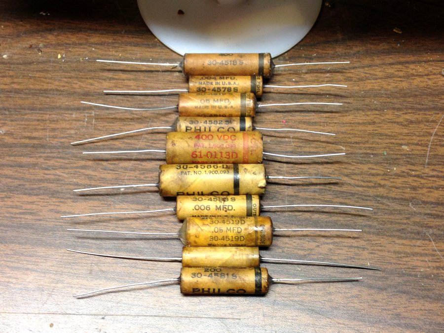

Paper capacitors, restuffed, sealed with hot glue and ready to reinstall in the radio:
[Image: http://www.philcoradio.com/images/phorum...g00007.jpg]
I will have to purchase some of those Nichicon CS series electrolytics - the electrolytic caps I have on hand are too large to fit in the original paper sleeves.

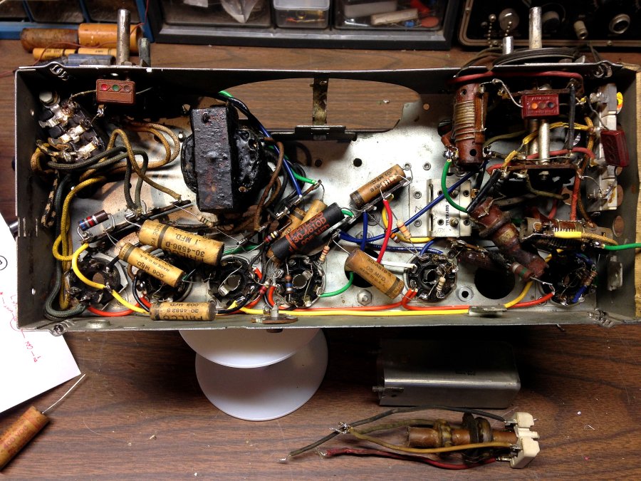

All paper caps that go under the chassis are now in place.
1st IF transformer has been reinstalled.
Coils are back where they belong.
Bad news: I turned the chassis right side up and noticed, for the first time, that a winding on the antenna coil appeared to be burned. I did a resistance check and, sure enough - that one winding is open.  I am hoping I can rewind it. It is the primary winding for the AM band, so (hopefully) it won't be too difficult.
