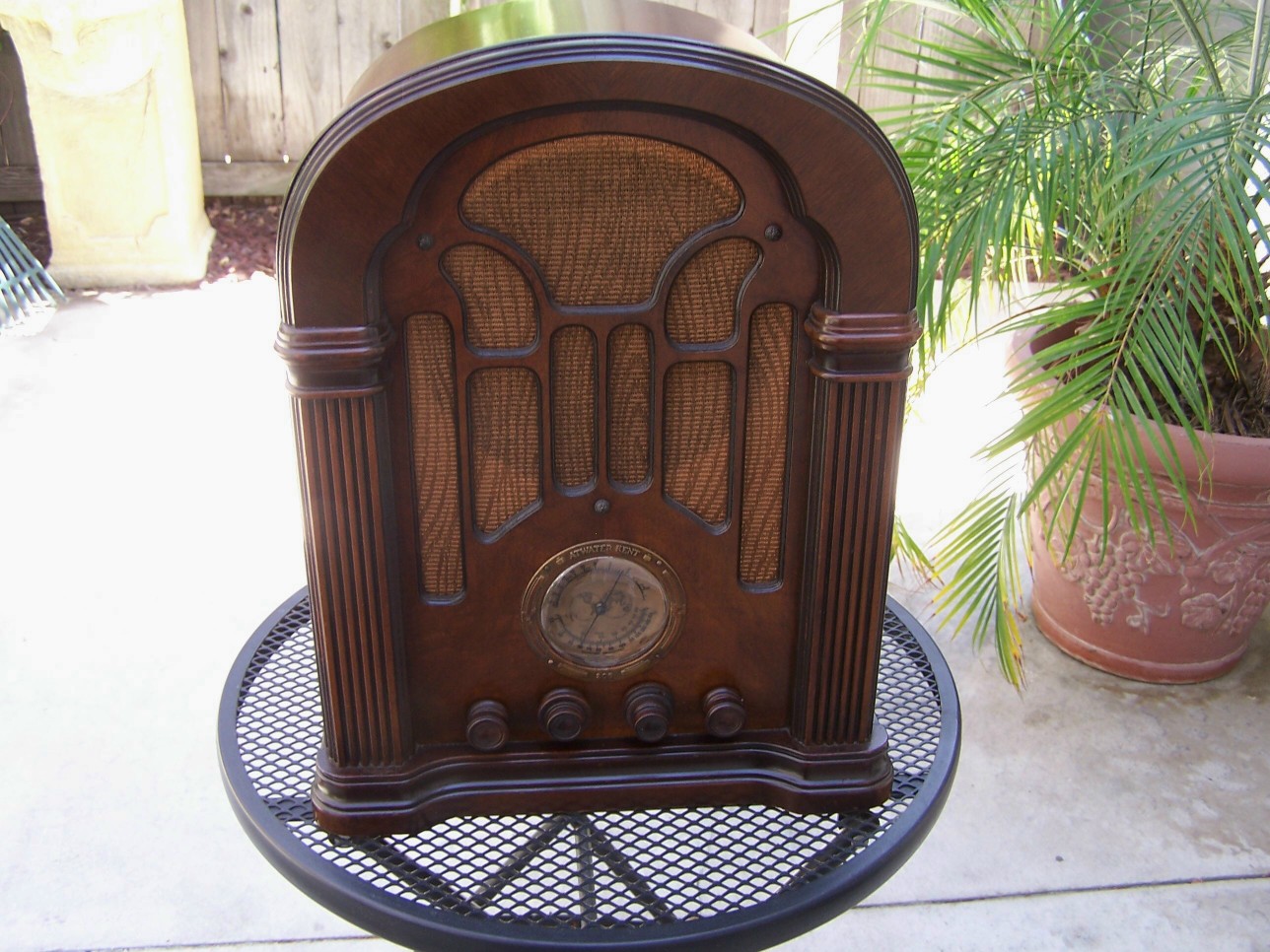

So, it's finally done. Kept the cabinet original, so the chassis this time is not that "brand new' shiny to match the exterior appearance. All wiring has been completely replaced, with correct color, good and bad for a good measure (mostly bad). Re-stuffed paper caps. Self made dial lens.E-cap has a seam,drives me nuts, but it will eventually go away (the nuts, the seam will remain). Really great reception on SW.

Looks really nice and very original.
If you want to avoid the seam on the electrolytic, next time cut the can right under where the top cap is crimped on. You can then restuff the cap and then epoxy the cap back on. If you are careful, you cannot tell that the cap was restuffed, even if you examine it closely.

You did a good job fields 100. That is a nice style radio. I think I like the unshiny look of your chassis, it is still very clean looking.
Was the dial lens hard to make?

Thanks.With the lens it came out OK from the second attempt. The first piece of plastic was rigid no matter how much heat was applied. The second was pretty flexible with a heat gun. I made primitive form  and it came out half way decent. Had to thin the sides with a file to make snug fit and polish the whole thing on the wheel prior to assembly.
Looks fantastic! The restoration looks very original. Your dial lens looks great. I ordered one for mine as I had no idea on how to make one. Very nice Icon_thumbup
Did you have to make the dial pointer?
No, I didn't.
The pointer is from a different set. The AK pointer on the 206 is wire thin, but is held on with a screw like your pointer is.

Thanks.I also was thinking of ordering one.Then I remembered that some long time ago I've been  making cockpits for the model planes and tried  the same method.   Was not hard at all. Not sure about correct curvature as I did not have the original one to compare.

The picture just fine.Looks like a small hub with 2 wires painted black. Will post photo of the coming masterpiece.
Thanks.
I was going to mention the pointer to you as it isn't the proper one but didn't want to be a wet blanket. You are also missing a couple of white on black labels, one on the chassis and one on the IF can . If you want to be picky. You do have a nice shield for the 2A6 tube. most of the one I've were missing or falling apart.
